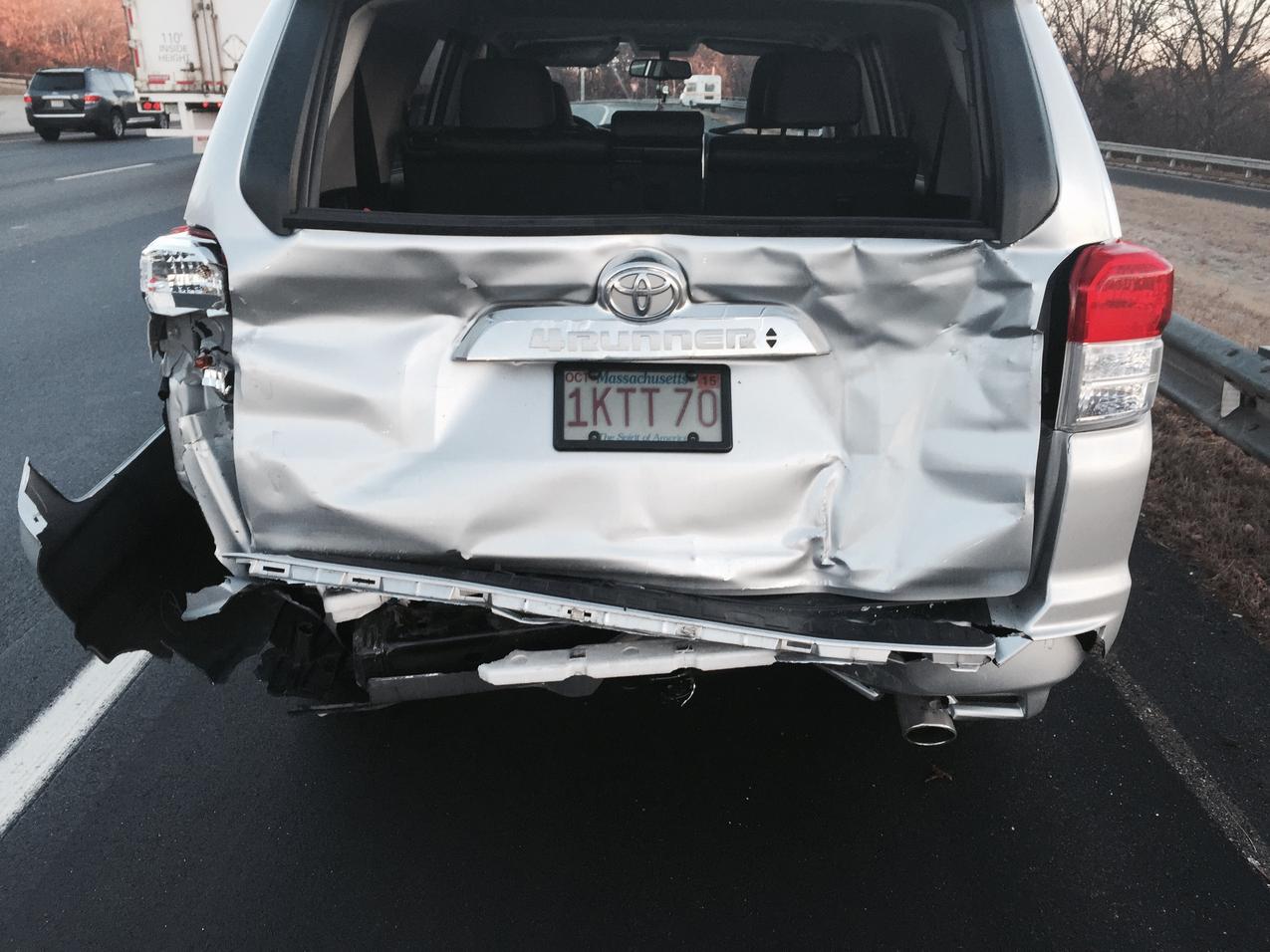

Hey everyone I was wondering if you could help me out ?
On Monday at approximately 7am on the highway I was traveling in the high speed lane and the traffic started to slow down (heavy volume) a guy in a Ford 150 was coming up fast and I knew he wasn't going to stop so I cut the wheel and bam impact sent me all the way across the highway (four lanes) almost into the break down lane I got jolted but otherwise okay but my Runner did not fair so well I have attached pictures my question is do you think the frame is bent ?
The hitch is under the truck somewhere the back window blew out and the bezel around the controls for the heat popped off I was hit hard ,
The insurance company wants to fix it (about 9K) but I do not want the truck back it is a 2011 limited with 23,000 miles on it , this will be on the Carfax report as a major accident and I will loose money if I was to trade it in which I don't think is fair ....could you please offer up any suggestions please I love this truck but afraid the structural integrity is now comprimised !!
Impossible to tell by the picture you've posted. If you could get any pic's looking up toward where the spare tire is then I could possibly tell if the frame is bent.
Its not a terrible thing to see an accident on a car fax. As long as the repair work is done properly the car is just as good as any other vehicle. If the frame is bent then the insurance company would certainly total out the vehicle most cases anyway. I just purchased an Acura TSX that had like 3 front end collisions reported as minor accidents. I couldn't tell what had been replaced, repainted, or damaged. Even took the front clip off to investigate couldn't tell a darn thing other an the front grill had a bolt hole cracked not securing properly. The car runs and drives great.. Its more a stigma thing "oh god this cars been wrecked I can't own a wrecked vehicle"..... a 4runner's a 4runner..

judging by that picture alone I would have to guess the frame is bent to some degree. the hitch bent up and in several inches. I cannot imagine the hitch could twist that bad and not damage the frame.

If I'm not mistaken, that black bar inside the bumper cover there IS the back end of the frame and it is twisted at a pretty extreme angle.
The amount of cosmetic damage seems rather light for the accident and fixable. But that back bar that the hitch is attached to is the back of the frame and would likely have to be cut off and a new one rewelded back on. Not sure you could or should bend it back from that angle...

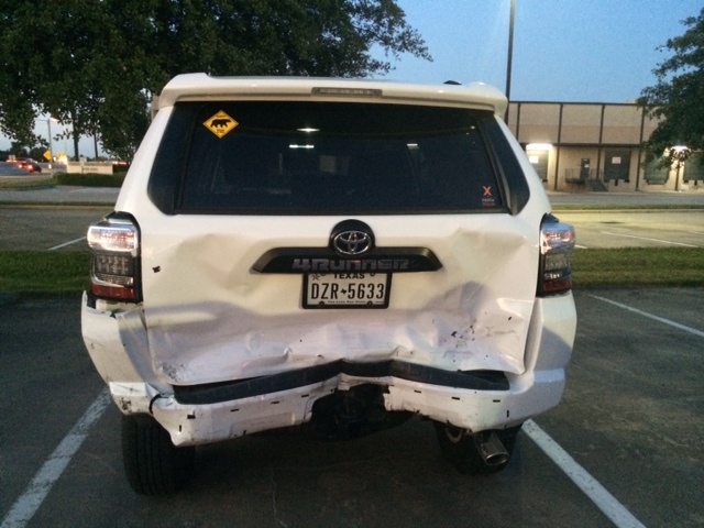

Here is a picture of the damage I received to my 4runner, it had about 3500 miles on it at the time. Repair cost was $4027.00

Rear frame section is bent. That black bar IS the end of the frame and it is bent upwards. The good news is that it shouldn't be too bad to fix (the twisting of the driver's side frame rail is my main concern since the cross member between the two sides can be cut and replaced), the damage doesn't appear to have buckled the frame too much and physical frames tend to be easier to repair than unibodies in general. The next issue is the cumulative cost of sheetmetal (body) damage and trim. Chances are the damage is going to clock in around 10k (not entirely sure how much to fix the frame, but the body damage and pieces alone are probably $7-8k including painting and labor.)
