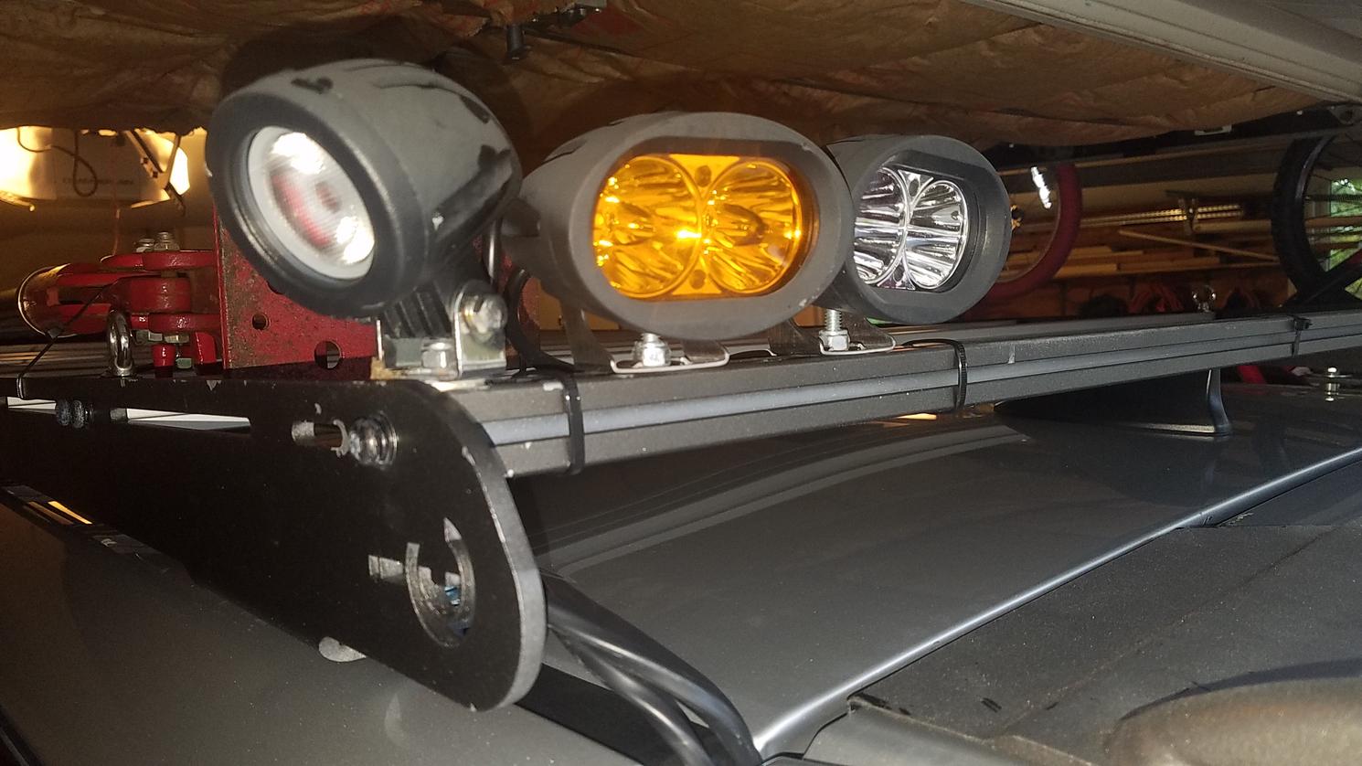

Anyone here mount a rear facing light onto their Prinsu rack? Specially, I have a set of Baja Design S2 lights that I want to mount to the rearmost crossbar. The hardware that came with the light doesn’t seem to work with how I want to mount it. If anyone has any tips or info on which hardware to buy, that’ll be great!

I use 1/4-20 carriage bolts slid into the rail with a nylock nut. I can get pictures later if you need to see.

I have rigid rear facing pods, they didnt work with carriage bolts so I just drilled that last x bar and bolted them through.
I ran my wiring down through the boot on the rear door into the headliner.
