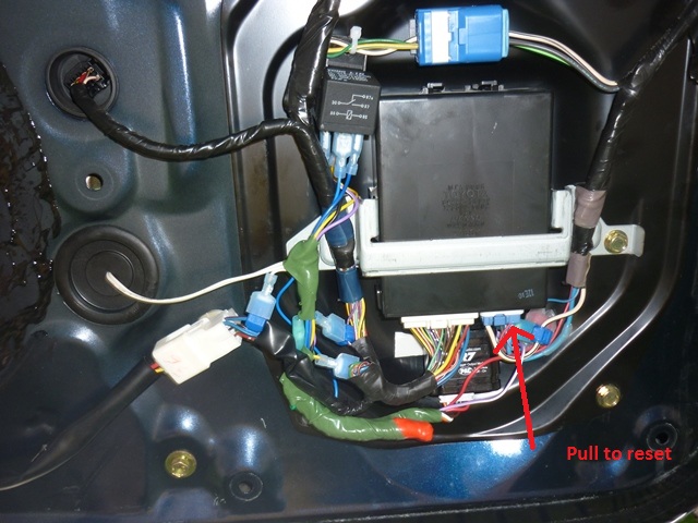

I'd pull the back panel off so you can at least take a look for any obvious physical damage. Here's how if you don't know.
Then I would unplug and plug in every connector looking for corrosion. Finally, I would reset the rear hatch ECU by pulling the plug on the lower right side, counting to 10 and then plugging it back in. You will have to normalize the window again.
Try that and report back.
Ignore the extra wires/relays in the photo. They are for the keyfob window up hack.

Asmara has some good advice. You need to isolate the issue start with wires, connections and move to the switches and sensors, see if everything else works? if the rear wiper and washer pump do not then it could be that rear sensor shut off that shuts things down when the window is not up, you may have a short to corrosion in that. Has it been really cold did something get wet? that may have started the issue but sounds like a short in the back of sorts to me.
