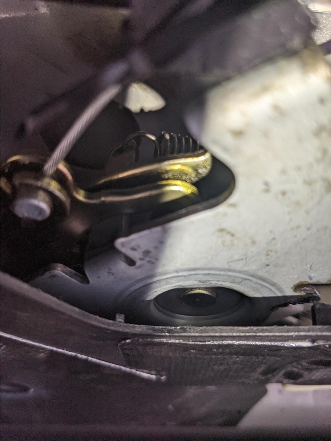

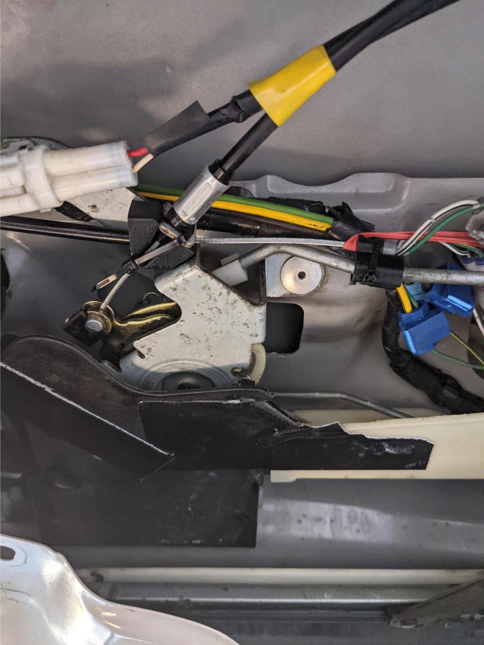

like many others have experienced I had issues with my rear hatch not unlocking with the key sometimes. after making and installing an interior hatch release it also didnt want to unlock with the power unlock most of the time. after quita a bit of fiddling around I found the metal and plastic mechanism on the drivers side where the solenoid and lock bar connect wasnt returning properly and blocked the mechanism from turning to the unlock position. the spring that does this is pretty weak and I temporarily added a rubber band to assist it in returning to see if that helped. since it stopped the unlock problem I replaced the spring with a stronger one and have had no unlocking issues for days. I suspect this is the cause of many rear hatch opening problems since if it is slightly off the hatch will not unlock manually or electronically. trying to attach pics close up and larger view. hope it helps someone.

Thanks for posting that.
I had a kinda similar problem. That plastic fitting on the cable, that goes into the metal bracket broke. Leave my cable flopping around unable to unlock or lock with the key. Cable ties fixed it temperately.
And a replacement cable fixed it permanently so far.
