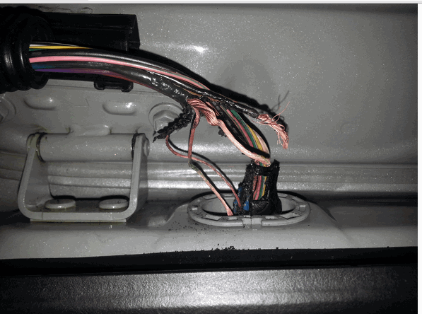

Sounds like a wiring issue. Did you check the rubber boot that the rear hatch wiring harness channels through? (Top left)
This seems to be a common issue.
Hopefully it doesn't look like this one... (picture from another thread)
Thanks. I gave it a look and both ends of the grommet look good. Would it be wiring if all the components work just fine when the engine isn't running?
