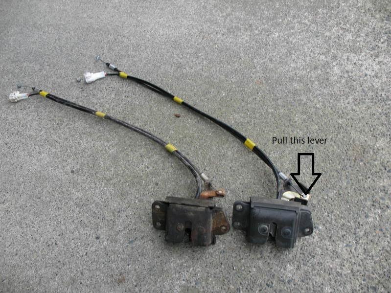

Maybe get someone to apply pressure from outside against latch area while you pull up on the cable?
latch
Spray sgood amount of WD-40 and let it soak over night. And like "JMartins" says pull the tab on the locking latch. See the image.
