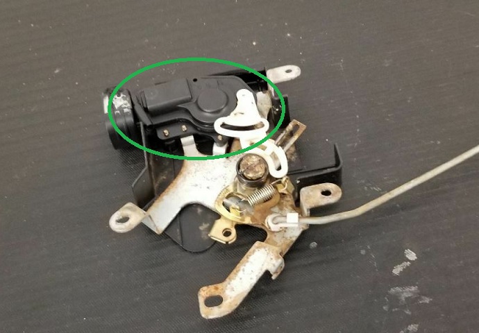

As a reference, the part number for the hatch lock actuator is 69690-35030. The actual name of the part is "Control Assembly, Back Door Remote" which made it a little difficult finding the correct part because I was looking for a part that had the word "actuator" in it. There also doesn't seem to be a lot of information out there on the hatch actuator.
I googled a picture of what the part looks like. The motor looks to be enclosed in a similar type of casing as the door lock actuator. Hopefully it's the same type of motor. I'll find out eventually once I figure out how to remove it. I may have missed it but I didn't see instructions on this in the FSM.
Yea I found the same through my research. It's not even in the damn FSM... The actuator itself is of course absurdly expensive, most likely the same motor. I'm going to attempt to fix the key lock first, but if getting to the actuator is easy, I'll try to crack it open and swap the motors if they are the same as the door motors.
For anyone searching in the future, I recently replaced the internal motor of my rear hatch door lock actuator and it is the same motor that is in the lock actuators in the other doors. Removal and installation wasn't any more difficult than any of the other doors. Good time to do the rear window inside switch mod while you're in there.
