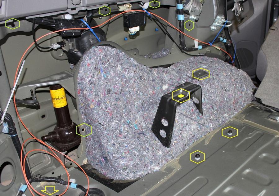

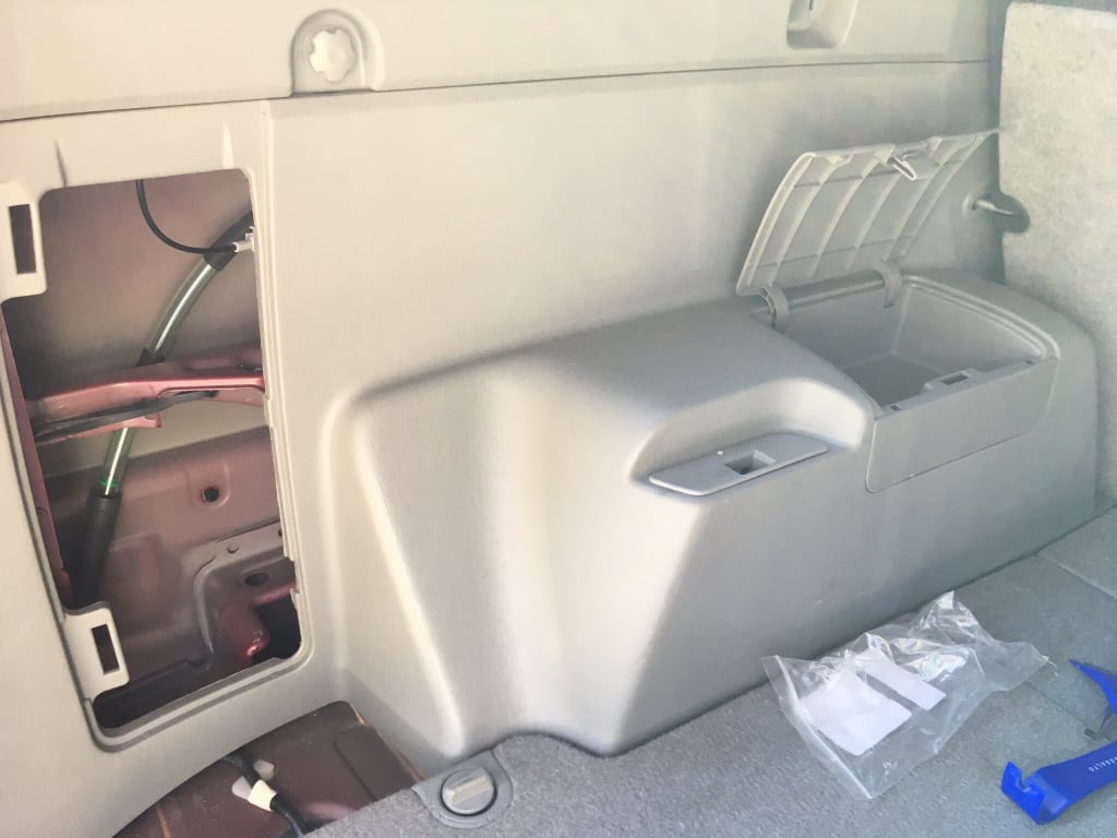

How do I get this panel apart? I'm getting a lot of squeaking noise while driving and it's coming from this area.
There's 2 screws underneath the double decker and carpet and a screw underneath the long step bar by the tailgate. You also have to remove the bolt holding the seat belt buckle
To add to it...once you get the screws out you just grab it near the jack storage area and PULL. :scared:
Open the back passenger door and pull the bottom door rubber up when you take off the seatbelt bolt.

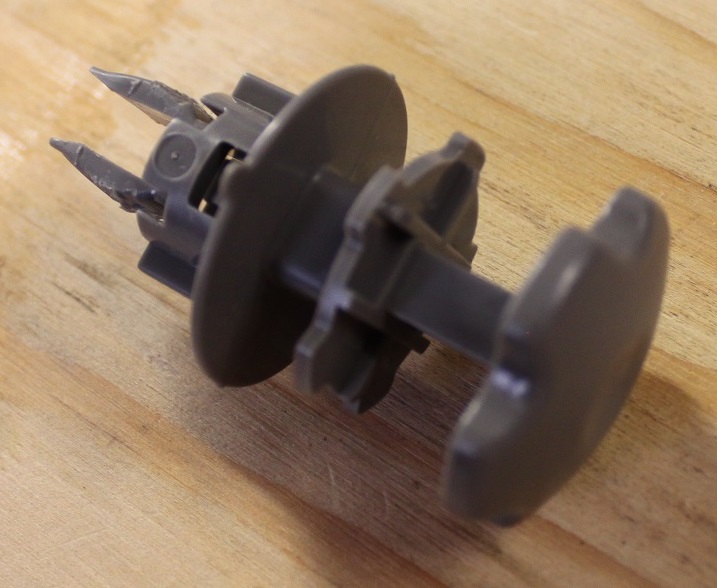

The little hanger-hooks are funny.
