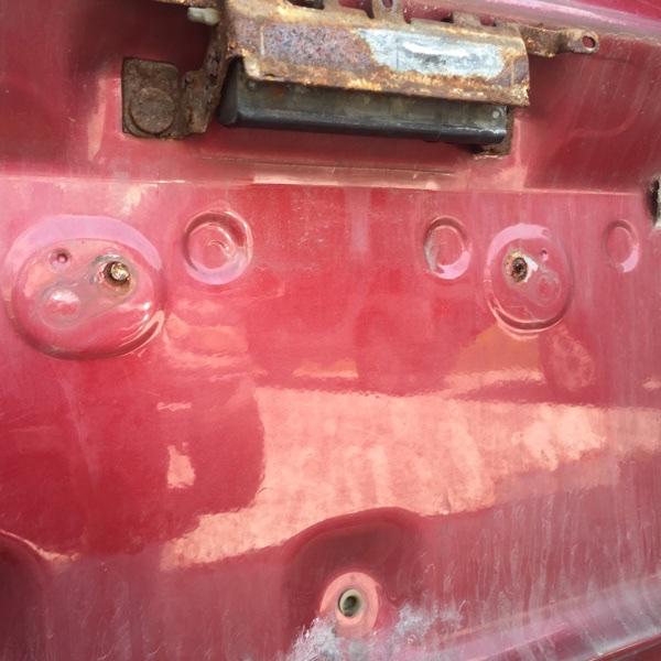

This is what mine looked like when I bought it.
Several of mine broke off as well, they are now attached with zip ties - real classy looking, and other way to get these bolts out? I bought a set of “speed outs” as seen on tv ads, they didn’t do sh!t,
Start with a small sharp drill bit and drill a hole through the center of each bolt. Then go up in sizes of drill bits until you end up with the bit needed for your tap and cut new threads in the hole you just drilled. Use plenty of oil while drilling and taping.
I've done this method many times working at a dealership.
Working at a dealership, I can tell you one thing for sure. The bolts rusting is only half the problem. The nut-sert on the vehicle is just painted steel and once you break through the paint - by threading any metal fastener into it - it too will corrode.
As other have already stated, plastic bolts are really the way to go. (That's all we use.) But I always apply a dab of corrosion resistant grease to the threads before I put everything back together. This will at least slow down the corrosion of the female threads.
