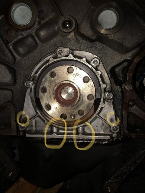

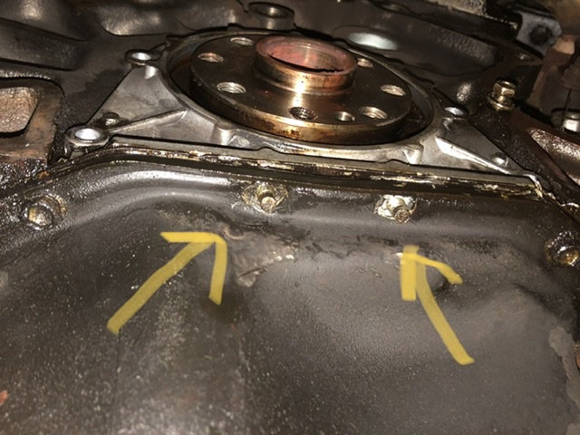

I’m stuck right where you were!! How did you get this off! Those two bolts that protrude from the cover through the pan are tight… Almost like they’re threaded through the pan. If I pry forWard a little bit I can get the cover to just clear the two tabs on the sides I’m worried that the angle maybe too much and it’ll break that aluminum cover or create an angle too sharp to move those bolts up through the pan… So please please tell me how to do this����
