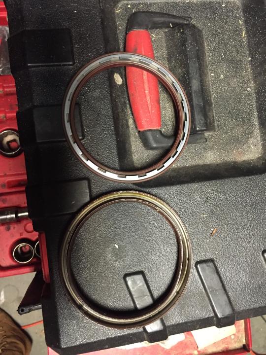

I'm pretty sure I ordered these from the same dealer, however, they are clearly different in design....so which one is right?
