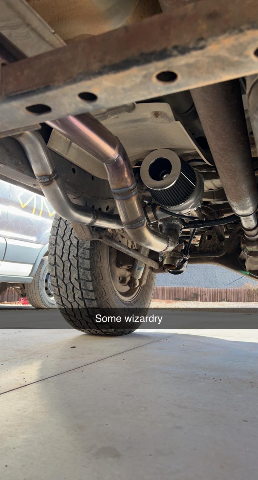

Also late to the party on this one. I looked through this thread a few years back and decided it was time to give the 3rd gen some boost. My budget was just over $1000 and it all came together quite easily with the help of this forum and lots of research. Nothing new to add other than this setup works and works well with the turbo trim mentioned early on. I’ll attach a photo of the setup for those who are interested. I do not have a body lift so my “up pipe” to the turbo had to be designed slightly differently. There is clearance, however, to run a 2 inch charge pipe along the frame rail and into the engine compartment without this lift in place.
