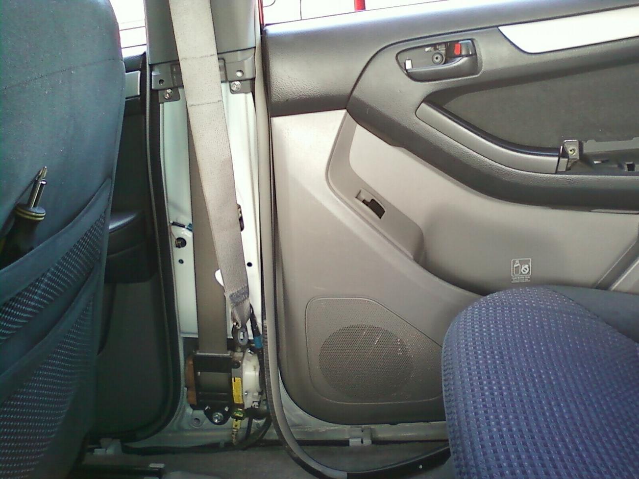

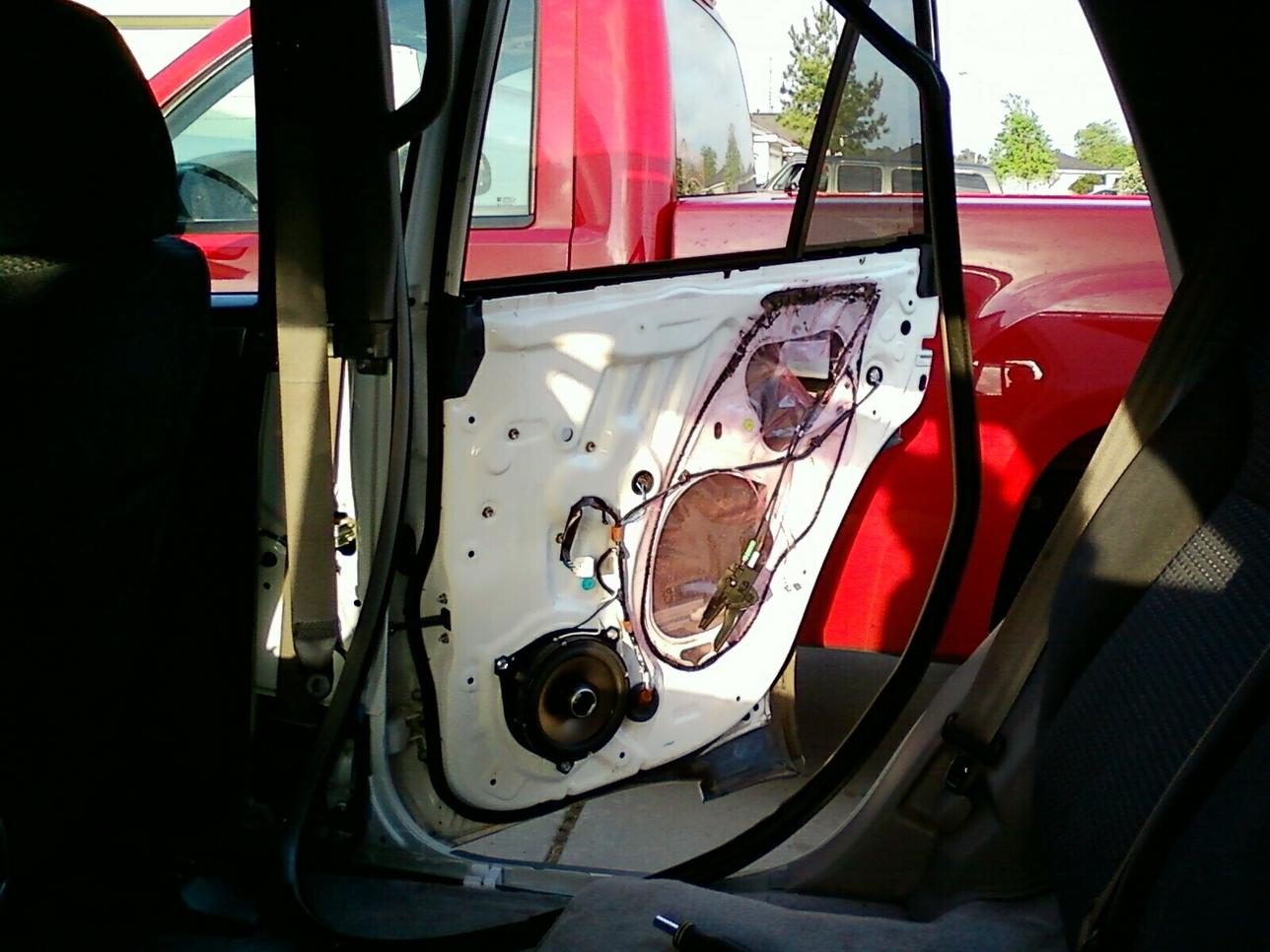

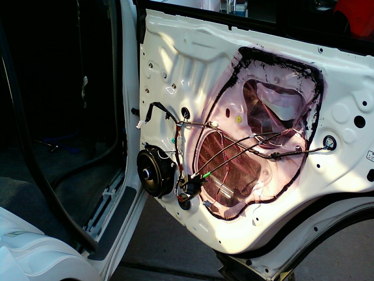

You were right, it's possible. It's a HUGE pain in the rear though. I had to take out the back seat, remove the door weatherstripping, the middle pillar, passenger seatbelt, and floor things, but I finally got it out. And luckily I was able to fix the handle problem, turns out it just wasn't attached to the opening mechanism thingy. Door's back to normal now and I didn't have to pay anyone to do it!!! yay!!!! lol
