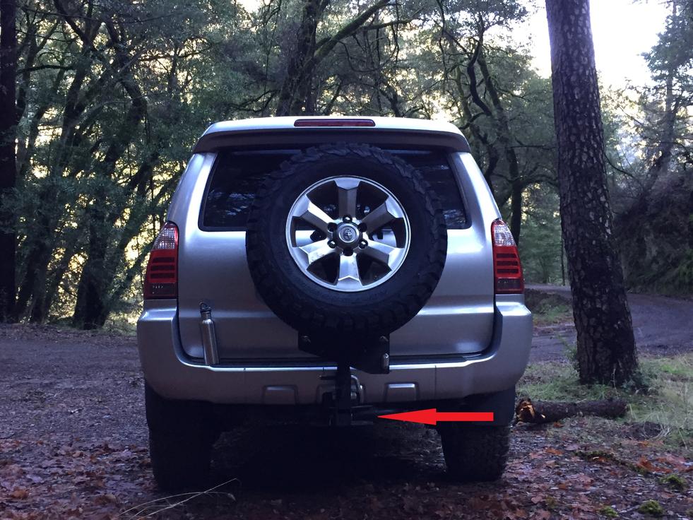

How far does it hang down below the frame. I have the muffler on the passenger side. There is about 3" of space between the muffler and frame.
Reroute your pipe to the side, add your recovery point and cruise with the rear window down worry free! :D
Just additional recovery points on the corners you can use. Some people remove the hitch to gain clearance for wheeling purposes or reduce weight. A receiver hitch shackle adapter will stick out backwards and I've seen my brother's get grinded against rocks in Moab. (Guess he could of removed it until he needed it) Ours are tucked up nicely. I will admit the receiver hitch shackle adapters will be strong and easy to use especially with a soft shackle.
Departure angle isn't effected on my 4R or the FJ.
Also... if you happen to have something attached by the hitch (e.g., a tire & hi-lift carrier like me), it allows easier recovery without swapping out the carrier. :wink2:
