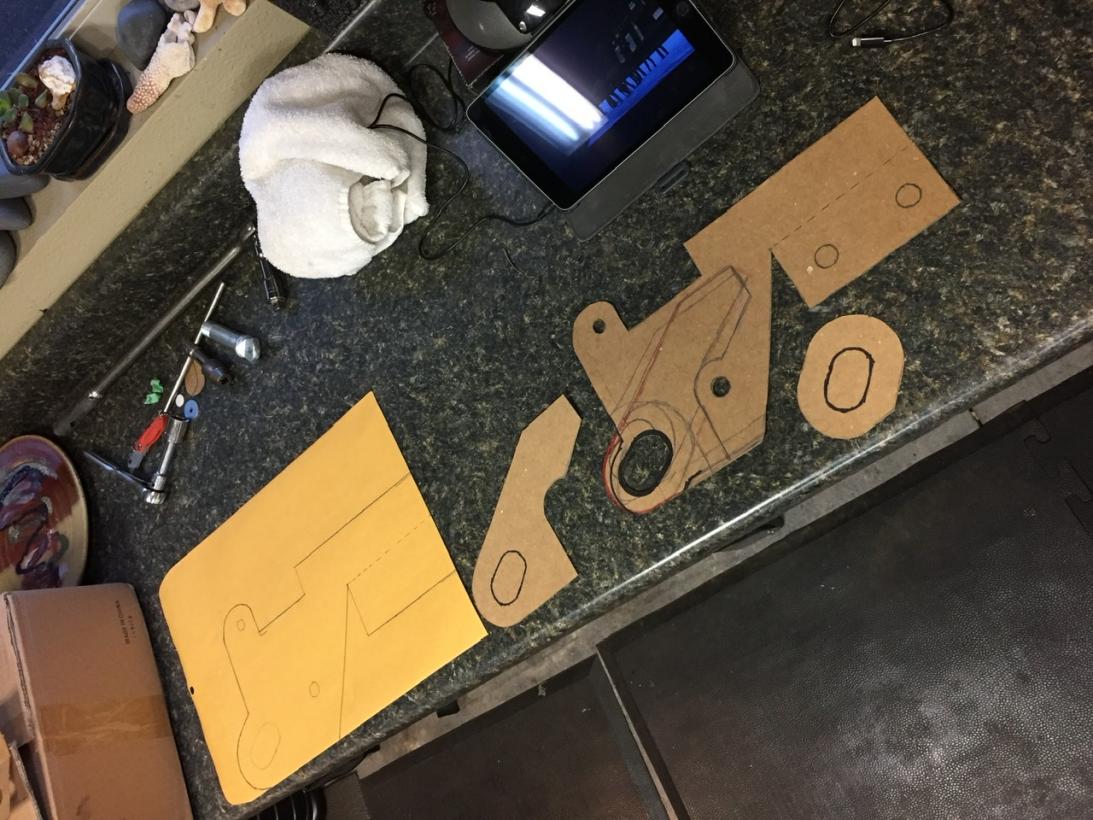

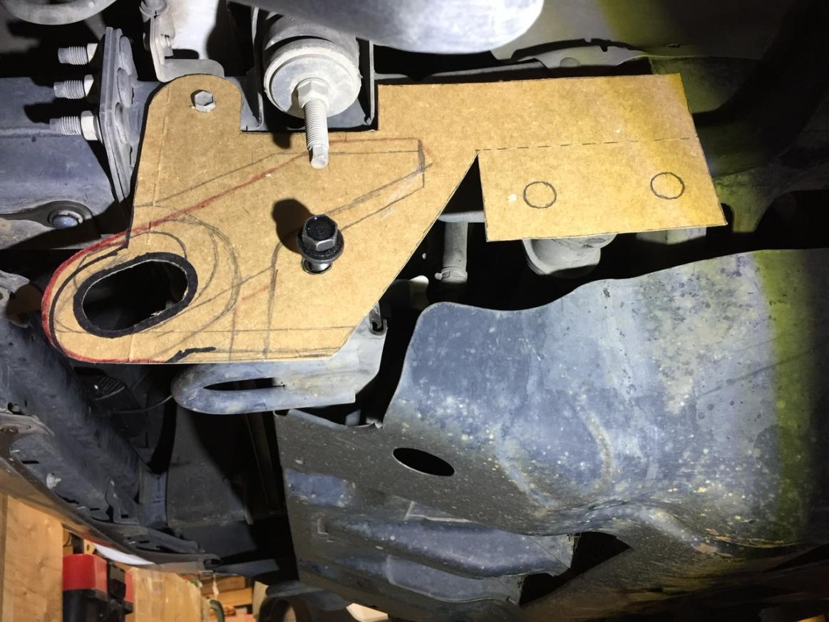

I was looking at a thread with some old posts. Reminded me that I mocked up some front recovery points.

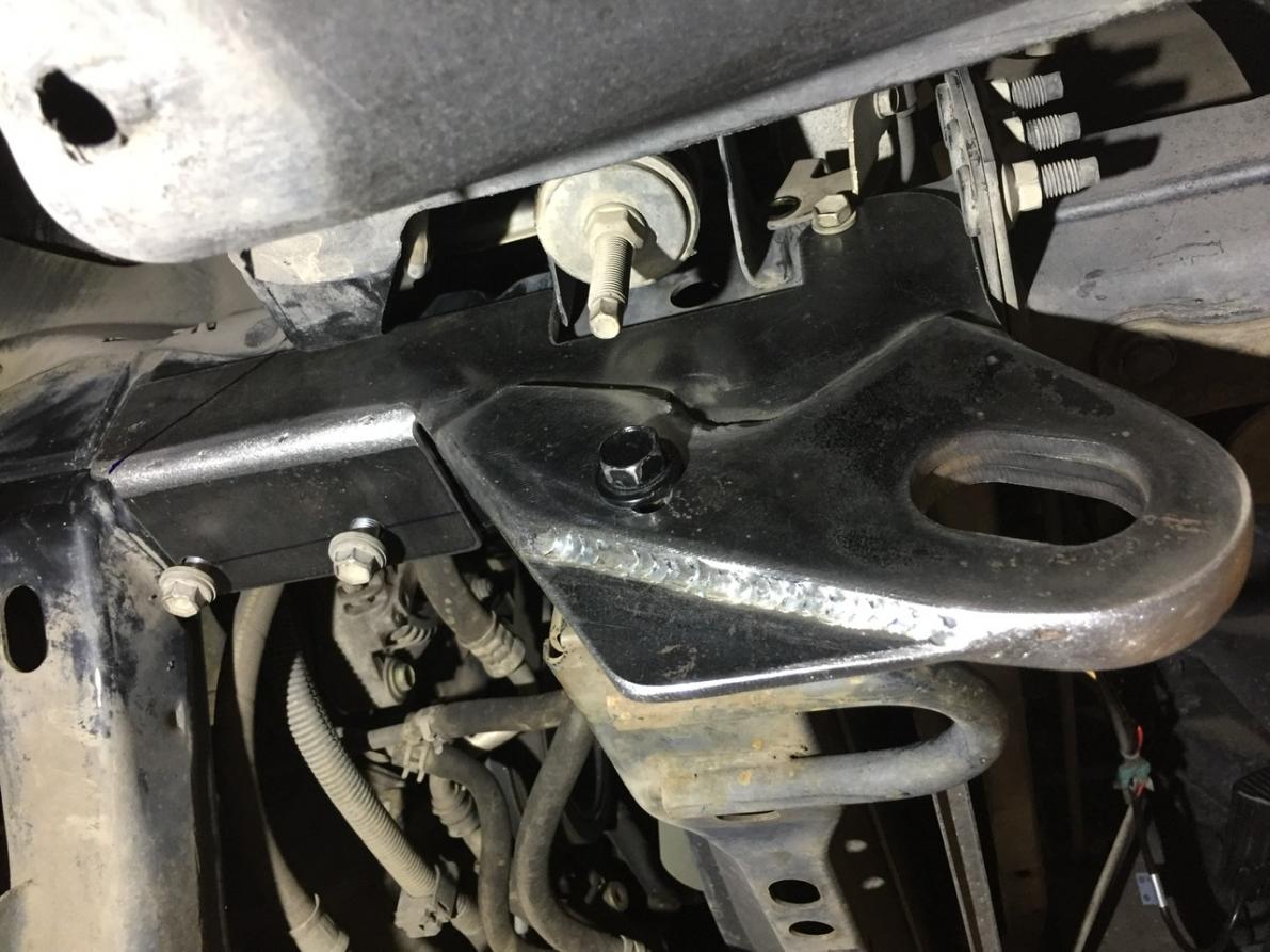

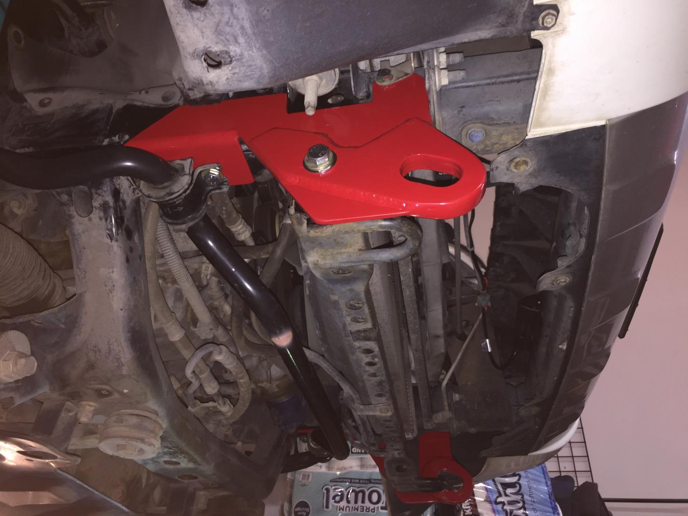

I had a buddy with a laser cutter and he is a pretty good welder. They turned out pretty good.
If you can do those things and are looking for a template let me know. I’m sure I could photo copy them and mail them to you.
You might notice on mine I designed them to have a half circle go around a bolt on the piece to add width and strength. My buddy welded them on upside down, but no biggy. The side bolt actually just goes through more metal now.
