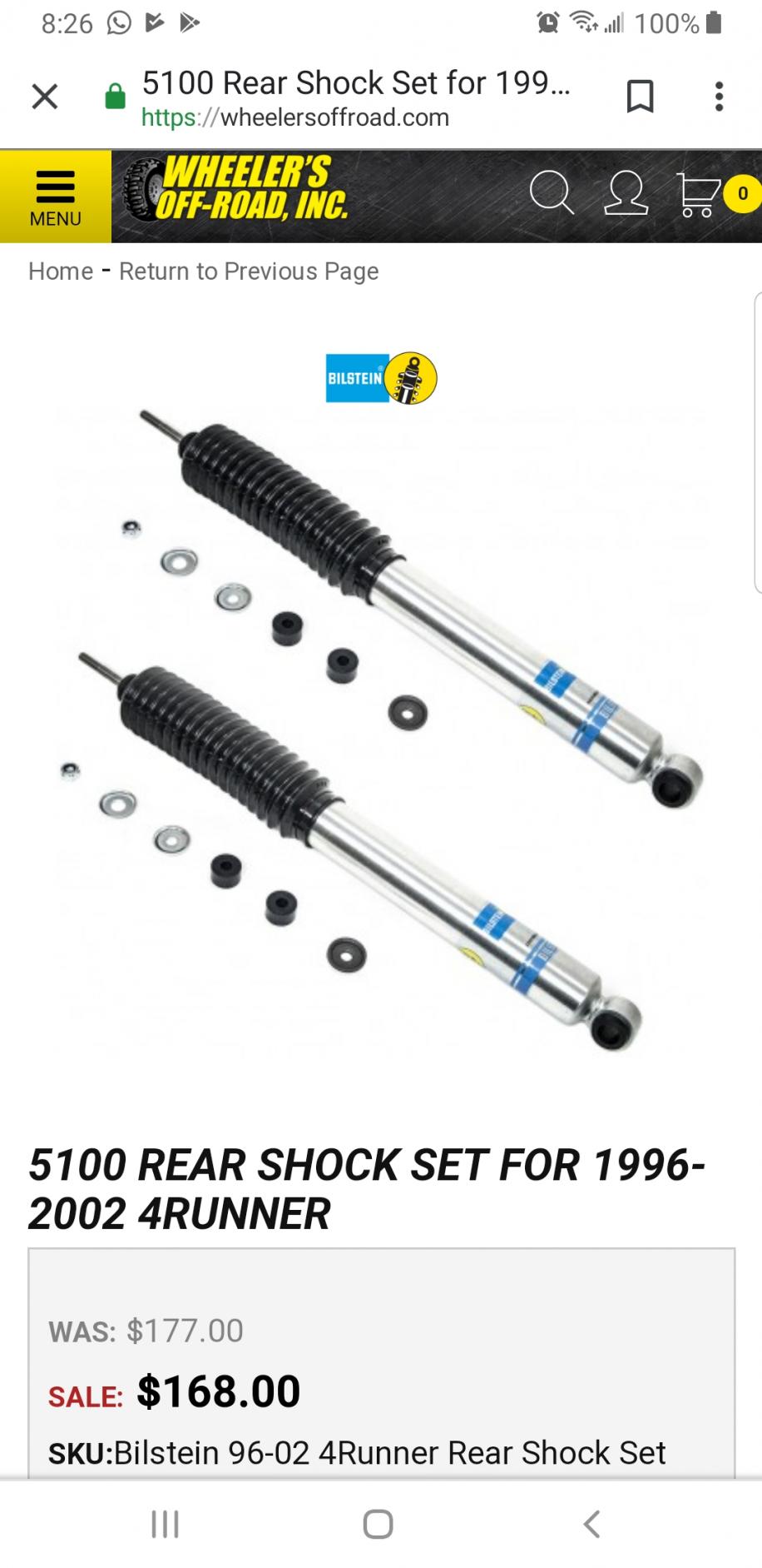

Here is a pic of the hardware i need
Might just have to go to dealer

If you search energy suspension or whiteline, those are two good brands that come with the bushings only and no hardware. Or you can order OEM from toyotapartsdeal.com or somewhere online cheap. I bought some energy suspension bushings recently for the rear shocks and they were $11.99 plus$6.99 shipping. Reasonable. if the hardware isn't too rusted you can just reuse it.
