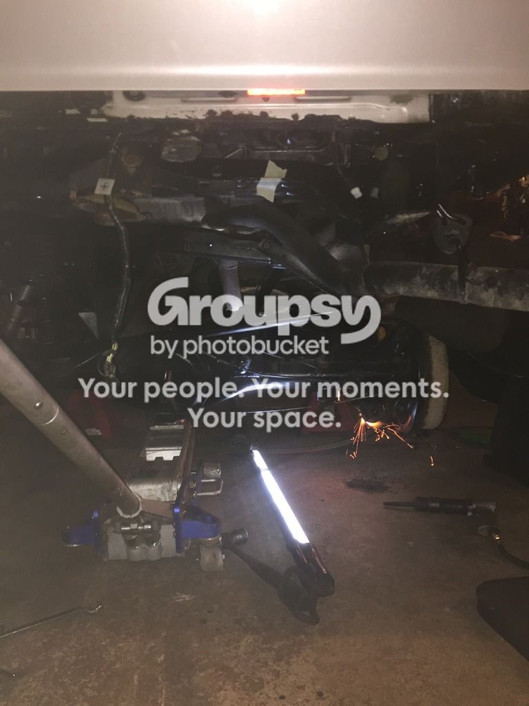

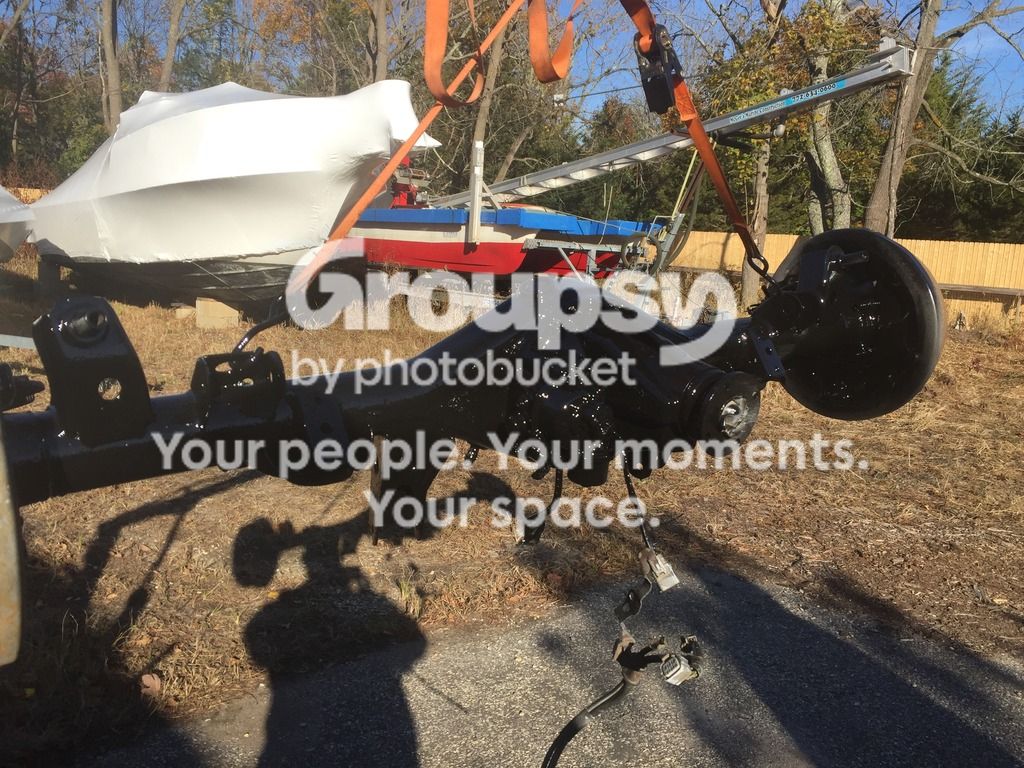

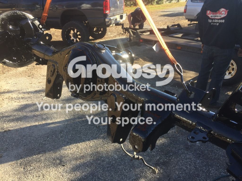

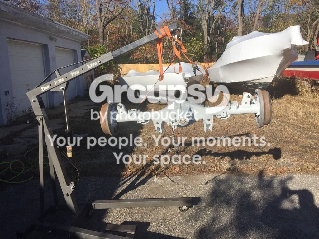

Prayed the axle with chassis saver.
My friend making it happen for me.

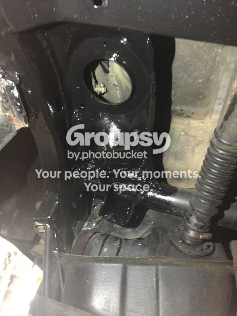

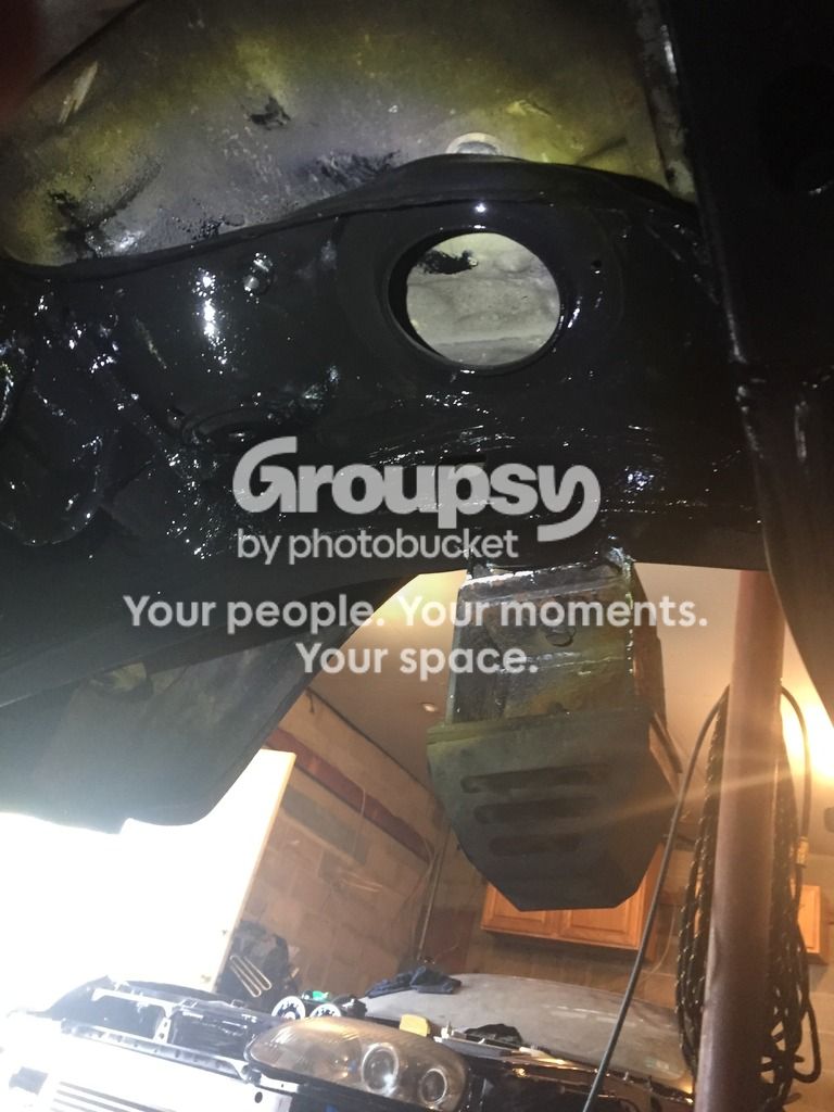

Primed and painted before the shock mounts gets welded. Because it will be impossible to reach some areas with a brush after the mounts are welded.
Test fit
Best believe it. It fits exactly in the same original spot. Only thing is we had to cut back the front part of the mount facing the front of the truck. The section that goes on top of the round cross member. But no big deal. My friend cut back the old mount as far as possible. And trimmed back the replacement one and it sits very nicely.
This was the hardest part to weld for my friend. The way the mount goes on the tube. It creates a big gap. The original mount is welded from too before the body goes on. But no big deal. He filled it in pretty solid.
The driver side.
Painted.
My goal after it's set up. To put grease or just fluid film that I have in a gallon, in the cracks or tight areas. This way it will keep water and moisture out. Anywhere there has been engine oil or geese on a car after a long period of times. There is just no rust.

Is that a rubber drain plug in that picture? I'm wondering if removing that could let you access the upper shock bolt.
I Think it is a drain hole. But I dont think you will get much luck. Notice in other pics where the shock mounts vs the drain plug location
