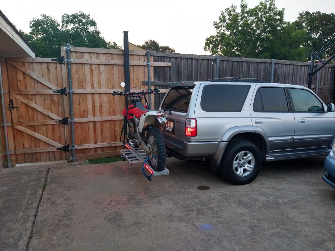

Airbags. I would never put a super heavy spring. The airbag is variable by design. I air mine up to 40psi with 400lbs on the hitch and I don't even know the load is there.
