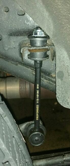

I used Jeep JK end links. You have to cut one end off to desired length and thread. Add bushings, washer, and a nut and you have a sealed end link.
