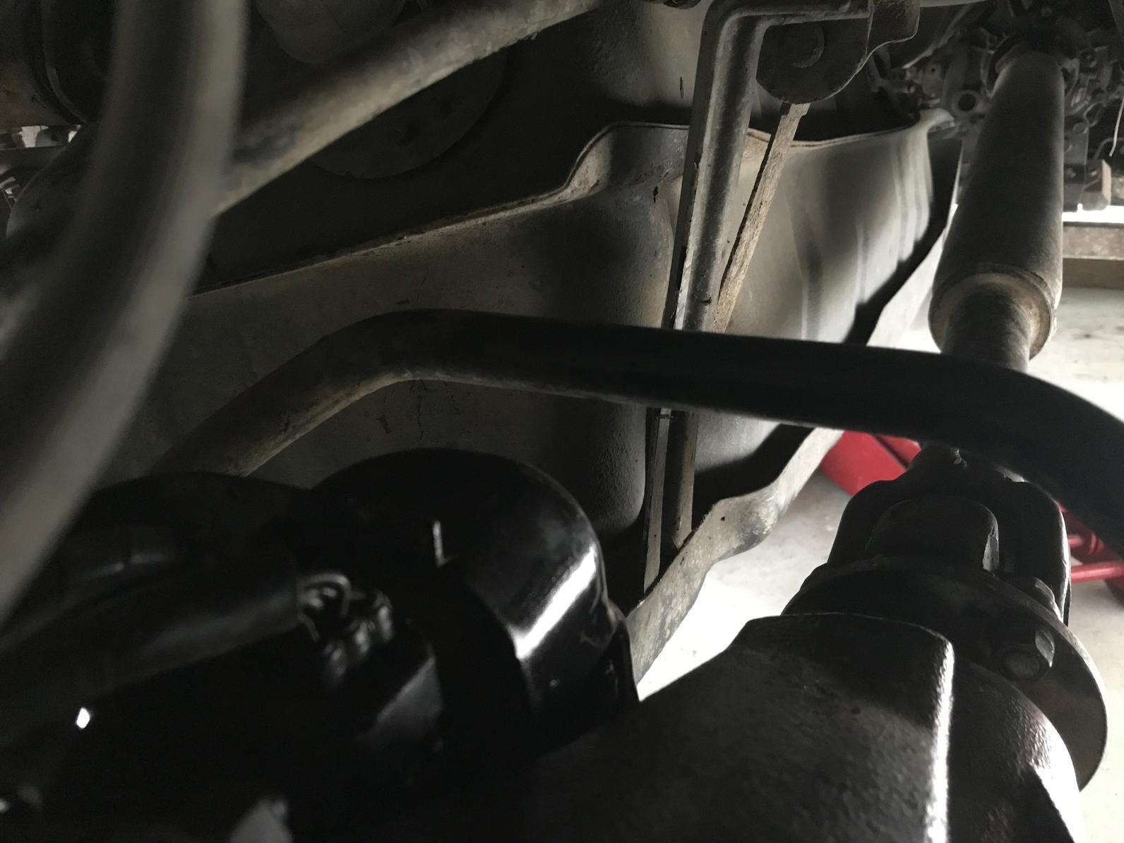

I put the e locked rear axle in today my 97 and got it bolted back up. When I put the sway bar back in it just hits the elocker housing. Checked it against another sway bar I had and they are both the same, one of them came off the locked axle. I never heard of anyone having this problem and tomorrow I will pull it off and go at the bar with a sledge hammer just to get the clearance I need. Anyone else have to do this?

Pretty sure you need the sway bar relocation brackets like SS sells to get the sway bar to clear the locker when lifted.
Thanks Unner, running OME 906 with 10mm trim packers so its not sky high but there is no extra weight either. That does give me some ideas to work on
Longer sway bar end links help at all? Trying to remember which way the sway bar swings.
I don't have any clearance issues with my 2000. Elocker rear, factory sway bar but with longer links.
It's a pretty common problem from what I've seen. Even stock trucks have the issue. Longer links will help to rotate the bar down towards the pinion. But you can't go too long on the links otherwise they will start to contact the lower control arms on compression of the suspension.
the sway bar's bend over the pumpkin is such that there is space to clear the locker assy. that's why the center of the bend is not centered over the pumpkin instead is located towards the driver side.
the OP could have reversed the orientation of the sway bar that's why it's hitting the locker assy
Thanks for the replies. The bar is on correctly, that pic is taken from below on the ground and the bar just clips the top forward corner of the locker housing. No way it will fit any other way. I think i will make a couple spacers to put under the brackets along with some longer bolts. This will bring the whole bar forward and up just a bit. I tried doubling up on the bottom bushing on the sway bar link,(essentially making the link longer) but this actually made the contact worse
The SS1.2 kit I installed comes with SB raise brackets. Using steel flat bar 1/4"x 1 1/2"x 4" apprx on the length. Flat bar raises SB 1 1/4", forward slightly due to angle of mounting bracket on axle. All that you need are two pieces of flat bar, a drill and bit, 4 extra bolts & nuts. It is more important to go up than away from axle. Mount the flat bar to existing axle mounts, center the SB bushing over upper existing bolt drill two holes to mount SB in new location. you need to cut hole in rubber bushing so SB bushing sits over upper bolt head. You might do it a different way just splaining how it's done on SS1.2. Then get you end links for 2nd gen runner to compensate for new ride height, they are 1 1/2" longer. A pic would be better I know, but vehicle is 350 miles away.

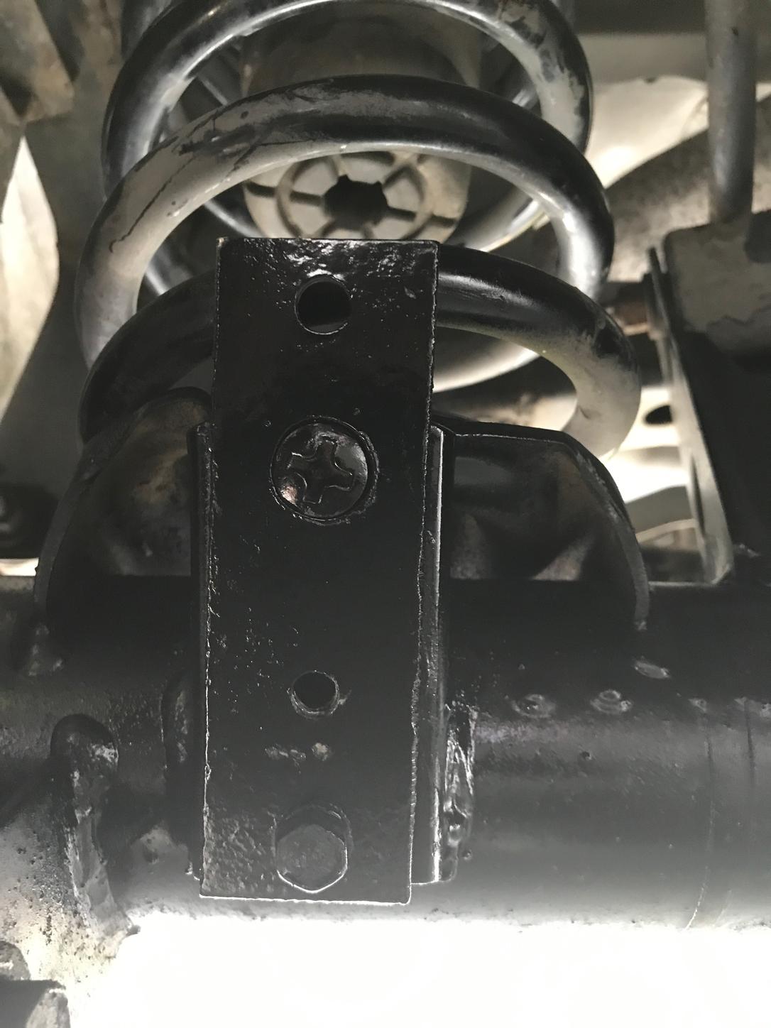

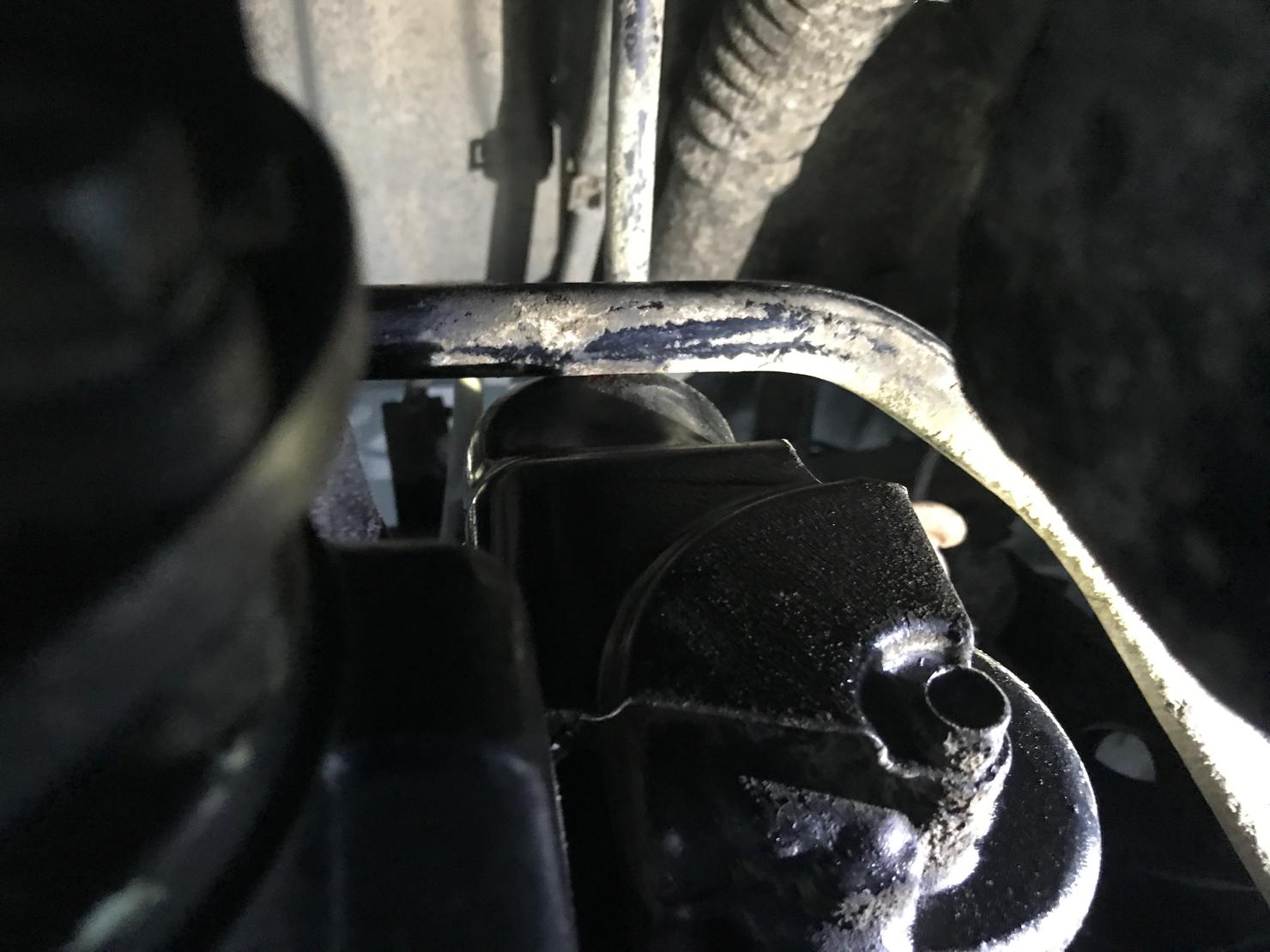

Made up some brackets and now it clears no problem. Thanks to everyone for their help.

ST Runner, looks like you counter sunk that philips head. I was thinking that would be a better way than cutting a whole in SB bushing when I got my SS1.2.
