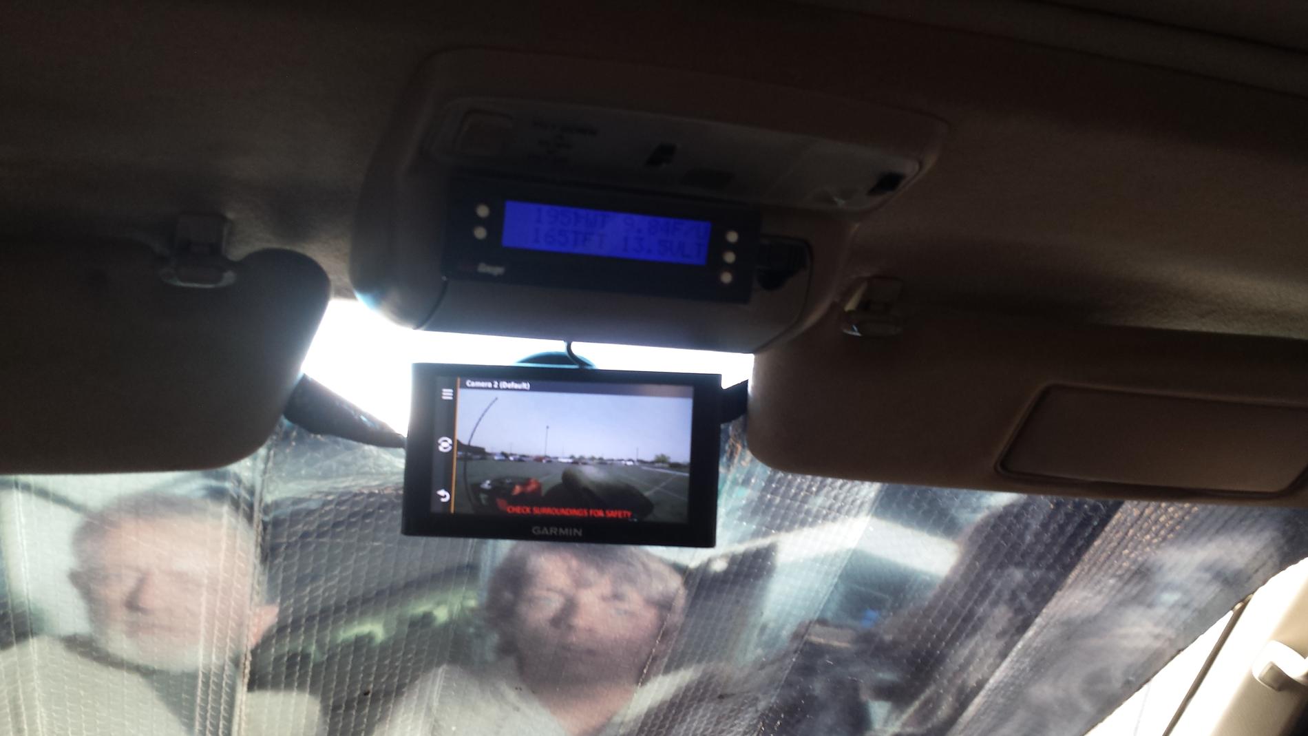

I have a 99 with Cbi, duel cans, 285/75 spare, hi-lift, table, and a couple of quick fist clamps for a shovel. Couldn't see poop! So I ripped out the mirror and installed a gps monitor with back up camera. Wired the camera to a dash mounted switch. Works great for me. You also want to look into getting a set of rear body mounts from Sonoran steel.(helps deal with all the new weight, and stops the bumper and body from hitting each other.)

The rear camera. Any after market rear view system should work. Just instead of connecting to reverse lights for power. Run a fused switch in the cab back to the camera. :guitar3:
Holly crap it worked...I'm such an old bad ass. Now that it seems I'm figuring out how to do this multimedia ting um. I just might have to do a build thread for "The BLACK" . Will I get in trouble for saying that? It's my truck,and the flag I sail under:flipoff::

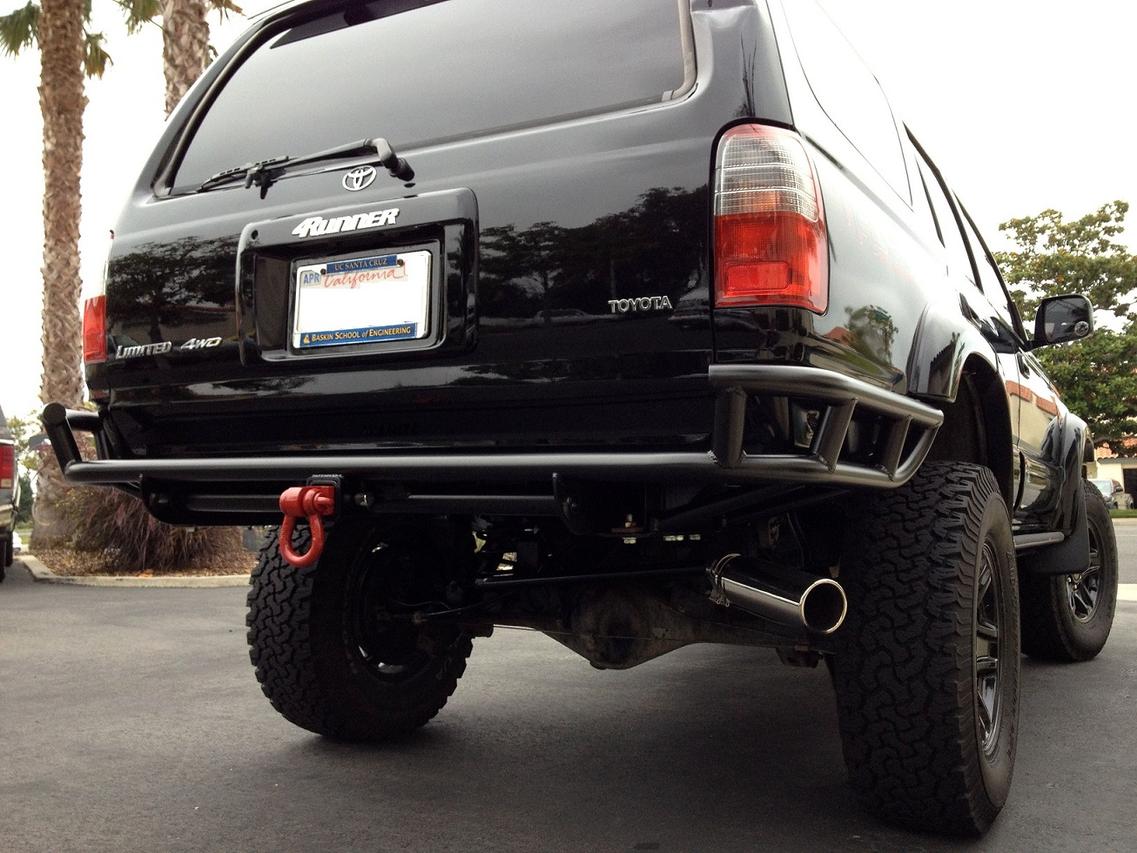

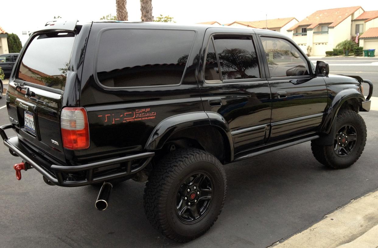

Here is my $500 Savage Rear Bumper (I think the price has gone up slightly). It is very lightweight, fits a full 33" underneath, has no rattles or movement, doesn't block any vision, and I think it looks pretty decent.

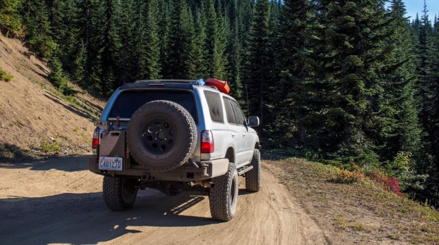

I have the 4X Innovations rear swing out with added SS solid body mounts. Out of everything out there, I really liked the 4X Innovations design and the Savage design. I really like where Adam at 4X Innovations decided to place the spare. It is not super high like the CBI, and not low like the Shrockworks. It is a stout design that looks to be rock solid. I can still see out the back window, but I DO check my passenger side mirror more for lane changes. Get some FN 5-Star wheels, and you can see THROUGH them! LOL. The 4X latch is also beefy.
