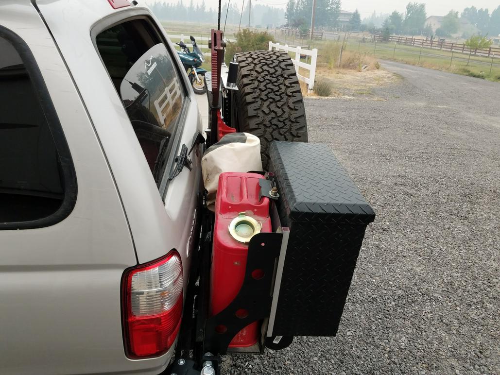

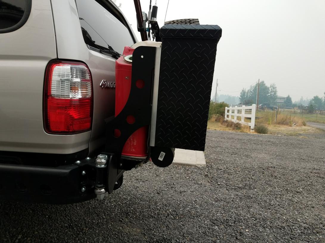

Definitely something to think about. I tried to keep departure angle in mind when I built my second swing out. My favorite part has been my box so far.

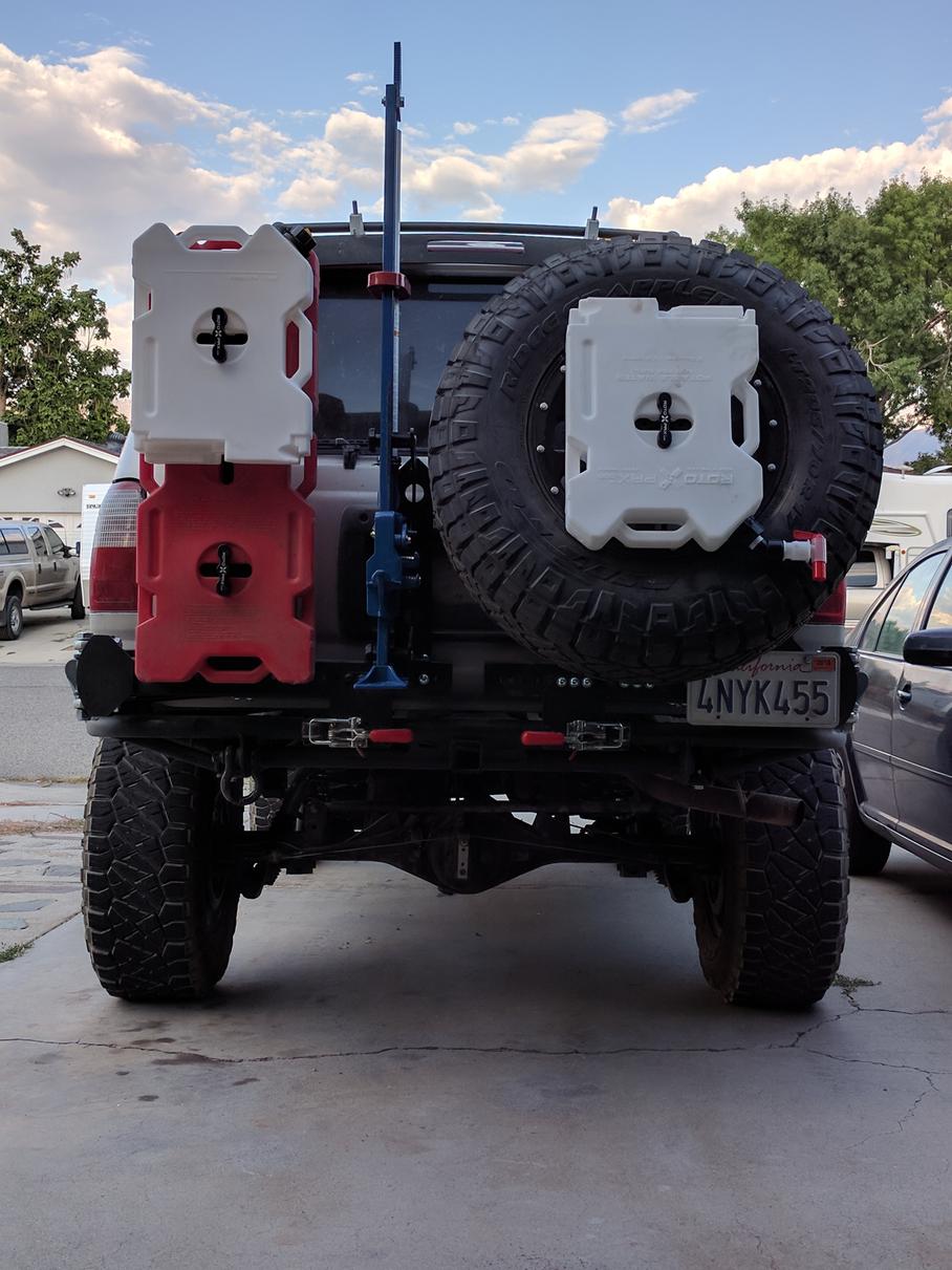

No regrets. I always use my my mirrors regardless of what I'm driving so the increase in the blind spot isn't a big deal to me. The ability to have everything I need on my rig for trips is the big plus. This is a dual swing out Savage. No shakes, no noises, no problems with the install. It's well thought out and well put together. I've haven't had it for long but I've beaten it up pretty good wheeling in the time it's been on my rig.
Zle4dWzTrDGZVsWH34NwErWp0gfQ1V-uWA-zsUp89OgE1I3FdnwmdMAY9y8xW-3ziTbV3si2ZJ3Hio4KB5QipjxT08V58epnLB7DaQMBNMlJNwuswSY5KM3O4i537qIuw-0HYaDKaxcnuQBUZWoznwuCuY3i2j0nfBhXEHcvy4-qa4FdikHL9_TAuRXNTvS77wHAd73syBw5y9l4Tu6sT-AxSL-WiaxFSHMQo4ho5Ti_L2t7NbebUQNe5ZlHi4VxjgArhwmnT9GDOpZ2tmtfaFAbDmYOKCQsnT7tdVQP_T33RvIWODRFULGNDHDUZXoab1wkUSiRqRvmcTLH8LogSBuDBt_FQu8YaQxfztTzjyKMxX4JyvVFU5-Fe5zxpY8_naGW7ThQBulS9oL1Rt1o31JhFPjRylcVGYMN0vzDiKreACG6jyR96IKT1vyZxU8I11Pa9sz6JF03RLe_dVvmgbeHv8GwFy5v4D6IuD6Bex4Dy50QtlPWmPm5fHcSvQvttAtbHtOKCAV39TcH5DQIRsWt9rlt8n5V2gQgs2aCgo-FO8ePXRK2_jo1aUZzA4OMDGJHU4RvyiSSEzYXLvkUbYG0XIFhlmdShgn9DMYY4rxQDrXyImzt=w723-h963-no-tmp.jpg

Badass set up. I to have a savage rear bumper. And like I said. I can buy the other swingout, add ons whenever .I can switch the tire carrier to passenger or driver side whenever. I can adjust the height and angle of the tire whenever. Not to mention it's a light bumper. But.... with roof rack. I mount my gas cans on top. And hi lift in the trunk.
Can anyone confirm if the Savage bumper blocks tolls cameras in Washington? This is a definite thing to consider in Seattle area...
Like blocks the view of the license plate? If so you can put the plate anywhere along the swing arm. I put mine over on the right side because that was the shortest run of wire to wire the light. lol
