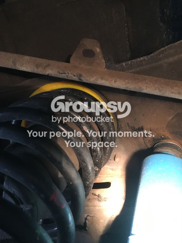

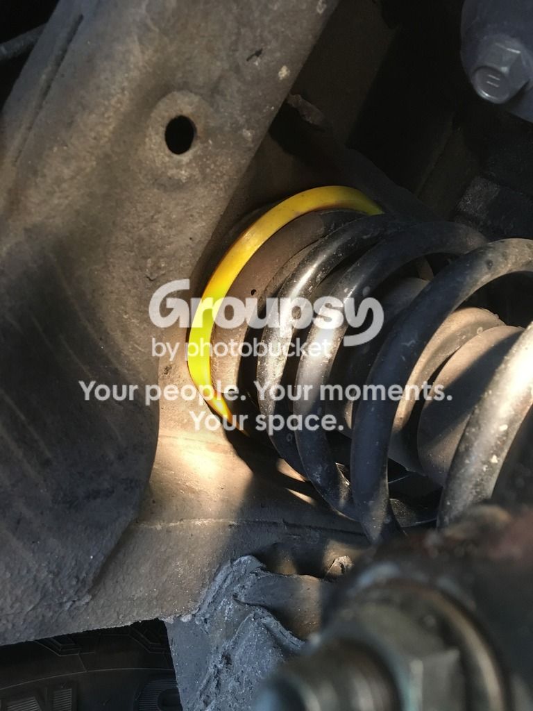

I have 99 coils and have a bit of a lean on the driver's side like most 3rd gens do. I installed an OME rear trim packer (80PF10) and it seemed to take care of it... for a while.
After a few hundred miles the trim packer has gotten squished and is halfway extruded out of one side of the top of the spring.
Can someone recommend a better spacer for this purpose? I only need about 1/2" of spacing.

Really? Makes me want to check mine.
I dont know of another coil trim packer for the rear. Im guessing that Tacoma kit is for the FRONT, since the Tacomas have leaf springs in the rear.
I had to add a toytec front trim spacer also to get mine to sit perfect.
You can also remove the rear right inner cone stop and leave the left on in place. This may fix the lean and they wont wear out.
Cornfed suspension will make custom rear spacers to most any size you need. He made one for my 4th gen 4Runner to correct the drivers side lean after I installed a leveling kit on it.

Here's how my OME one looks right now:
IMG_0853_zpsaev6xoel.jpg~original
IMG_0852_zps0xqxoyyc.jpg~original
