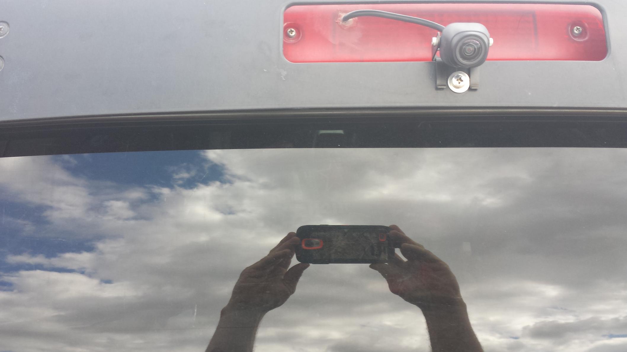

I mounted mine in the middle of rear spoiler/hole for 3rd.brake light. Melted a hole in brake light lens to run wire into interior. Silicone hole on both sides.

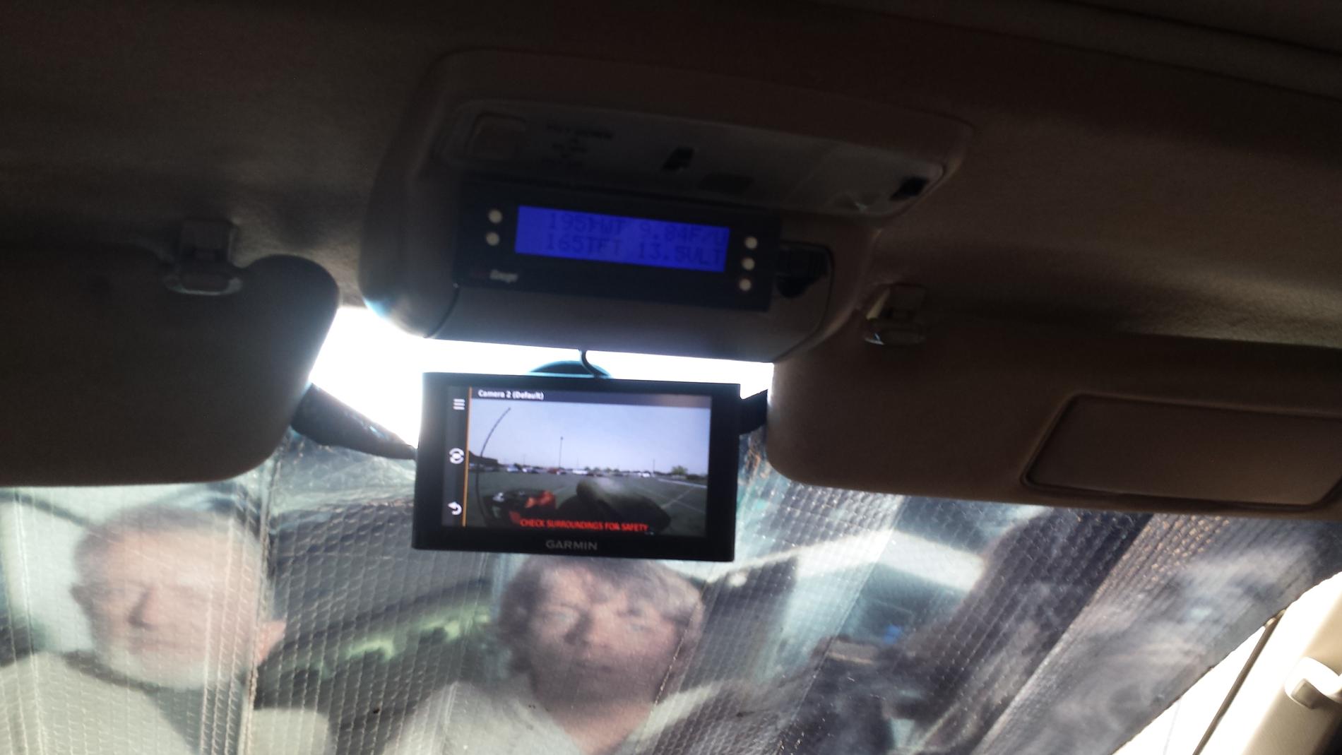

The rear view mirror was basically worthless. So I removed it and mounted the monitor in it's place. That I do have pics for.

In the picture. The screen shot on gps is the rear camera view. Except I was testing a shovel mount location on the bumper. Mount was good but the shovel kind of blocks the cam.
I like the way you mounted it. What kinda camera are you using ? Only different thing I would of done. Is ran it through the rear tailgate wire loom. I'm going to run my camera on a switch. Because I did a manual swap and never hooked up the reverse lights. Switch would be better anyways because I can use it anytime.

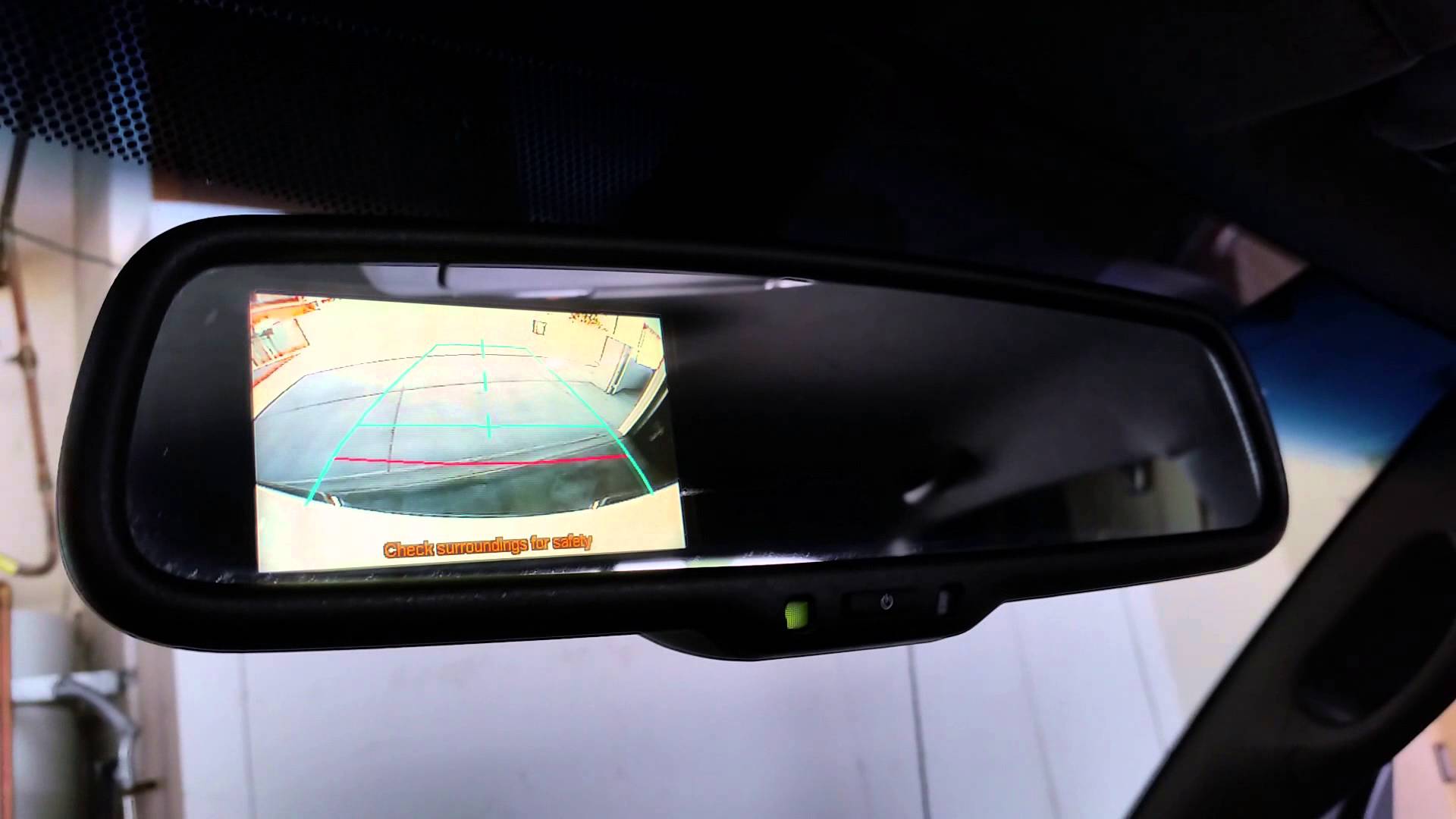

Its nice and clean when its in the rear view mirror like my Tacoma.

It's a Garmin nuvi gps w/Garmin bc130 camera. The camera is Bluetooth to gps. I ran power from acc.fuse block to switch on dash back to camera
Ran power wire for gps up though headliner down a-piller to acc. Fuse block.
Switch on...rear view. Switch off...gps.

[MENTION=50342]JayRolla[/MENTION] are you able to use the sun visors ? Without hitting the mirror ?

Yes the visors work fine in the tacoma but it was a dealer installed option. The mirror is not much larger than a normal mirror.
Ive been wanting to swap one into the 4runner.

Interesting. Because I replaced my stock mirror with a auto dim/compas/temperature mirror. It's larger then the stock one. I had to put it on more then once. It has to be DEAD CENTER between the sun visors. Once it is dead center. Both sun visors clear it by about 1/8". So very tight. Because if it's little of center. When you flip the sun visor down. It hits the mirror.

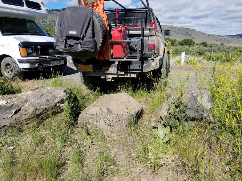

I didn't have to relocate mine cause I already have a very one-of-a-kind setup :) But I did have to add some turn markers due to visibility and afraid of getting pulled over. Now I am here...
Here it is, but currently changing it now due to a large branch, a trail, a river, a muddy slope and sliding off it.
Here is the picture with the carrier and lights. My back-up camera is on my license plate.
