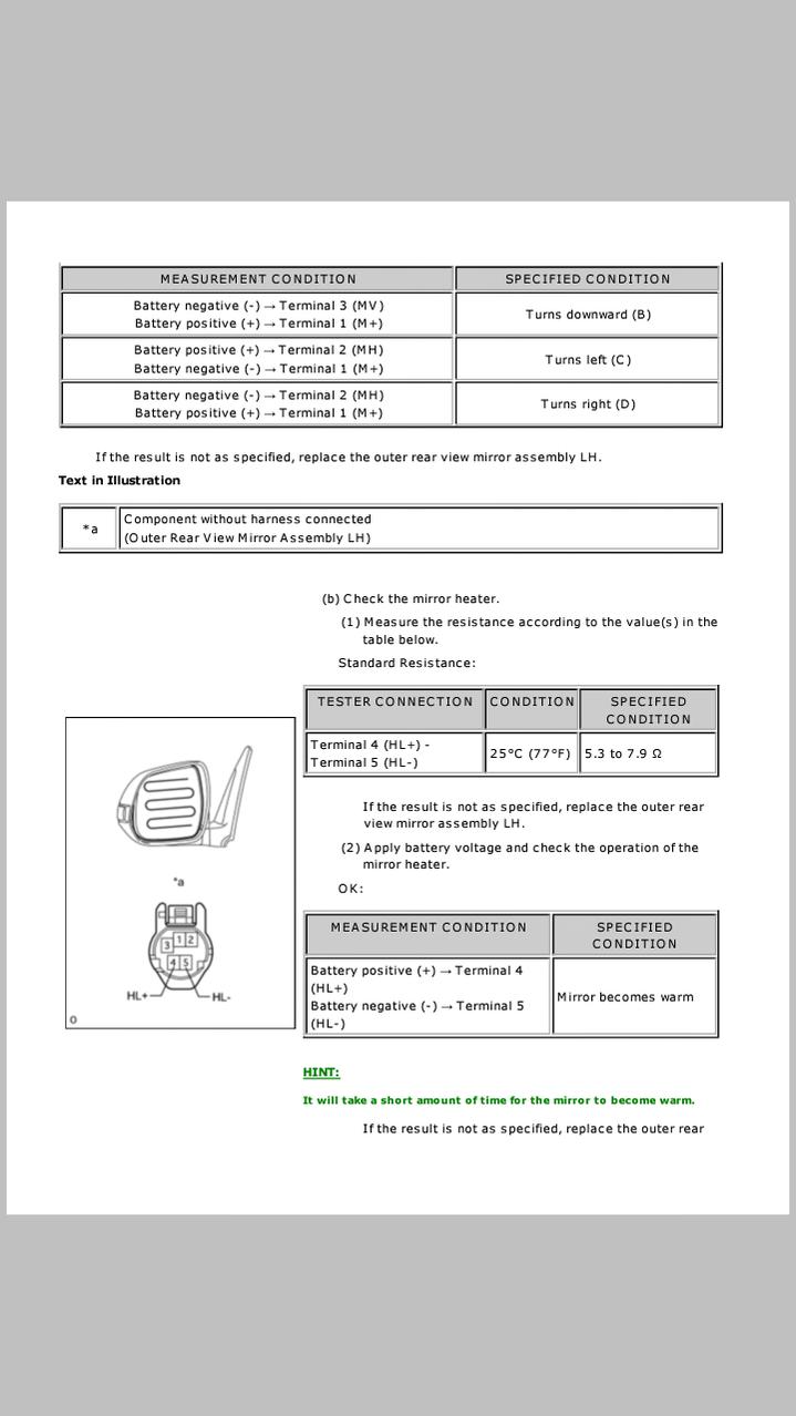

It was about 40F out and mine were just warm to the touch .They have a 15 minute timer and I tried them twice. Are you sure yours got "hot" before, as the manual check for them is to see if they get "warm". Maybe somebody else verify that they just get warm and not hot.
Here is the check from the manual if you want to check it with an ohmmeter(starting at (b).Of course you have to get to the connector first which is the hard part.lol
