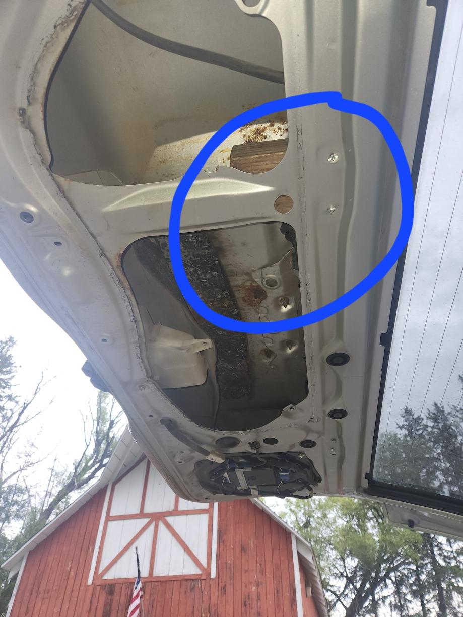

I purchased my 05 4runner sr5 in 2020. When I got it the rear window wouldn't roll down, wiper didn't work, along with the defrost. After 2 years of searching I finally got the wiper and defrost to work by resetting the relay.. I took off the panel on the tailgate to see what the issue with the window was. I attached pictures of what I found. Basically from what I'm guessing is previous owner had issue with the window mounts if that's the right term. They screwed in 2 blocks of wood to hold window in place. My question is what do I need to replace to have the window functioning?
