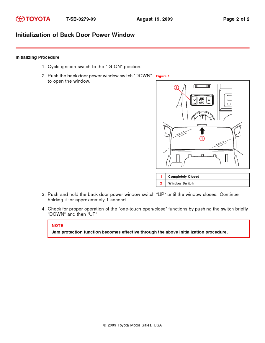

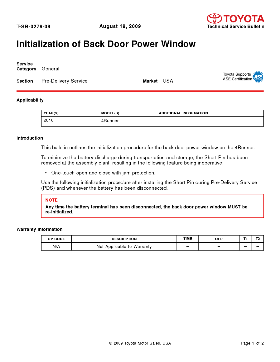

That's kind of wierd that so many are not going down the whole way lately. I'm wondering if these back window regulators weren't initialized correctly at the port or the dealer. They come across the pond with the short pin fuse uninstalled so the battery won't go dead and are supposed to be initialized as part of the pre-delivery service. There is actually a ECU for the back door.
After they install the short pin they are supposed to roll the window down the whole way ,hold for one second then up the whole way and hold for 6 seconds per the oem repair manual.That sets the up and down limits for the regulators.The same thing goes for the drivers window and moon roof to reset jam protection,especially if you put on deflectors. This SB I found describes it a little different.
