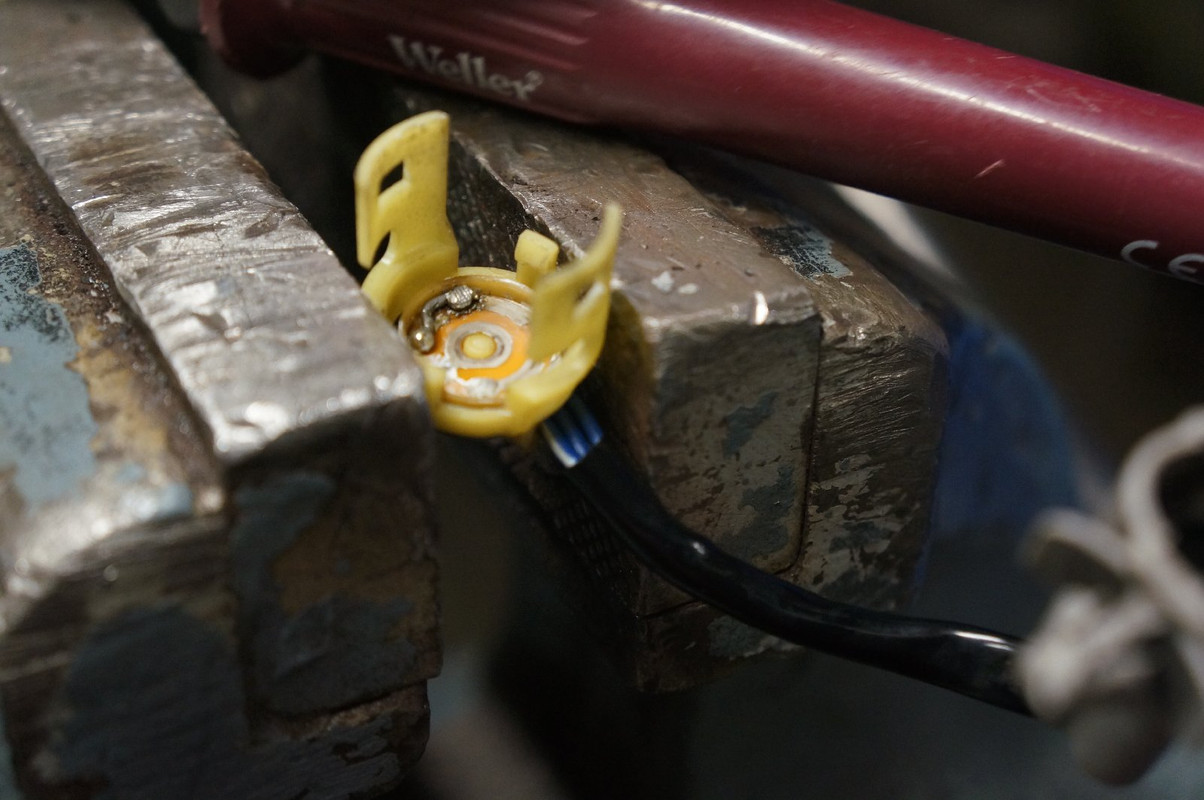

In my case, the problem was the little plastic that pops on the key cilinder. There is a VERY thin metal ring that provides the 12v connection when turned left or right. That thin metal layer was broken.
As you can see in the picture below, there is a little crack in the LEFT half of the ring. The black cutout on the RIGHT is normal.
I did a quick and dirty fix until i find a new one. It's holding up so far.

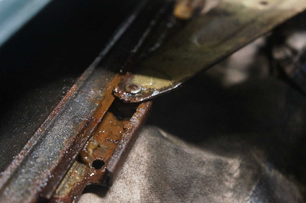

When you're at it, please clean the rail, that big spring (that's what's making the squeeking noise) and everything else. I soaked it all in WD40, let it rest for 15min, cleaned it out, did it again and greased it all with ceramic grease.
It was a 4 hour job but it was worth it.
