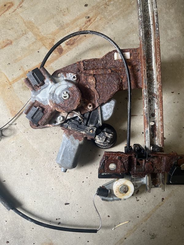

Pulled out the window regulator over the weekend. It was all rusted and the cable was frayed. Had some trouble with a couple screws being seized and needing to be drilled out to be removed (thanks to a neighbor). Got a new regulator at the dealership and got it installed. Luckily the motor was fine as that is an expensive replacement. I cleaned out a bunch of dried in mud in the bottom of the lift gate while I had it all taken apart. Also, once it was all back together, I had to re-learn the motor. Found a thread on here in 4th gen forum, that talked about that, otherwise it would auto go up but then come down a few inches, like the pinch protection was being triggered. If we hadn't had to drill out a couple screws it wouldn't have been too bad to replace.
Picture of the crazy amount of rust that caused the problem.

why so much rust, like it filled with water and drains were clogged ?
Rust belt..:)
I am afraid to look at my 2013 Trail rear window.
I rust check it every year but the salt from the roads in East Coast Canada take its toll.
My 2003 regulator looked like that after 10 years
So I’m thinking about putting some fluid film or similar in the bottom of the lift gate. Anyone else do this? I really can’t think of any way to keep this from happening again to the regulator. Water drips off the window once it gets below the trim piece and onto the regulator.
