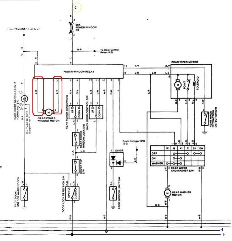

Inspect wiring on flex harness between tailgate and body.
If both console and key switches roll window up, and both also cause the relay click but do not consistently roll down, I suspect:
1) One of the wires enclosed in red below is broken. One is Blue-Black, the other Blue-Yellow, OR
2) Relay does not properly switch up and down circuits. To test this, probe pins 1 and 3 for voltage. On UP direction you should get 12V on DOWN direction polarity would reverse (you will read -12V)
More details here: RAD4Runner's 1986 4Runner dlx Build-up - Page 40 - YotaTech Forums

How about using the keyed switch at the tailgate. Does it operate correctly?
Dont forget to make sure the wiper motor is in the parked position.
If not it will prevent window operations.
Mine used to be intermittent due to this issue.
When you mentioned your problems began after operation of rear wiper triggered my memory!
