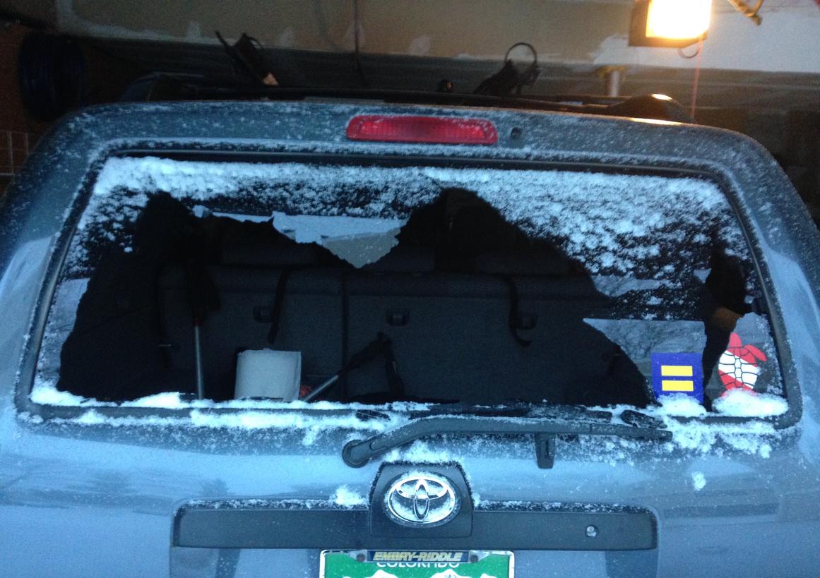

This describes what happened to me yesterday. Added issue is that the glass pieces affected my ability to open the liftgate (it's closed and can't be budged). My 4Runner is in the shop right now, looking at $450 to $750 if the liftgate motor needs replacing.
I've noticed that people posting on this forum were going to report their glass issues to Toyota. Anyone get a response? Does Toyota cover part of the cost? I haven't seen any recalls regarding this.
I just had this exact something happen to me. I had turned on the defroster and it had only been on for maybe 10min. There was a funky burning rubber smell then BANG, it sounded like a gun went off in the car and the window exploded into the back! Fortunately, my dog was laying down in the seat and not in the back. I contacted Toyota and all they would tell me is that there wasn't a recall and I must have damaged it. I explained that my vehicle has never been in an accident or had any damage, then they just blew me off since it was't under warranty. Thank god I have glass coverage with my insurance!

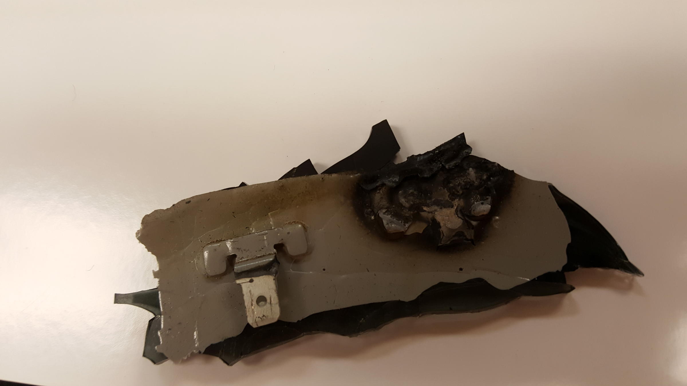

Poor Design
There is no doubt that there is a design flaw with the glass!! The defrost is what is causing the glass to break! I would imagine that the post on the glass has worked itself loose and caused the short!

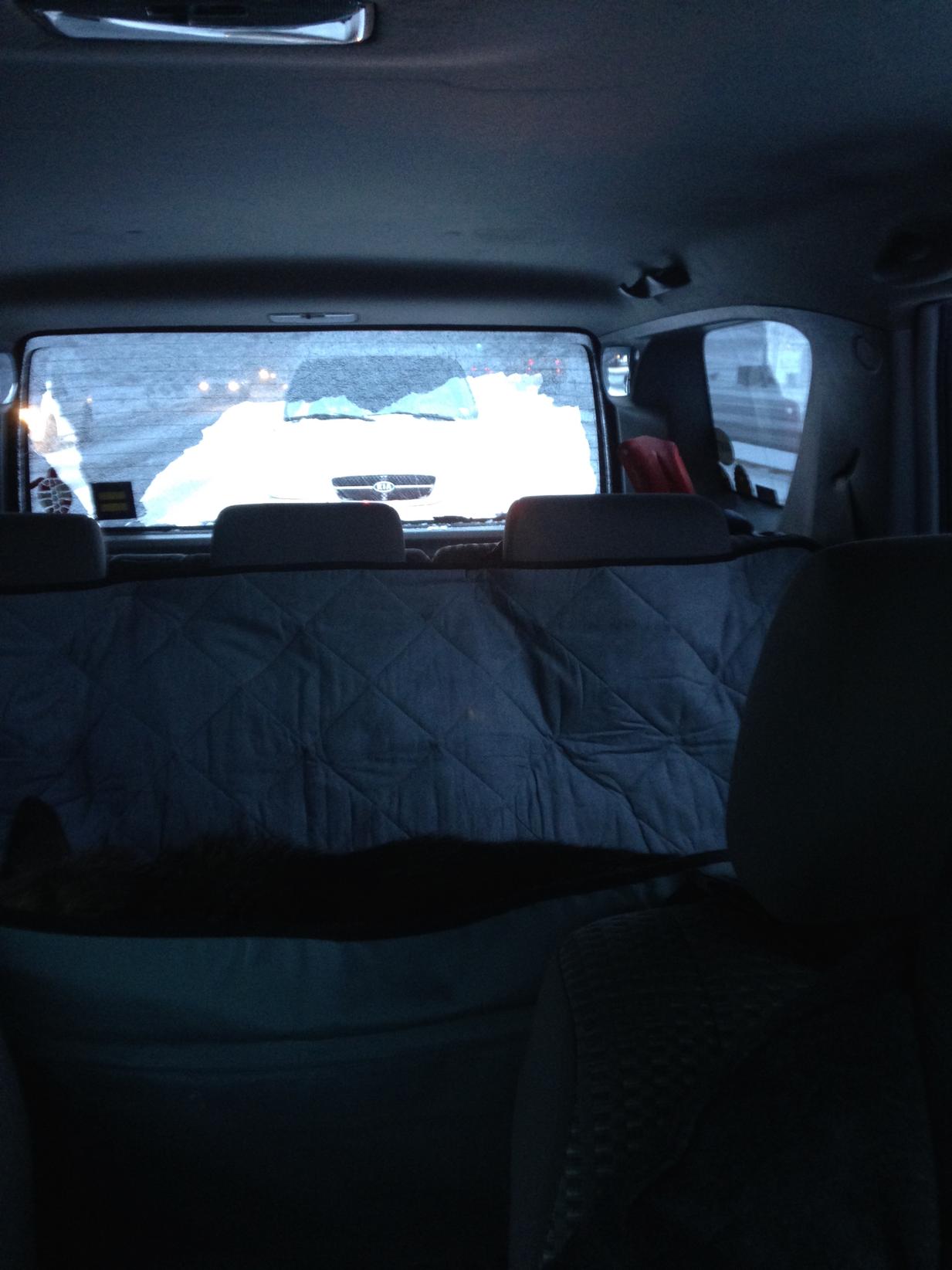

This makes me want to manually disconnect the rear window. The mirror deforster is so useful and I don't want to lose that function.
How easy would it be to access the line that feeds the fear window?

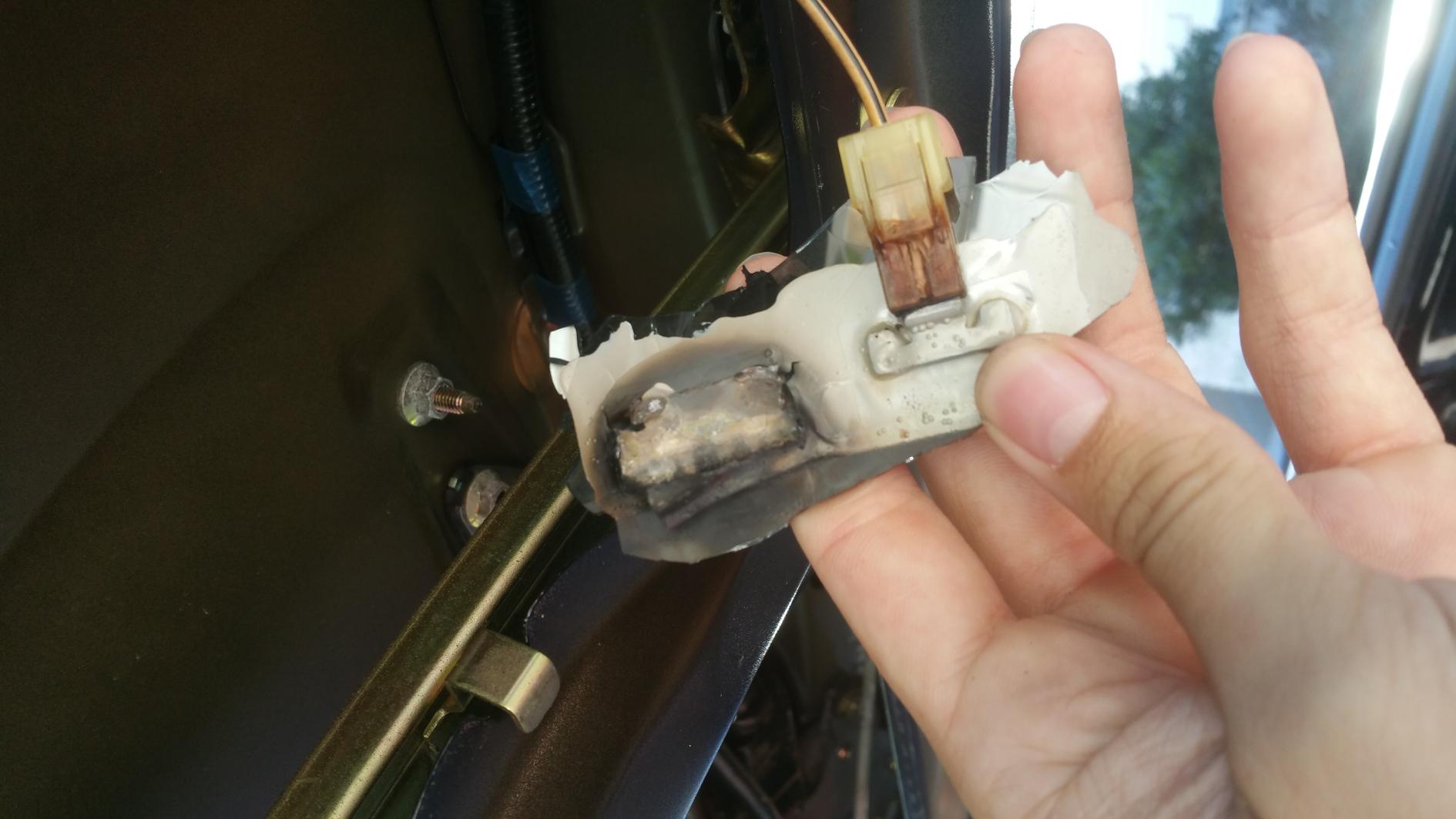

Adding mine to the slowly growing list. Safelite fixed it yesterday. Where the defroster connects to the window is charred.

Tex: It seems like most people experiencing this discover after the fact that the defroster was/is shorting where the wires attach to the glass. My only thought on preventative is to check the connection for any damage, clean it well, and give it a healthy dose of dielectric grease to ensure a nice positive connection. You'll have to pull the interior panel off of the hatch, so you might as well replace the exterior hatch release button rubber while you are in there...

I smelled electrical, but thought it was a car's toasted brakes (on a mountain road, stuck behind people riding their brakes, so that's fairly normal). After hopping on the freeway and going a mile, BOOM. The entire thing exploded. The connectors to the glass were charred and had "that odor", so that definitely looks like the cause. It's surprising to see such a dramatic failure from a bad connection.
