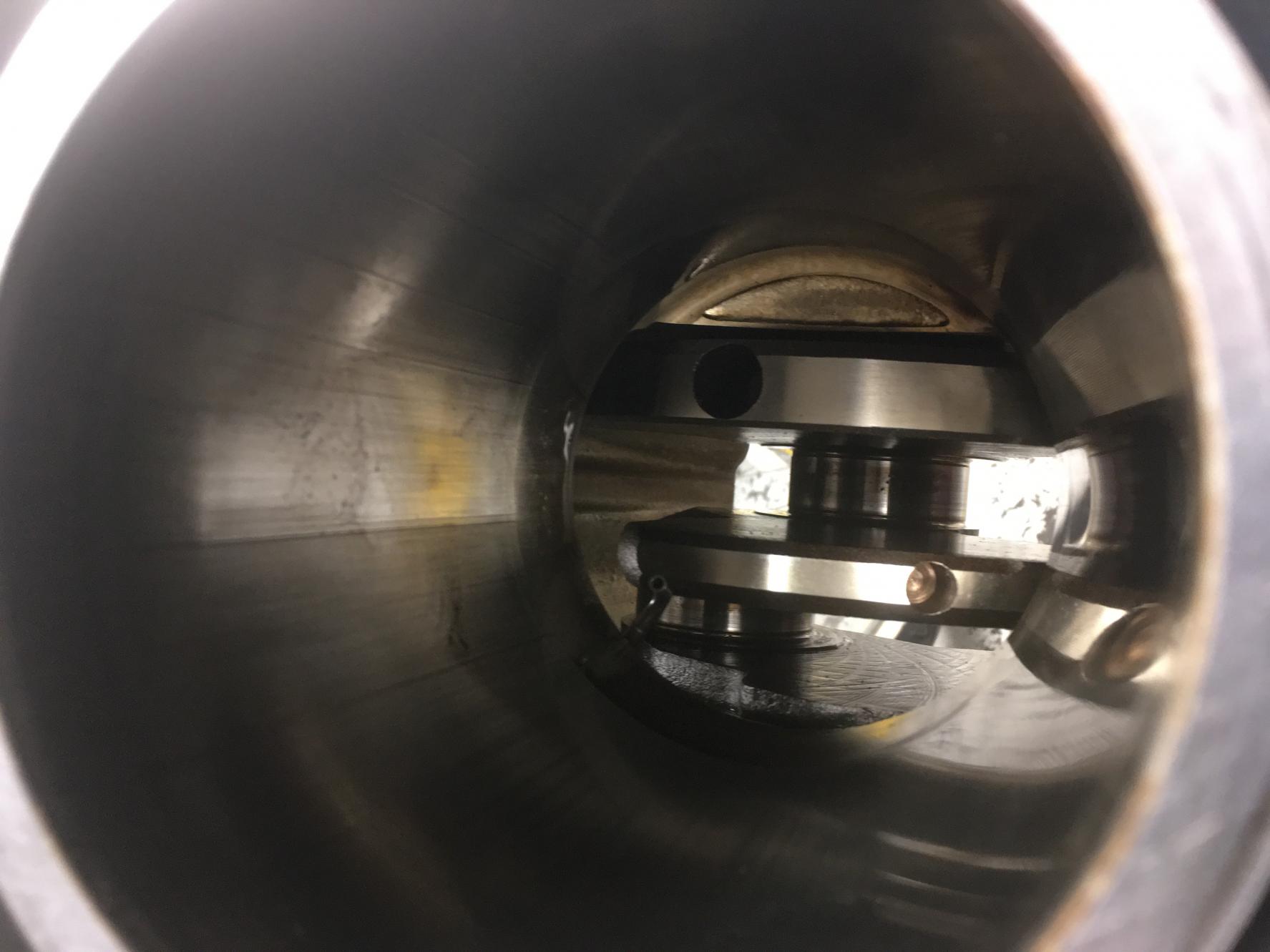

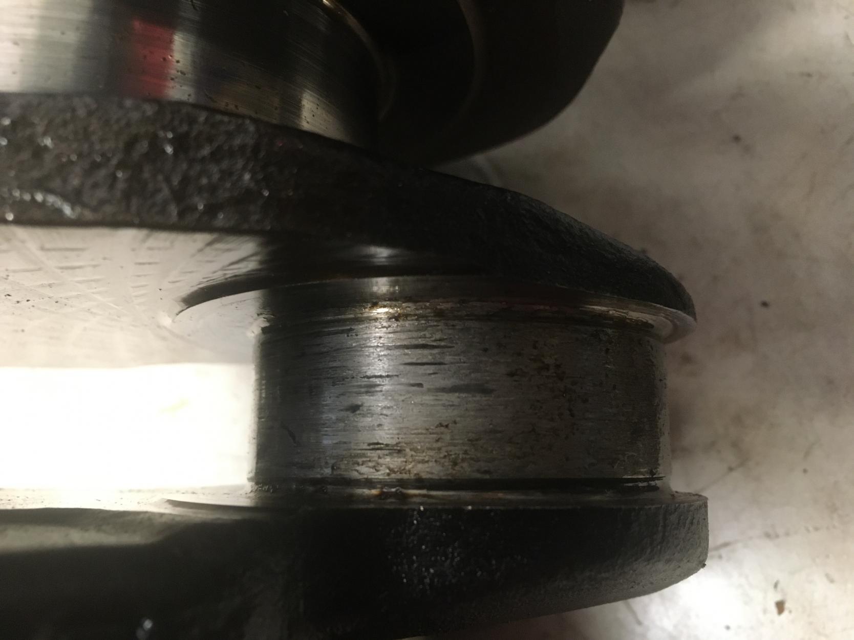

My son's 2008 V6 4.0 spun a rod bearing. I'm now starting the process to try to rebuild. The truth begins tomorrow when my machinist tells me if the block can be salvaged (bored).
4.0

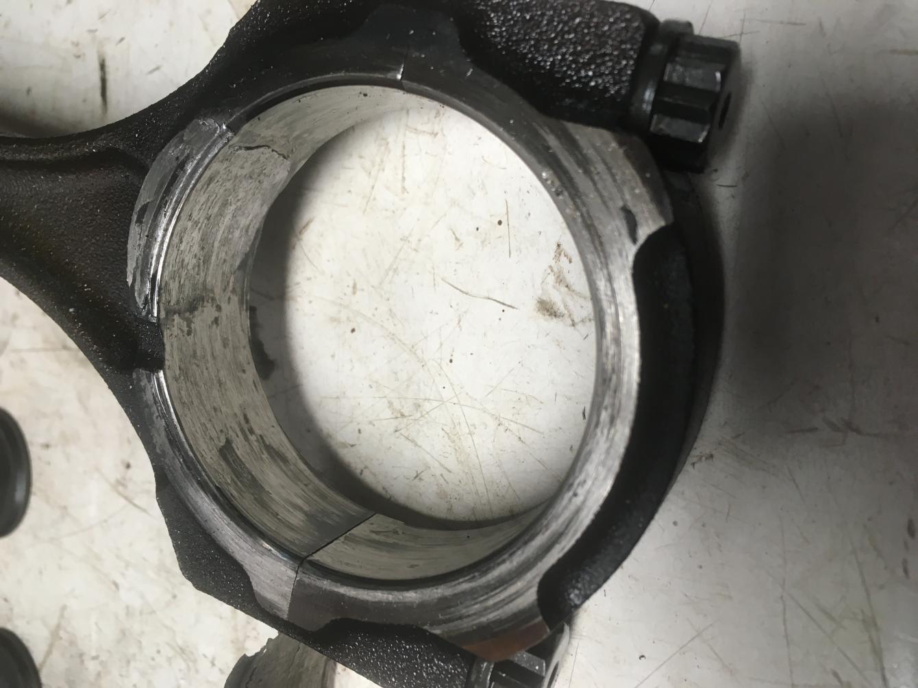

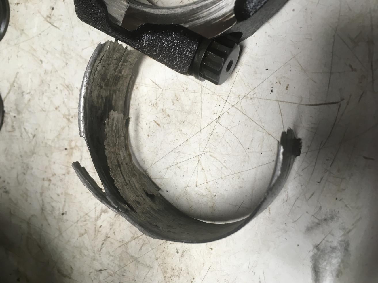

Almost caught it before damaging the rod cap. I'm pretty sure the crank can be ground but I'm not sure how or if a rod can be salvaged. Does anyone know a good source for used engine parts?

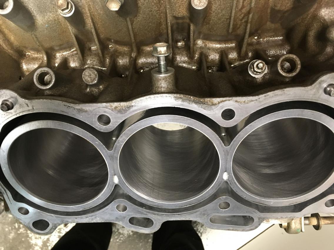

Dropped off the block today. My only choice of oversized pistons is .020 so lets hope it cleans up. Ordered pistons & rings should be here Thursday and the shop can fit.

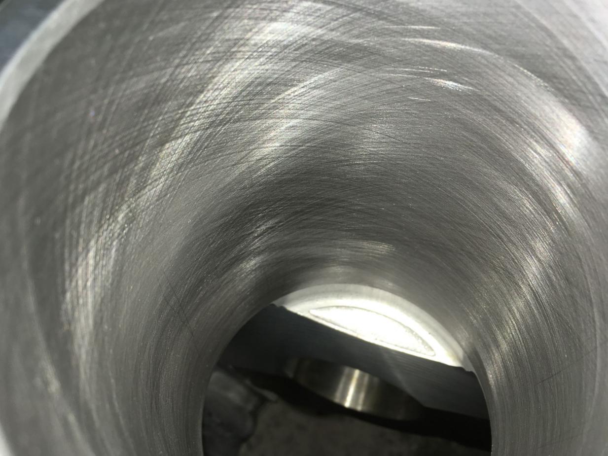

Still waiting on the crankshaft but I did get the block after boring .020 oversized. Clearance with the new pistons .003

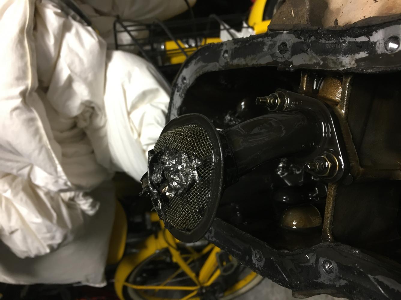

I think the material in the pick up tube screen is bearing material. The oil pump looks fine.

The rod, I think I could have honed back to size but it blued slightly and one of the bolts doesn't thread in with ease. Its the only one and its not the bolt.
All cap and rod torques seemed ok.
