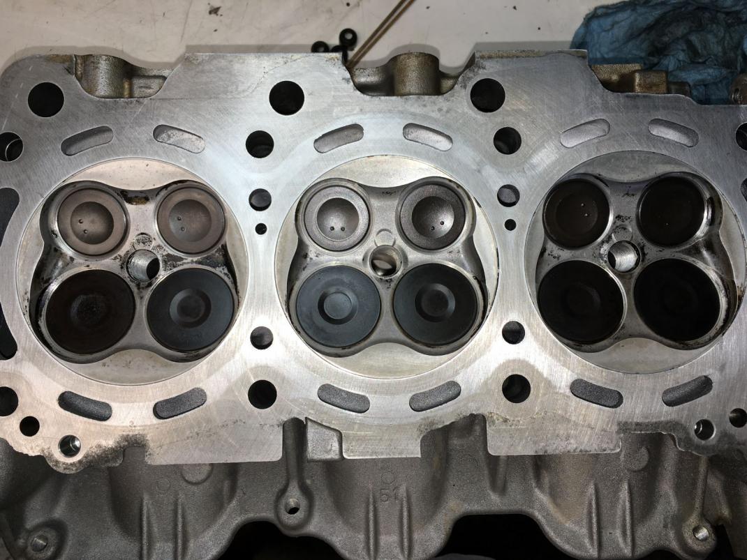

OK, I knew once I had the exhaust valves and seats machined and I'd need to play with the lifter clearance, so true, ~ .003 difference from the minimum clearance of .011.
The intakes, 11 of 12 were right in there at .008.
I ordered several new lifters today and hopefully by the end of the week I cn button up the heads.
I also did a leak down, The LH was outstanding between 8-10%. RH #3 one of the exhaust valves needs be lapped again. I hope its nothing more than that.
Slowly

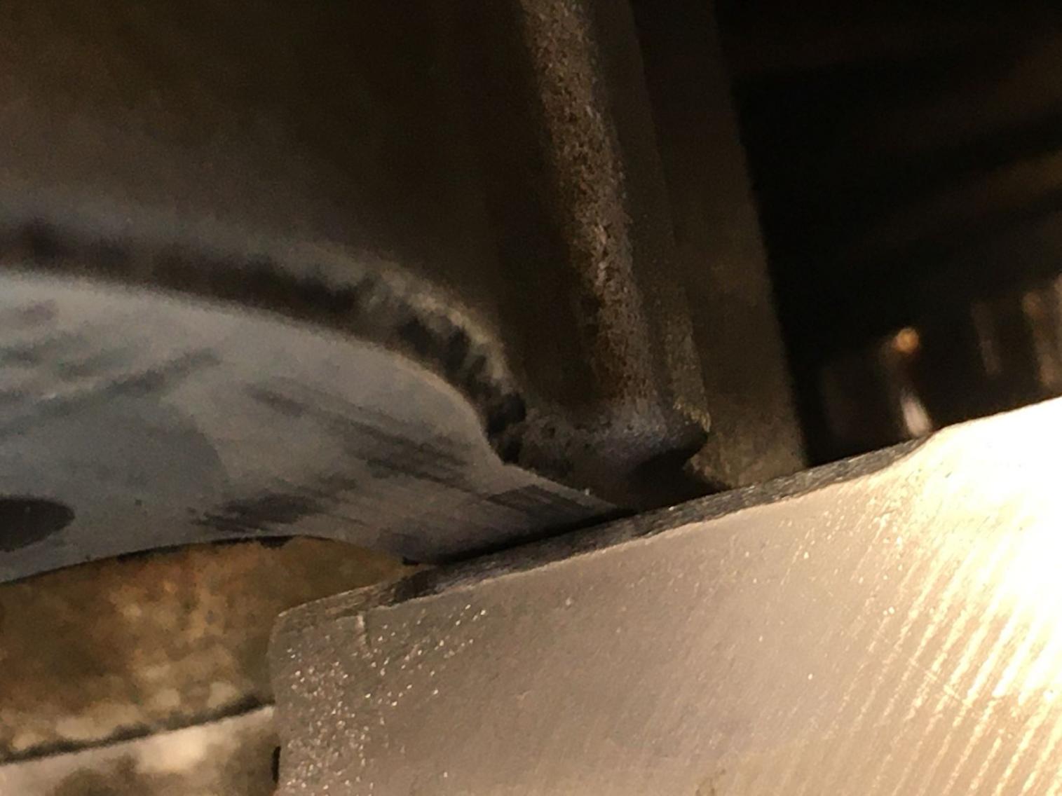

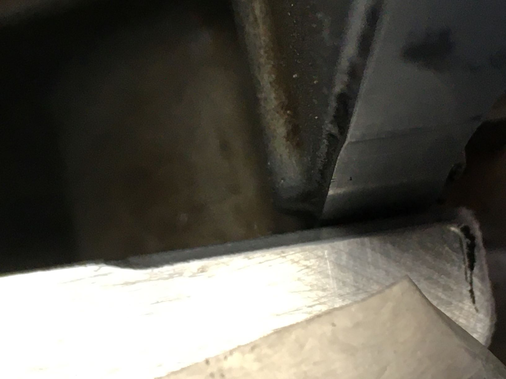

Wow, 6-bolt mains? Did you figure out the bearing notch issue?
The used bearings (may not be original)also did not have the notch so I made sure they were oil free on the back side and snapped in place.

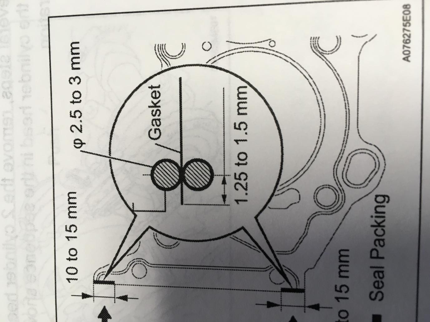

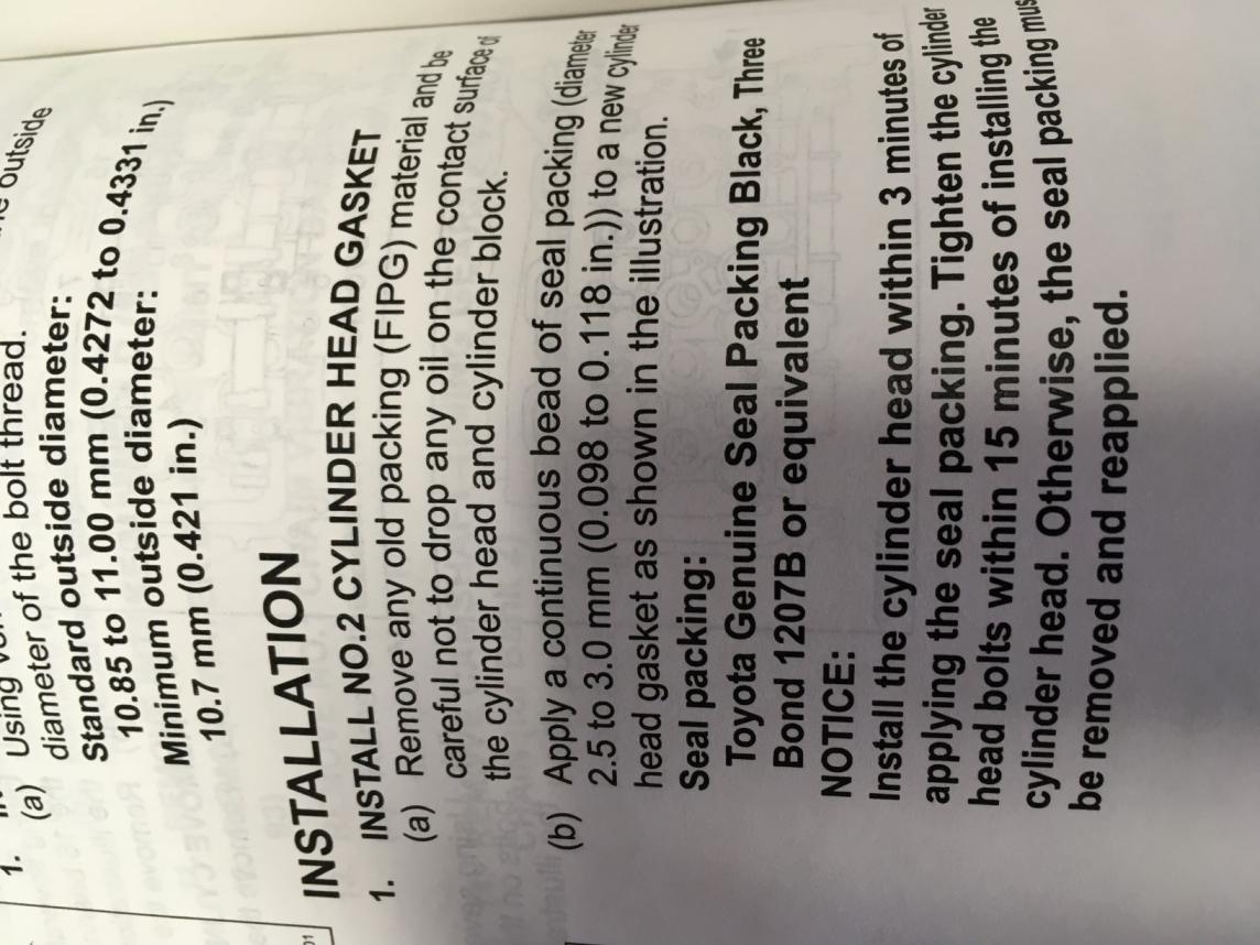

Did the final clean on the block and head and I think I'm final ready to install the heads and move on, NOT. I figured I should do a read of the FSM to see if there are any things I hadn't thought of and I find I need to use ThreeBond 1207B to the front edge of the head gasket prior to assembly, damn.
I don't see why it needs to be applied at this stage.
Ordered the ThreeBond on Amazon and I wait another couple days.

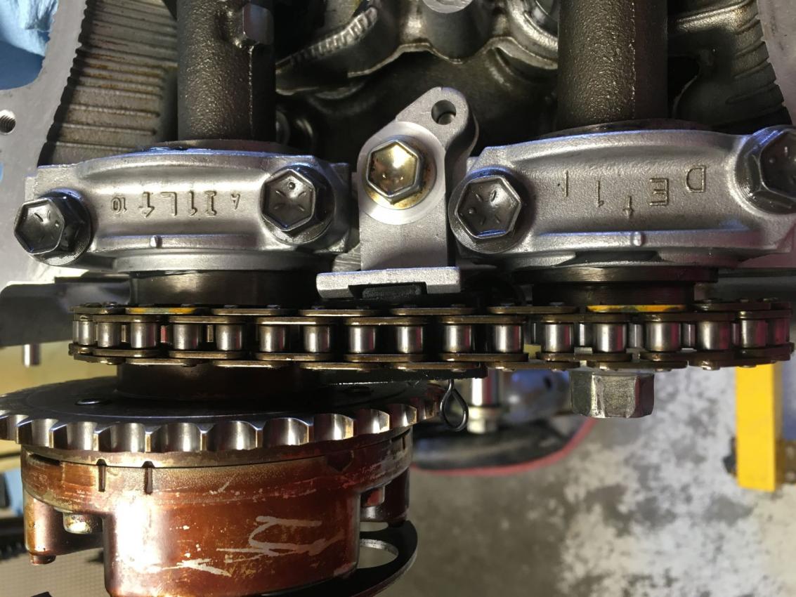

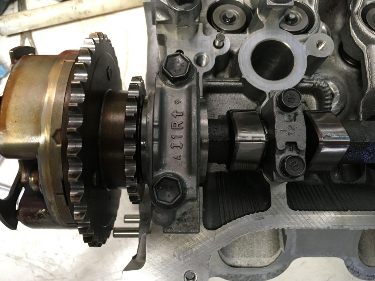

Still trying to button up the timing chains and get the new oil pump completed. I went with the Cloyes chain and gear set. I've used Cloyes before and never had an issue. I usually stick with OE parts but this time I was thinking more short term. I would have spent well over $ 600 for the OE parts.

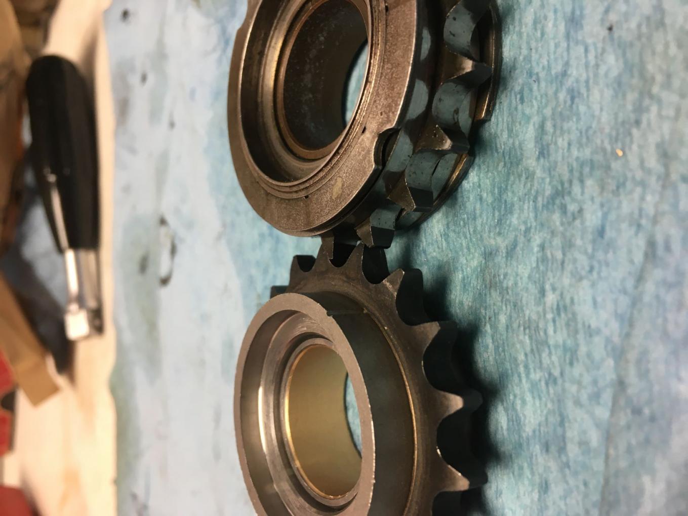

Now I'm paying the price and waiting. The left tensioner didn't align with the chain and the idler gear was missing parts.
I hope the replacement kit and the OE oil gear arrive today. I'd lke to get the timing cover and oil pan bolted up. Then its straight forward to install.
One big caution--- remember to install the coolant tubes and knock sensors before the head install. It's a painful lesson if you try to install after the heads are bolted up.
The jacked up tensioner and the idler gear

Cloyes said the idler gear assembly was redesigned after they had failures with the oil rings so I stayed OE.
