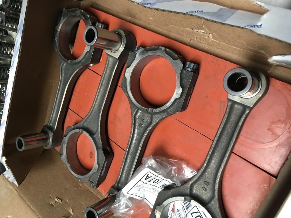

replacement rod - $106

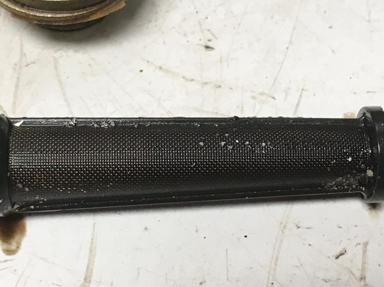

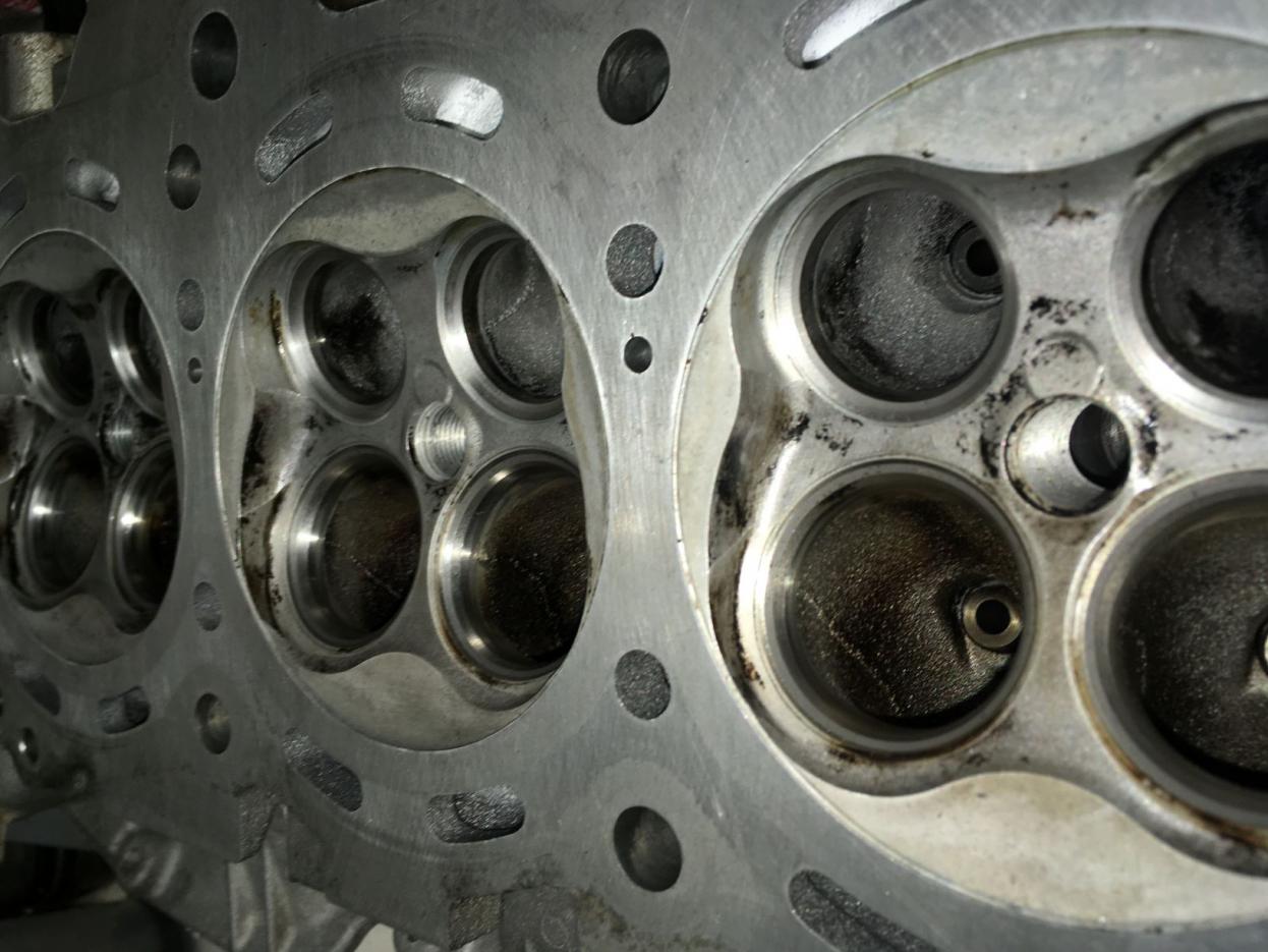

Lots of shiny stuff in all kinds of locations. The VVT filter collected a few pieces from getting into the VVT controller and saving the cam caps.

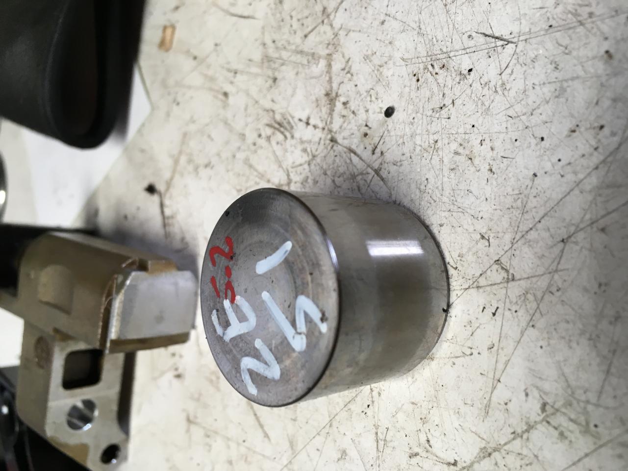

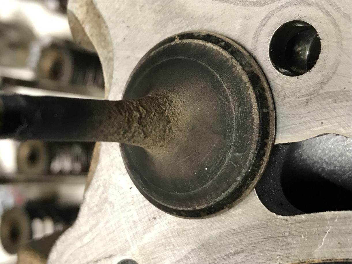

I was hoping to simply hand lap the valves after a very good cleaning but no luck. The intakes (IMO) look good and lapped nicely to the seats. The exhaust valves had too many pits even after lapping. My local shop charges $75 to grind the seats. They'll also grind the valves and then I'll do a final lap.
I haven't soaked the head yet.

Valve job seems like a deep rabbit hole, considering the resulting change in cam lobe clearance and the parts needed to adjust it. I dealt w/ this on my prior '03 Tacoma 4 cylinder, which had hardened shims on top of the buckets and no need to remove the cam to change them. My understanding of the 4.0L is that the entire bucket is replaced to adjust clearance.
That's fact, I only had to grind the exhaust valves so in theory I'll have more of a challenge with 12 buckets. Believe me that crossed my mind too many times before I pulled the trigger on grind the valves and seats.

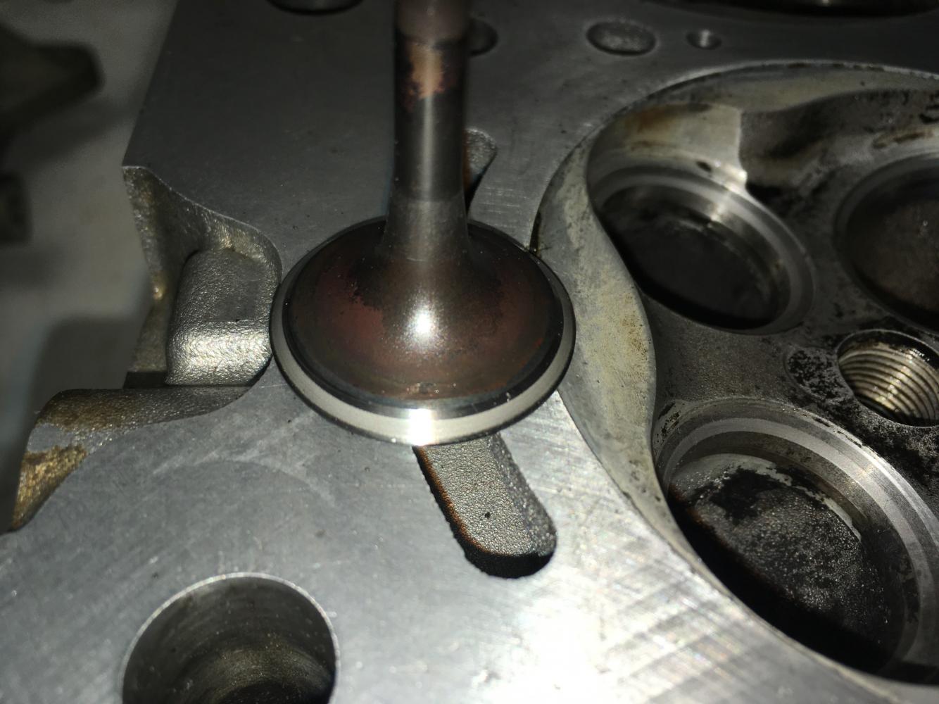

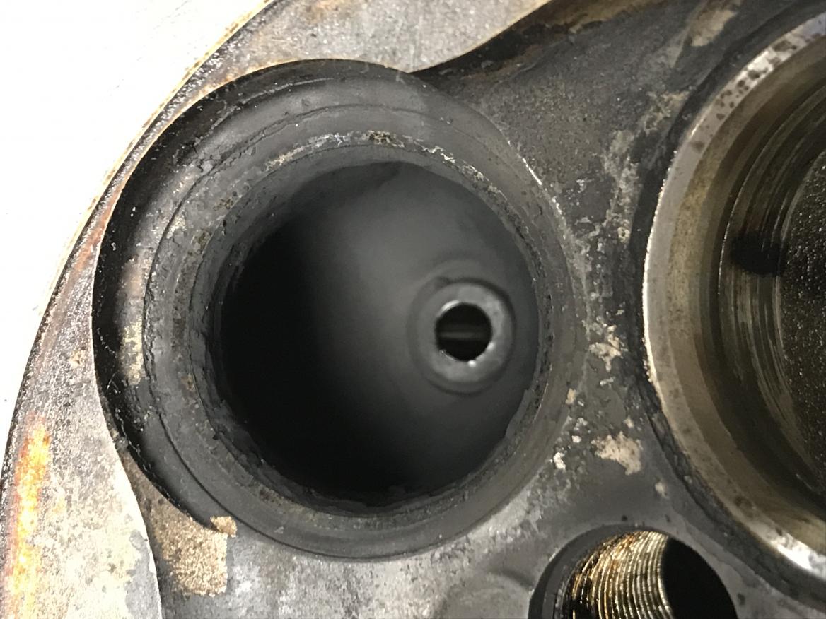

The valves and seats are lapped and ready for reassembly. Heads are cleaned (less some staining) guides clean. Cleaned out all of the oil passages and polished a couple caps because of the dirty oil. I cleaned the cams and VVT controllers and they seem to work fine.
My plan is to assemble this weekend and hopefully the lifter clearances can be set with the lifters I have. $15 a lifter can get expensive.

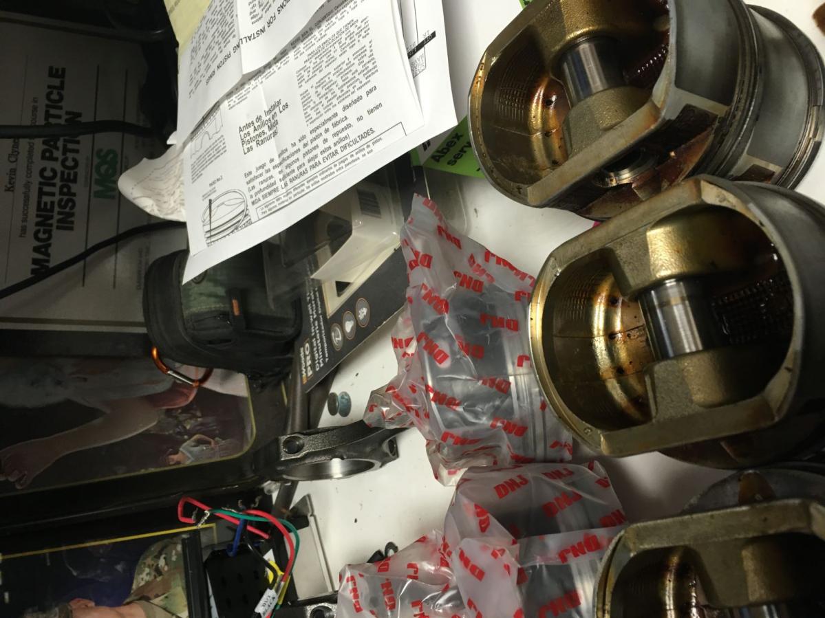

New wrist pins and bushings, the shop had to hone to the correct fit.

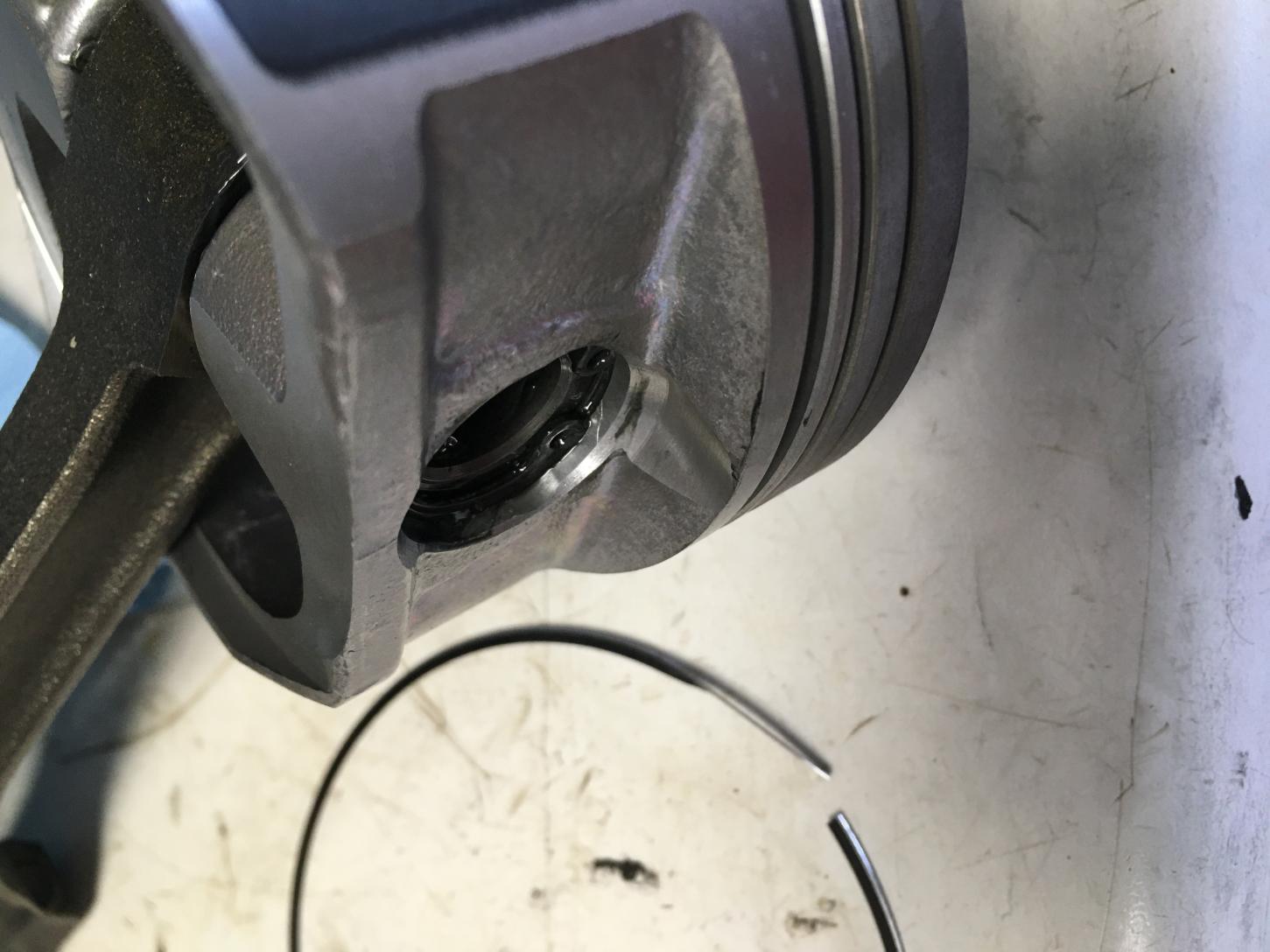

screwed up, can't remember breaking a ring before but I did this time. $49 mistake. 5 in with no problems now its time to wait Tuesday.

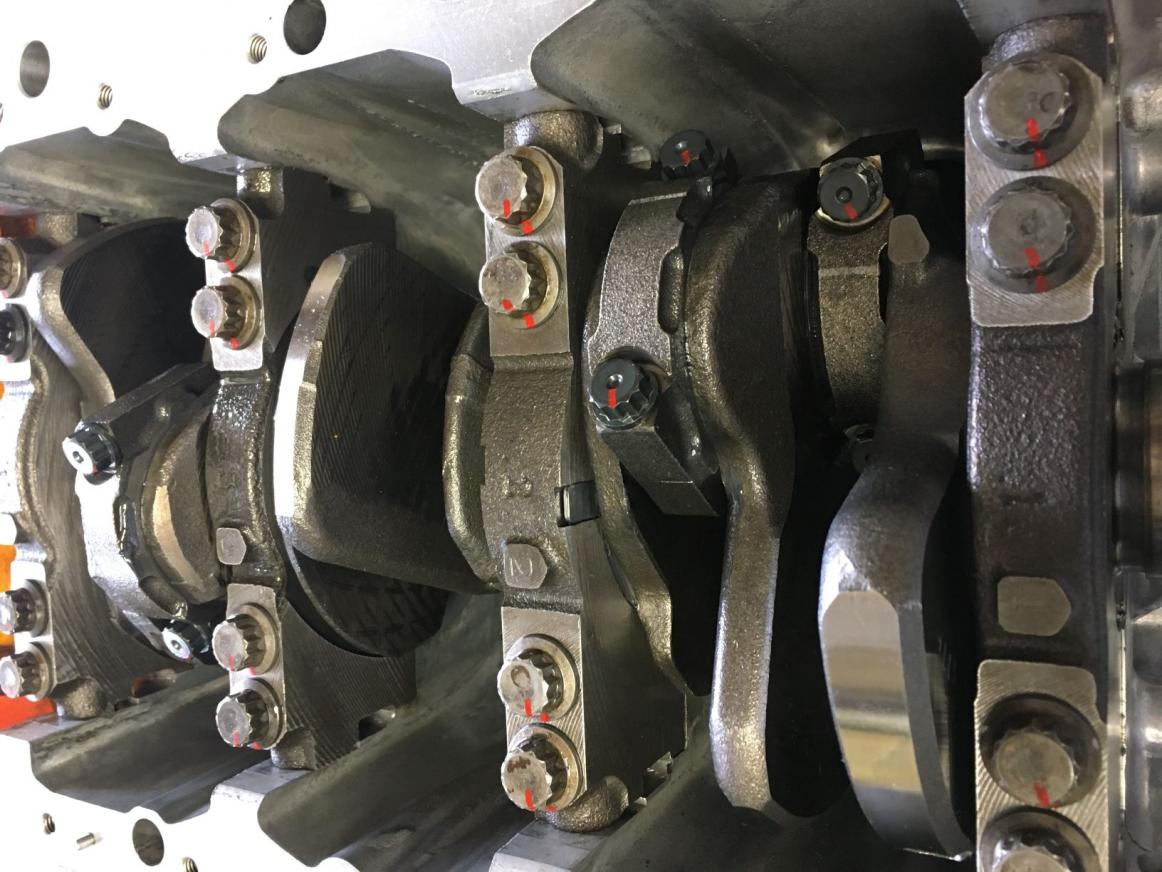

Torqued mains and rods just waiting for the replacement ring to finish # 6

expander, the upper oil ring must have caught the edge of the ring and didn't sit as I pushed into the cylinder, my fault. The others went fine.
