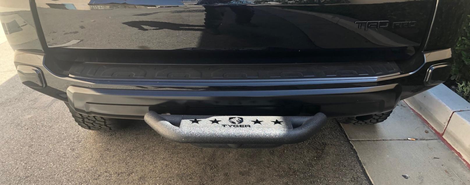

I keep my hitch protector there. It is technically a skid plate for front hitches. But at 1/5 the price of rear hitch offroad skids, it does exactly the same job offroad.
I have used a recovery insert successfully for the same purpose, but I feel this is better offroad and easier to see on the vehicle. I don't recall having bumped into it.

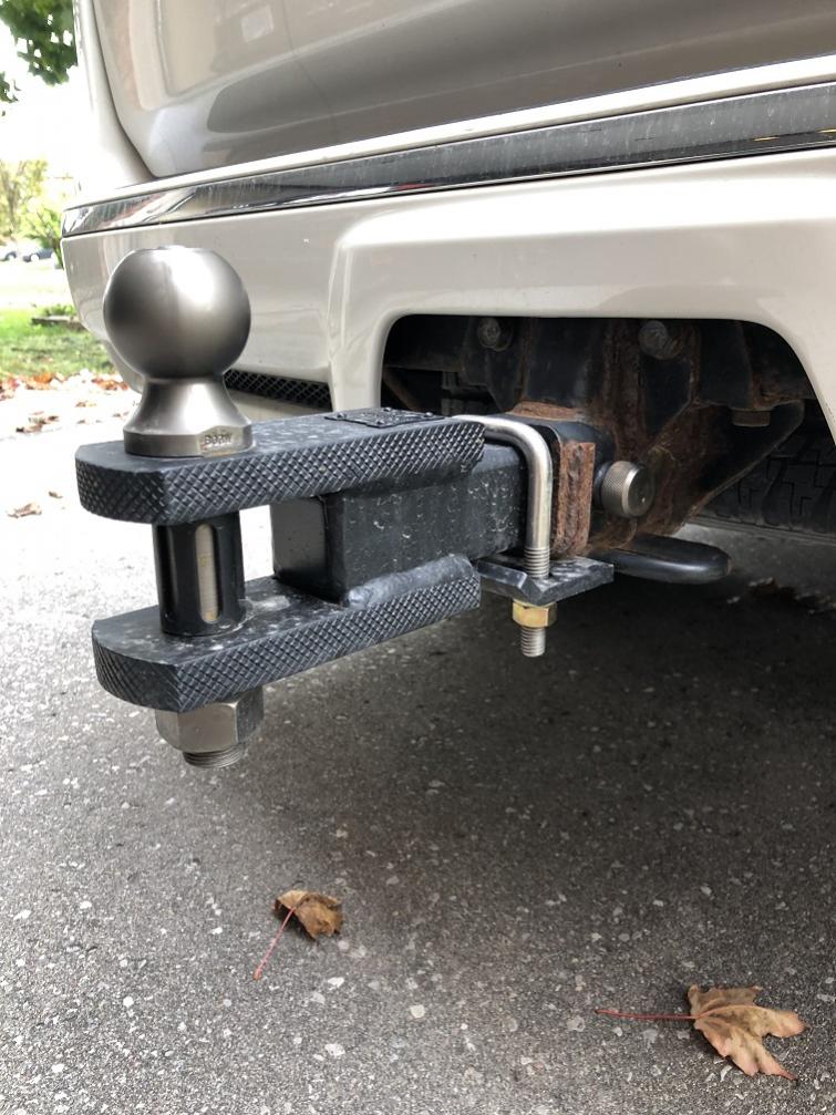

I have this bad boy in right now. tow ball, step and recovery hitch in one - stays in all the time. Weighs about 15lbs and is solid as a rock. 10,000lb recovery capacity, 7,500lb tow capacity. the steel around the clevis actually rotates to reduce friction on tow and recovery straps. very convenient for anyone who wants to tow and not have to swap out their tow ball for a standard recovery hitch all the time. the serious offroaders won't like it because it's heavy and does reduce your angles a bit. the ball itself is probably high enough for most applications and utility trailers. most trailers have a tongue height of 18-20". the 4runner will squat a bit under load so this would be pretty close. it's made by reese, there's an adjustable ball mount version but that kills your ground clearance since it's a 5inch drop and would rattle a whole lot
I haven't had to really test this yet but I suspect this winter I might be pulling some people out of snow banks with it
