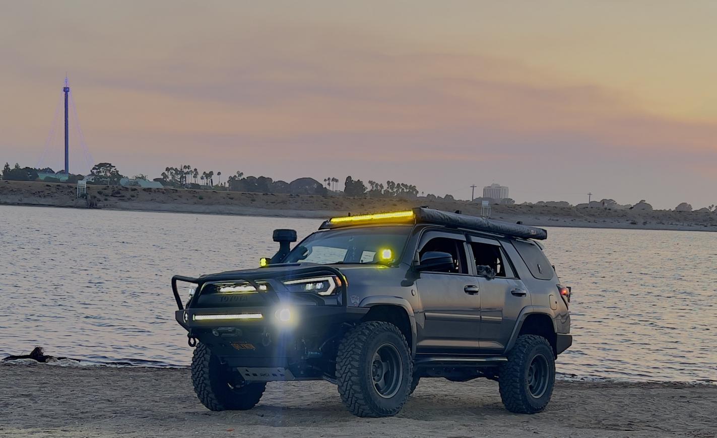

Tires (size/style): 34 inch Geolander MTs
Lift (size/brand): all the suspension but built around 2.5F/2R kings
Gearing change (Y/N, type): 4.88
Front locker(Y/N): ARB
Rear locker (Y/N):stock E locker
Swingaway(for which gear): Shrockworks dual jerry and spare tire
Roof rack (y/n, for which gear): Prinsu, for awnings
Rear loadout (setup/overall gear): dobinsons drawers, Rago Molle panels
Spares(what parts): None..i carry a glock,
Camp setup(RTT, Hammock, Ground tent): old gazelle t3, because it fits in rear passenger footwell or on the roof.
Armor(type): All the armor, but aluminum in the front of the vehicle and steel towards the rear.
On-board air(y/n, type):ARB single
Winch(y/n, type): shittybilt x20 w/ yankum rope fairlead.
