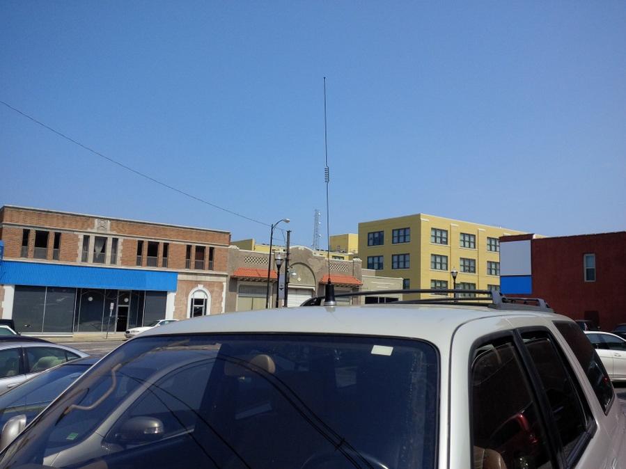

As mentioned above, a permanent NMO mount in the center of your roof will give you the best ground plane and the least amount of loss. I run one on my roof with a Larsen 2/70 and it performs very well. It has taken tons of abuse and I still have yet to have any issues.
I also have a fender mount with a Larsen 150 hooked to my icom 521 and it works well, not as good as the roof though. You want to avoid mounting it to the rear bumper at all costs, you'll experience tons of loss.
Not the best pic for this, but this shows my antenna setup.
