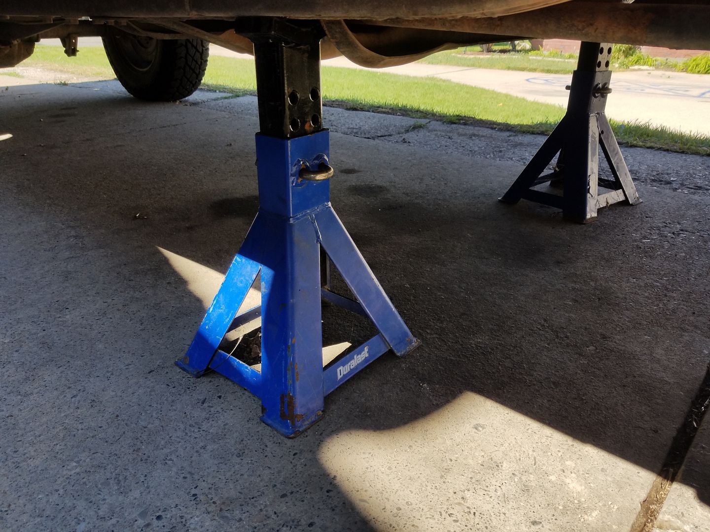

I use these.
20160925_1355191_zpshmuuw0jj.jpg~original
Probably not as convenient, but I like them better than the style with the quick release latch. Being under several thousand pounds of metal weirds me out anyway, and I've heard stories about those quick release catches failing. I prefer this kind for it's 100% positive engagement, but they're getting harder to find.

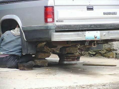

Be exceedingly careful putting a jack or jack stand on wood. Wood is soft. If the vehicle gets off balance the wood could give enough to let the jack stand roll. Cribbing under a bottle jack is slightly safer, as the vehicle generally has three tires on the ground and is mostly stable, but if you're putting two or more tires in the air, best to use the right height jack stand in the first place.
And don't EVER use a cinder block. Not ever. Those things can explode under the weight of a vehicle without any warning signs, and if you're under something hard when it happens you'll be dead, or wish you were. I'd go under a truck held up by a hi lift before I'd go under a truck on cinder blocks, and I won't ever go under a truck held up by a hi lift.

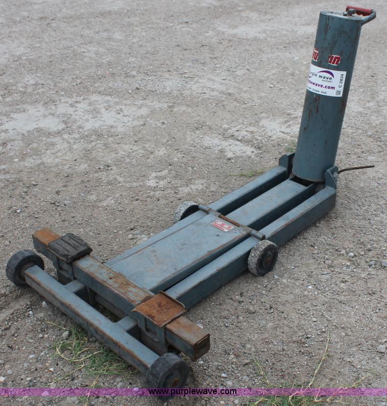

I have one of these; best $300 I ever spent. Picked it up on Craigslist from a local independent mechanic. Mine's in better shape than the one shown here - no rust. It's a Vulcan FL-32, no longer made.
It lifts from 6" to 27", will easily pick up one end or one side of the 4runner by the frame, is absolutely rock solid, and has 5 positive locking notches in its lift range. It does require 150psi air to work. It's purely air, no hydraulic fluid.
I still set jack stands under the frame as a backup if I'm going to be under the vehicle, but this thing has upped safety and convenience by a whole bunch.
