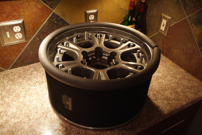

Recently I have been wanting to widen the stance of the 4runner a bit. Spacers would accomplish the goal, but I'm still not 100% sold on using a wheel spacer. It may still be an option, but I would feel far more comfortable with an actual wheel that fit how I wanted.
I started with ...
The factory 5 stars .... and like them, but got a good deal on a wheel tire combo and switched too ...
Then I decided to jump up to the FJ wheels .. partially for the look, partially for the matched spare and, partially for the ease of replacement if I wanted a 6th or really damaged one playing.
So .. since I have done zero research on aftermarket wheels of the 6 lug variety, throw out some opinions to help me please...
Looking for:
more aggressive offset than the FJ's
Simple design
NOT BLACK (lol just not feeling it for my rig)
nothing so expensive that I will cry if a destroy one some day
17" ... I just bought tires so going to a 16" isn't an option and 18+ just not my style for this vehicle.
So ... what would you do?
Since you're trying to avoid black wheels on your truck, I think that your best bet would be gunmetal. I had a hard time finding wheels that I really liked for my 4Runner, but some brands to look into are Level 8, Raceline, Pro Comp, ATX, etc. I just ordered some Level 8 Strike 6's for my 4runner last week (in all black lol) and I can't wait to see how they look. I think that you should figure out which color of wheel you want and then base your decision off of that. Black wheels are going to be a lot easier to find, but if you do some searching then you should be able to find some nice gunmetal wheels for your truck.

A lot of aftermarket wheels come in black or chrome or polished aluminum finishes. Polished aluminum & chrome are a PITA to keep clean due to brake dust. If you let them go long enough they start to corrode too. Silver, gunmetal and bronze are really the only other options I can think of, so choices are limited at that point. I think that's why I prefer the newer stock Tacoma/Tundra/ FJ wheels, as they are mostly silver and a couple polished aluminum finishes. The only downside is the backspacing, as there are no options to get a wider stance without spacers.
That said, Eagle Alloy or Pro Comp make a decently priced wheel, but the finishes are limited.

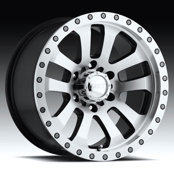

I like these Pro Comp (sorta remind me of the split spoke Tundra rims)
images.ashx

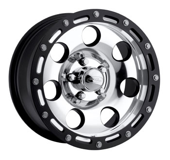

And also am partial to the Mickey Thompson Classic Locks
I prefer both of those wheels in black, mostly because keeping them clean isn't as big of a factor.

Not worried about keeping them clean, I'm not as obsessive about keeping the 4runner clean as some of my cars, but its pretty rare to go more than a week with out at least a wash. I do like the look of the pro comp.
