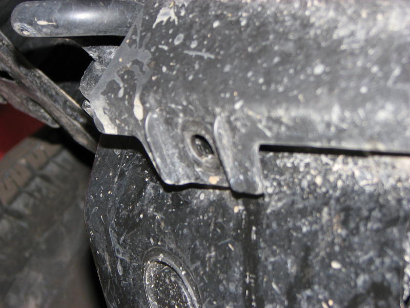

Just got back from the dealer for my first (5k) O/C. They wouldn't do an oil change for free as part of the Toyota Auto Care Prepaid Maintenance. I told them I already had opened a case with Toyota Customer Experience about this issue (true) and I'll be lodging an official complaint but will pay for the service today. I got "sorry, there's nothing I can do, I can't get authorization from my mgr on a Saturday" In the end I got $20 off of my $72 dollar invoice. I'll be calling Toyota this week.
On top of this, I just noticed they failed to re-install a bolt on my front skid plate. :mad:
