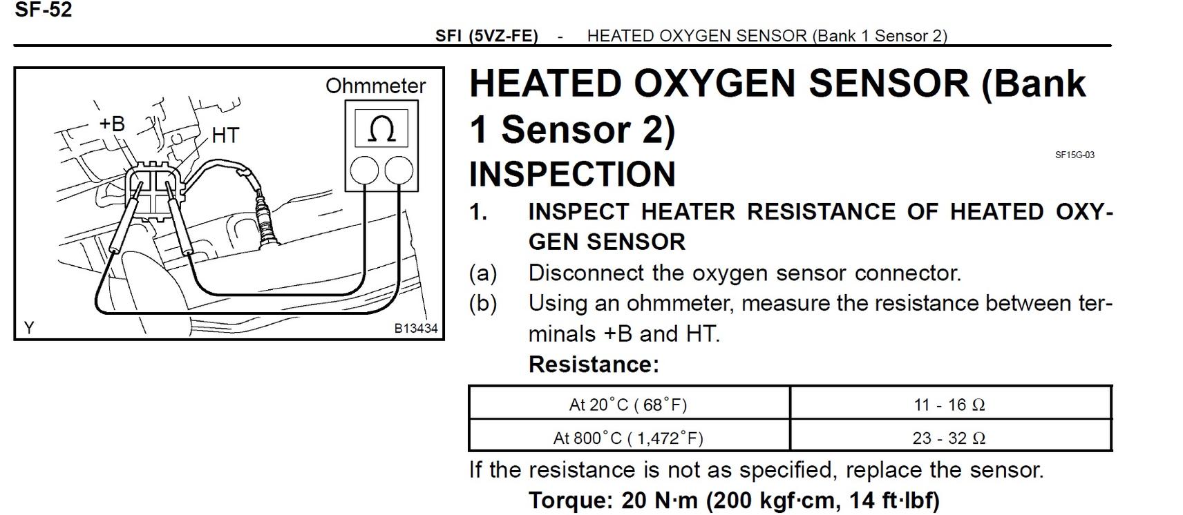

how can you test a sensor to see if its bad?
You can test it but I would definitely change the sensor before buying a cat.
I just had the same code on mine (2000 with CA emissions) and replacing the sensor fixed it. The sensor is about $50, compared to hundreds for the converter, and probably needs to be replaced anyway, so it's worth trying. A lot of places misdiagnose this code as a converter problem when it's just a failed sensor. Toyota used to recommend replacing them every 100k miles because they just don't last.

It's from the Factory Service Manual, there's links in the sticky threads on where to download them from. Absolutely necessary for any kind of major repairs but also nice for these small things.
