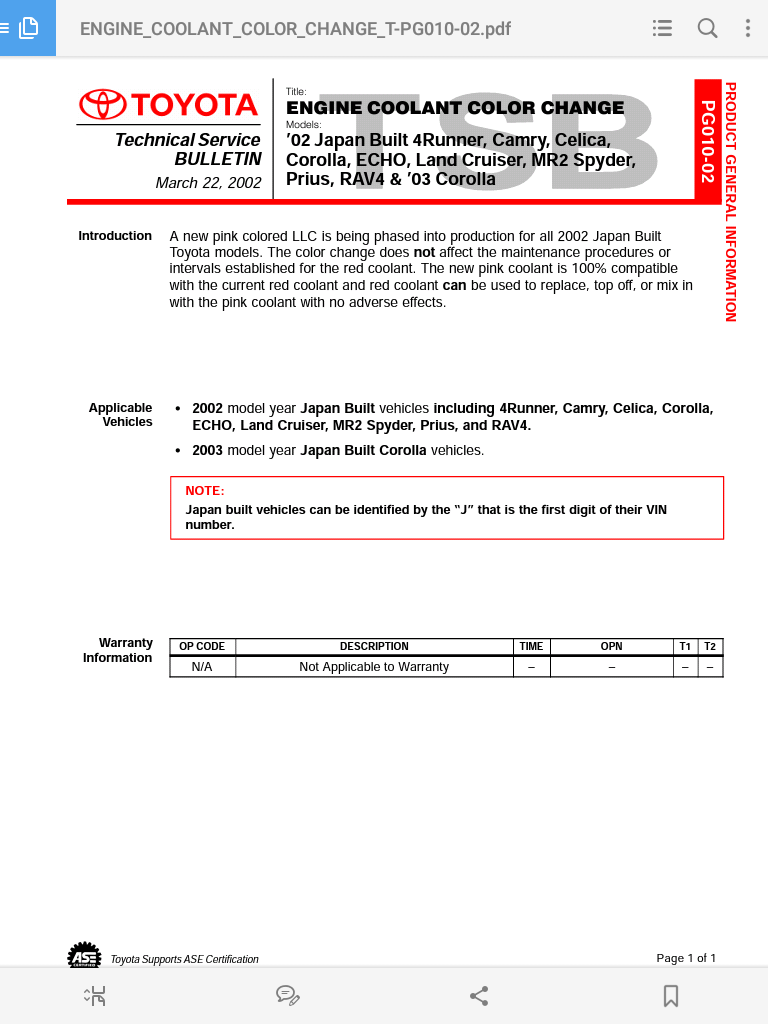

any downside of mixing a small amount of pink coolant with red coolant in the reservoir? I may have inadvertently mixed the two.
found my answer...
