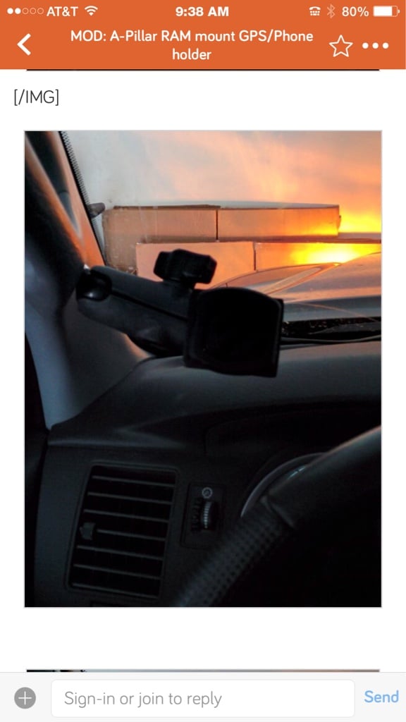

this is good idea for mounting the scan gauge. There is a write-up on tacomaworld. You replace 1 of the screws on the grab handle. Thanks for the info for lights, post photos when install is complete. Also, the headlight link for Amazon is for 1999+, it has a plastic lens & different back reflector. I don't think it will match your existing headlight for a 1996. Your existing light should have a glass lens.
Thanks for the link on that pillar. That might be a way better mounting spot, and where I originally wanted to put it, but the dash wasn't deep enough for the window mount. Based on the reviews they are saying this is a glass lense, but I will double check in the morning. It seems a lot of people have installed them on their pre-1999 4Runners. So I guess we will see once I install them. I can already tell this won't match because my driver side is a bit hazy, but I will post up pictures when I get it done.
