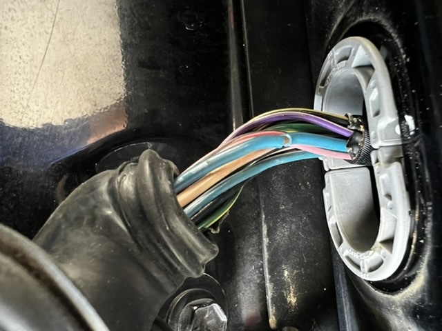

The Front Runner RTT quick release mounts paid off! 10 min install with the help of a friend this year. No adjustment needed. Simply incredible! Getting things aired out, batteries charged/replaced and getting excited. Fixed my drivers headlight housing where the pivot ball had popped out of its 20 year old plastic holder. Simply removed lamp/housing from vehicle, popped plastic clip out, placed over pivot ball and clipped back into housing. We will see how long this lasts. I also spent waaaay too much time trying to figure out why my third brake light wasn’t working. Found one cracked wire along the way in the infamous rear hatch area. Low and behold…I am an idiot. It is a third brake light not tail light! Once I tossed a dumbbell on the brake pedal I magically had current and simply needed a new bulb which I had laying around. Really felt dumb with this one…but I did find the one cracked wire and repaired it so it wasn’t all for nothing. 1st trip is next weekend!

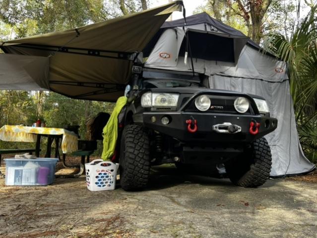

Big upgrade in shade coming!
Oh 270. I was looking into a different brand and the mounting of the awning would have to be high and I wouldn’t be able to install the L side of the tent because the awning would be blocking the hole for the poles.

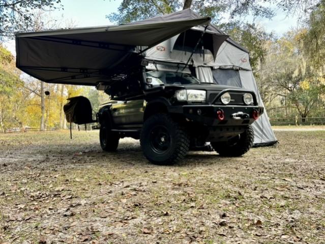

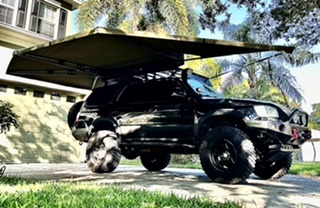

Bush Company 270XT Max awning install on a custom Front Runner roof rack. Pretty excited I can access my table under the rack and still open the hatch! Shade for days!!!
Did you source this locally or from South Africa?

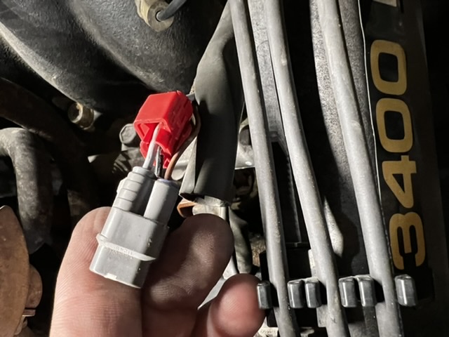

Finally got my first P0325 code for one of the knock sensors. I couldn’t hear any knocking and it only happened above 30MPH while driving and wasn’t reproducible revving the motor on the driveway after clearing the code. I already run high octane (sc’d) and had hoped I got a bad tank but it has been with me for multiple fill ups. It really sucks when the computer pulls timing and dumps gas….total dog. Had to stay out of boost and accelerate really slow.
So…rather than a half day of taking the supercharger and everything else off to replace the sensors and wire harness I jumped the wires and l hope for the best. Anybody done this and had a bad outcome? Hopefully I am not covering up a real problem…
