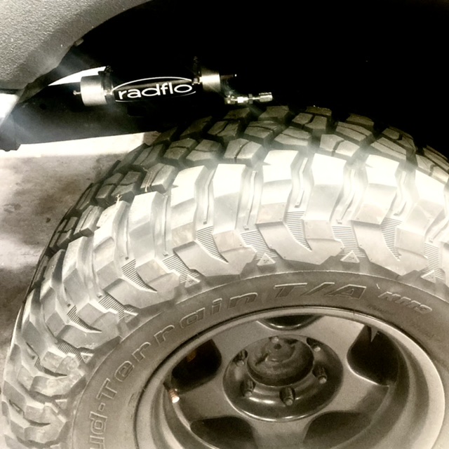

Radflo rear shocks in and transmission rebuild underway…more to follow.

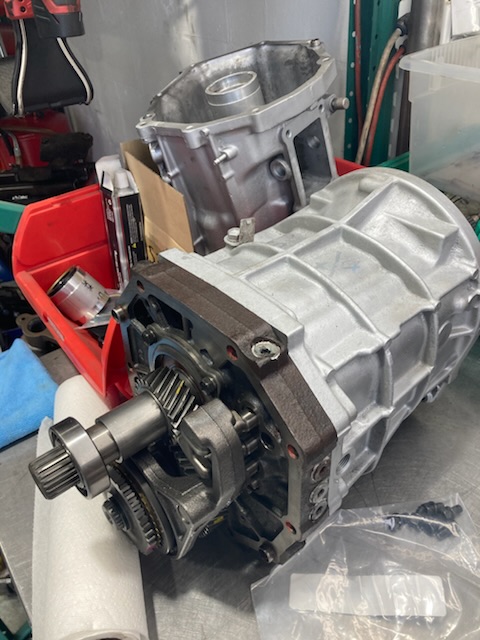

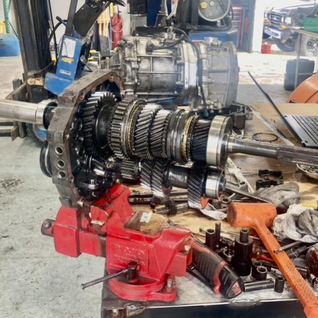

Wow, long time…let’s see. Not done yet but here is an appetizer. It was time for a manual transmission rebuild so why not R452 5th gear swap?!? Going to be sweet in front of the dual cases. I get all the off-road capability and finally an appropriate highway gear.

I've had the 5th gear swap parts in my Toyota drawer at work for the last few months. Just need to find the time to open up my brand new transmission and swap gears out. I'll get there eventually lol Let me know what you think of them. It should be close to 4th gear ratio for the automatics (0.71).
whats this 5th gear swap?! lower RPMS on freeway?? thats what im wanting
That’s exactly it. Takes the 5th gear ratio from 0.85 to 0.67-0.72 (depending on what write up you’re reading). You’ll need a 5th gear and counter gear. I don’t have the part numbers handy at the moment.
That’s the plan. I am geared at 4:88s with 285/75/16. On the highway in order to run 70 mph I am around 3K RPMs. This should fix the problem and still let me be happy wheeling. I have a s/c, etc…otherwise I am not sure I would have enough power to make this work. I will post here and report back when done.
thats rad, i am currently building a supercharged lexus 1uz engine and would absolutely love to have a lower 5th with the increased torque. is this a junkyard find?? or where to buy?
3333625030 and 3304625030 are the part numbers for the gear and counter gear. I ordered mine through amayama, and it was about $150 before shipping. I don't think I could find any US toyota dealers that even listed 3304625030.
