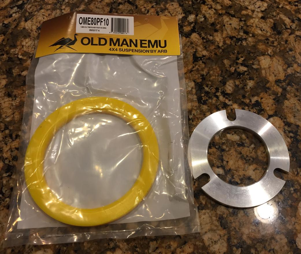

Yota driver-side lean correction:
-Toytec TP14 (1/4”) driver front spacer
-OME 80PF10 (10mm) rear driver spacer

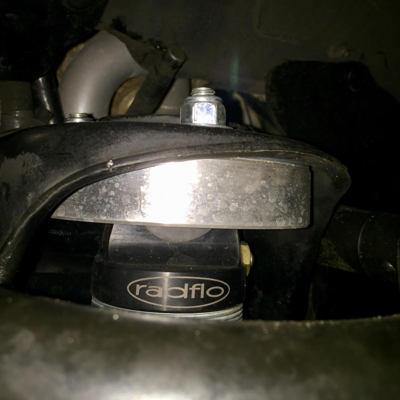

*New SPC LR UCA, Radflo 2.5in/650lb COs, Strongflex bushing in LCAs

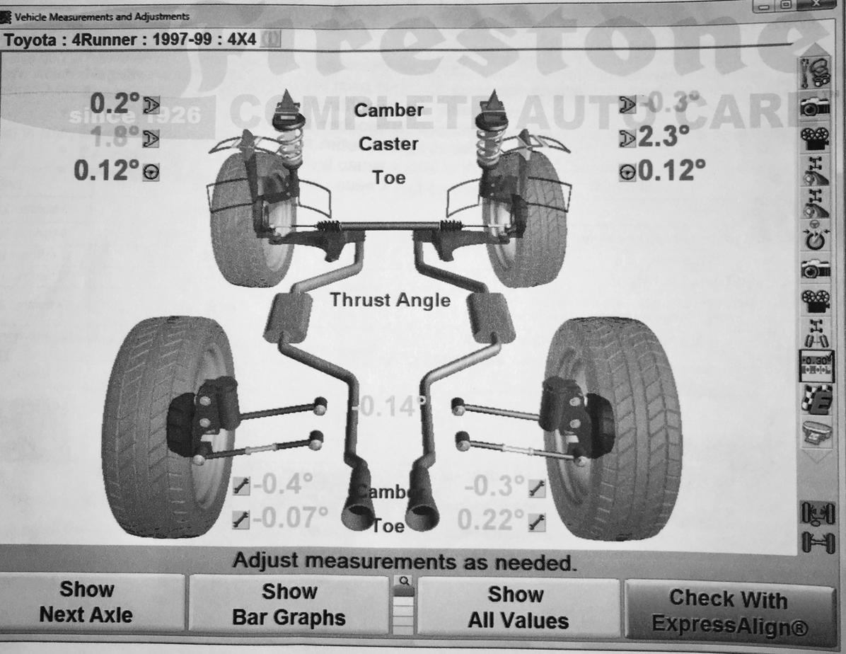

Post Suspension/Steering work alignment
<a href="https://imgur.com/yC5SRcn"><img src="https://i.imgur.com/yC5SRcnb.jpg" title="source: imgur.com" /></a>
*Not perfect but pretty good, caster set in the recommended neutral position
*I now have some wheel well rubbing that is new I need to look into but for now I am enjoying a brand new ride...will put some road miles on it, make sure nothing shifts and then see about some trail trials...
*If anyone has any alignment thoughts I am happy to hear them

New alignment, no more pinch weld rubbbing
Back to Firestone for post SPC LR UCA install alignment for 2nd time. First tech didn’t bother with any of the additional adjustments (caster plates still at “D” and upper camber bolts in the middle where I left them post install). Tech had front cams all the way out, rear cams all the way in.
Today: different tech who was happy for me to help. Fwe started with front cams all the way in, rear all the way out and caster plates on “G” and camber bolts all the way in. Some minor tweaking of the cams and the had to push the tie rods ends out on both sides to finish. He left the caster 0.5 degrees low on the drivers side to compensate for road camber.
Now I have no rubbing, track straight, still returns to center following turns, requires little if any steering adjustment when going straight. Only complaint is a little slop (less responsive) in steering wheel when going straight but not significant and I doubt I would have noticed if it weren’t for my recent education and extra time on the alignment rack.
Have a trail ride planned in a few weeks...will see how it does then.
On a side note it looks like my rear diff isn’t centered but I am not sure if it is worth adjusting the track bar to adjust. Anybody have any thoughts?

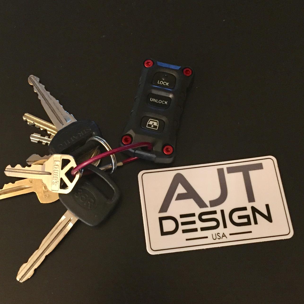

Finally replaced broken Fob...nice upgrade. Thanks to [MENTION=102606]infamousRNR[/MENTION] for the recent post that these were available.

Suspension tweaking, Yota Lean
Trying to get rid of my lean...just picked up trim spacers from Toytec. Front 1/4” spacer was simple...haven’t put rear on yet...wanted to see how much Front only would help.
Hub to Fender Before
Driver Front- 23 24 -Passenger Front
Driver Rear- 24 24 3/4 -Passenger Rear
New measurement raised Driver Front to 23 3/4. Seems like more than expected from a 1/4” top spacer...guessing I miss measured somewhere but at least it is better. Now I need to do the rear and see how I sit....Also noticed my rear axle is not centered...will be readjusting panhard too.
You can just see the spacer in the bottom pic...
