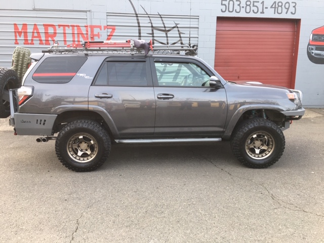

Regear after changing to 315/70/17?
Need to take better pic lol but there u go

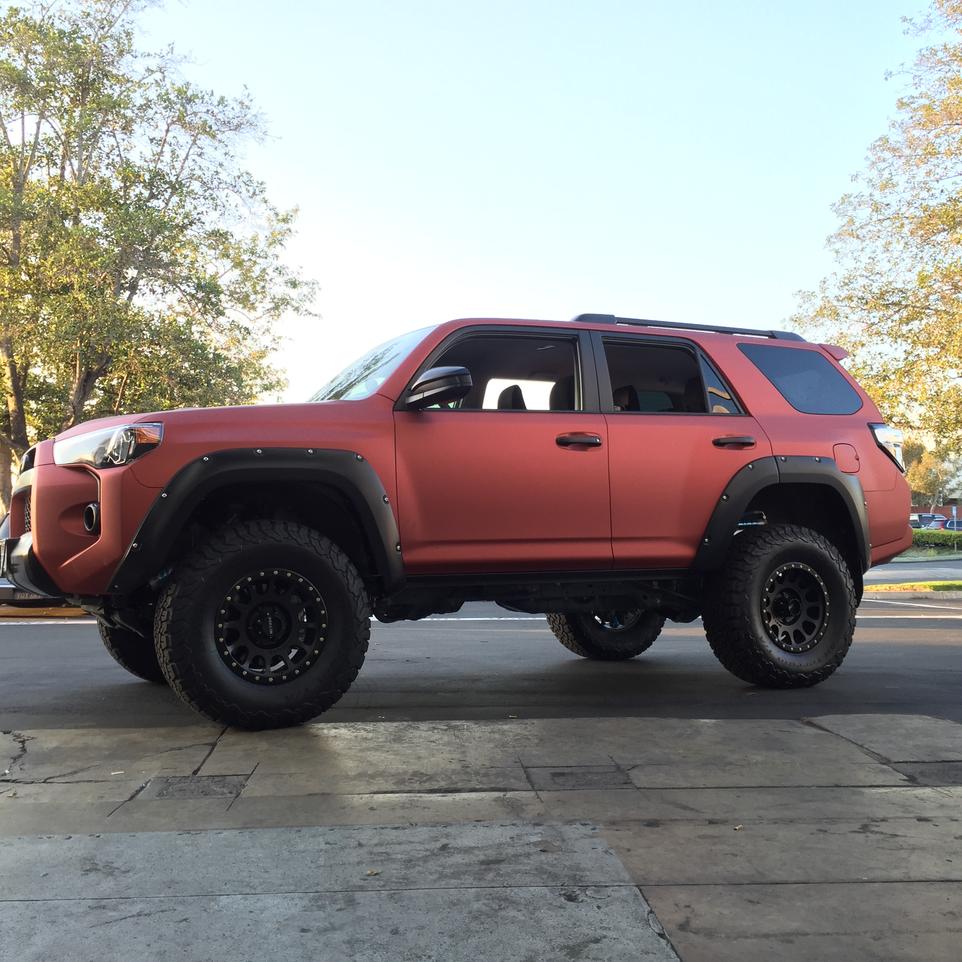

When from stock 31" on the 2016 trail to 315/70/17, do I need to regear?
You don't need to but personally I think it fixed all the shift points. It doesn't hunt around at high speeds anymore, in the mtns it's much improved and off road it has a real low gear now. I feel like it improved control all around.

Off-road is where you will really like the regear. You will have to two foot it pretty hard in the rocks with 35s on stock gears. The 4.88 is where I'd recommend with 35s but I believe my 305 MTR aren't much smaller than yours and 4.56 is perfect. I've been off-road with them once or twice.

Those sure don't look like 315s. Are you sure. they look like 33s to me. Maybe the camera and the flares are playing tricks on my eyes. Do you have a bracket lift or something? Also, go measure, many tires are way off compared to what the advertised numbers on the side say, but I've never seen 315s actuallky measure under 34", but it is possible. If it is a BFG, it could be under 34" and still be labeled a 315.
If they are really 34-35" tires. re-gear will help a bunch. 4.56 is about right. True 35s would be good with 4.88
Their web said 34.4"

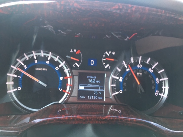

Im running 33" duratracs and I went ahead and jumped straight to 4.88 gears and boy am I glad I did! After driving with 4.88s I dont see any reason to spend the money for 4.56 either go all the way or dont do it.
It shifts so much better, it doesn't feel over geared at all, it feels like it should from the factory. I am getting about 16mpg on the highway and around town which is as good as its always gotten with all the heavy gear and tires on it.

No way you’re at 16 mpg
yep the first 500 miles breaking in the gears I was only getting 14.5mpg but once they broke in I get 16mpg now. You could feel how tight things were the first couple weeks.
I used the recommended LUCAS NON synthetic gear oil for 500 miles then drained it and refilled with the same LUCAS oil
