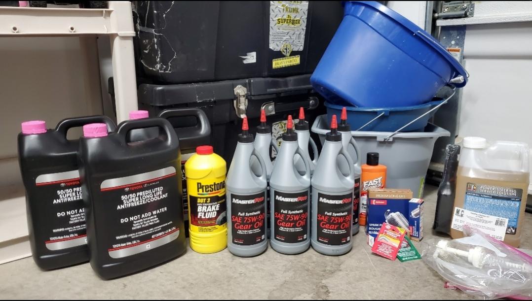

This is how my day was spent. Did a full coolant drain and refill, had my kiddo help me out doing brake fluid and power steering fluid flush (without letting any air in), and did front/rear diffs along with transfer case.
Plan to do intake manifold cleaning tonight followed by spark plugs in the morning. Busy day.

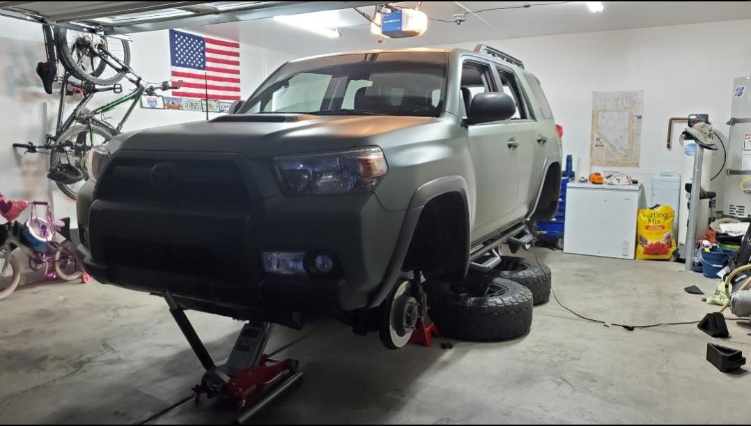

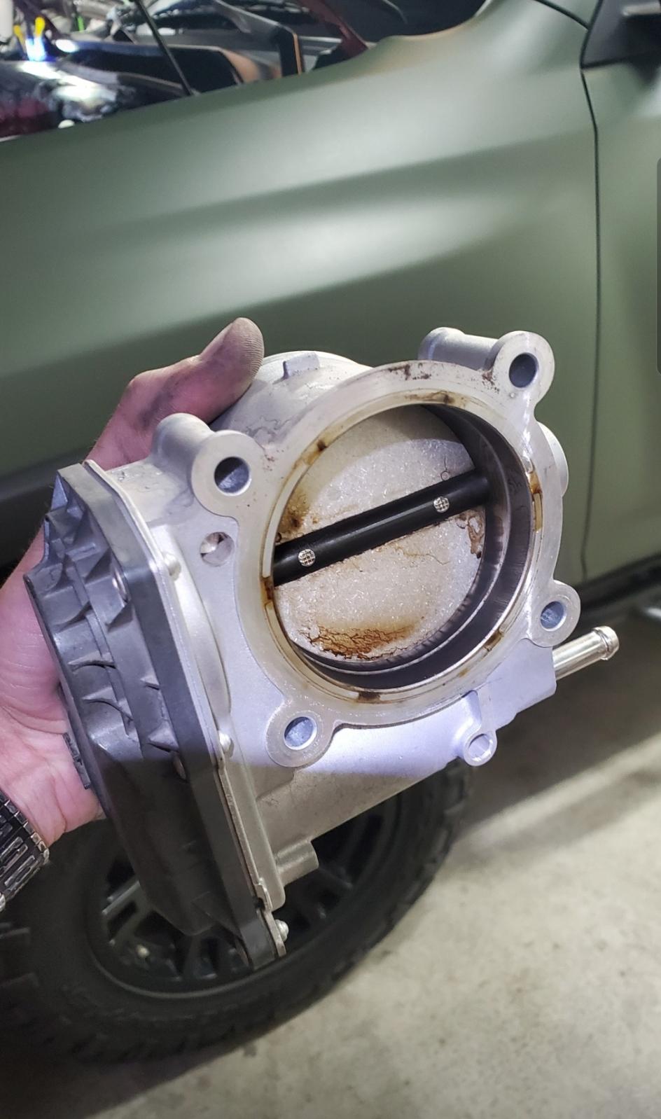

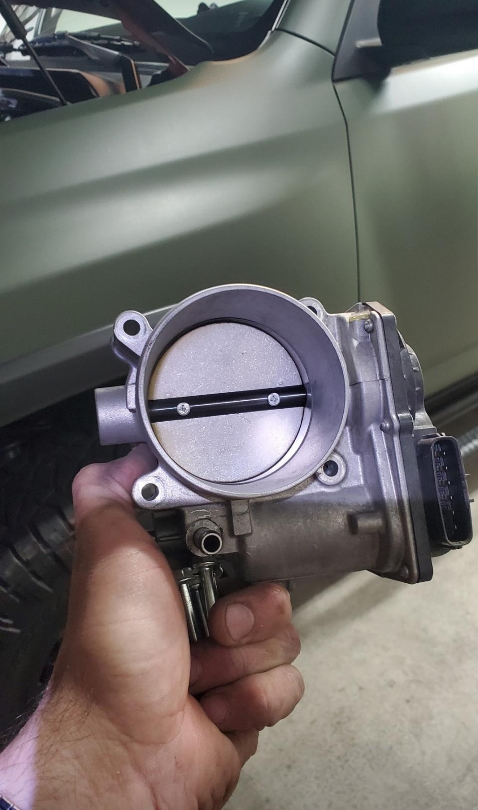

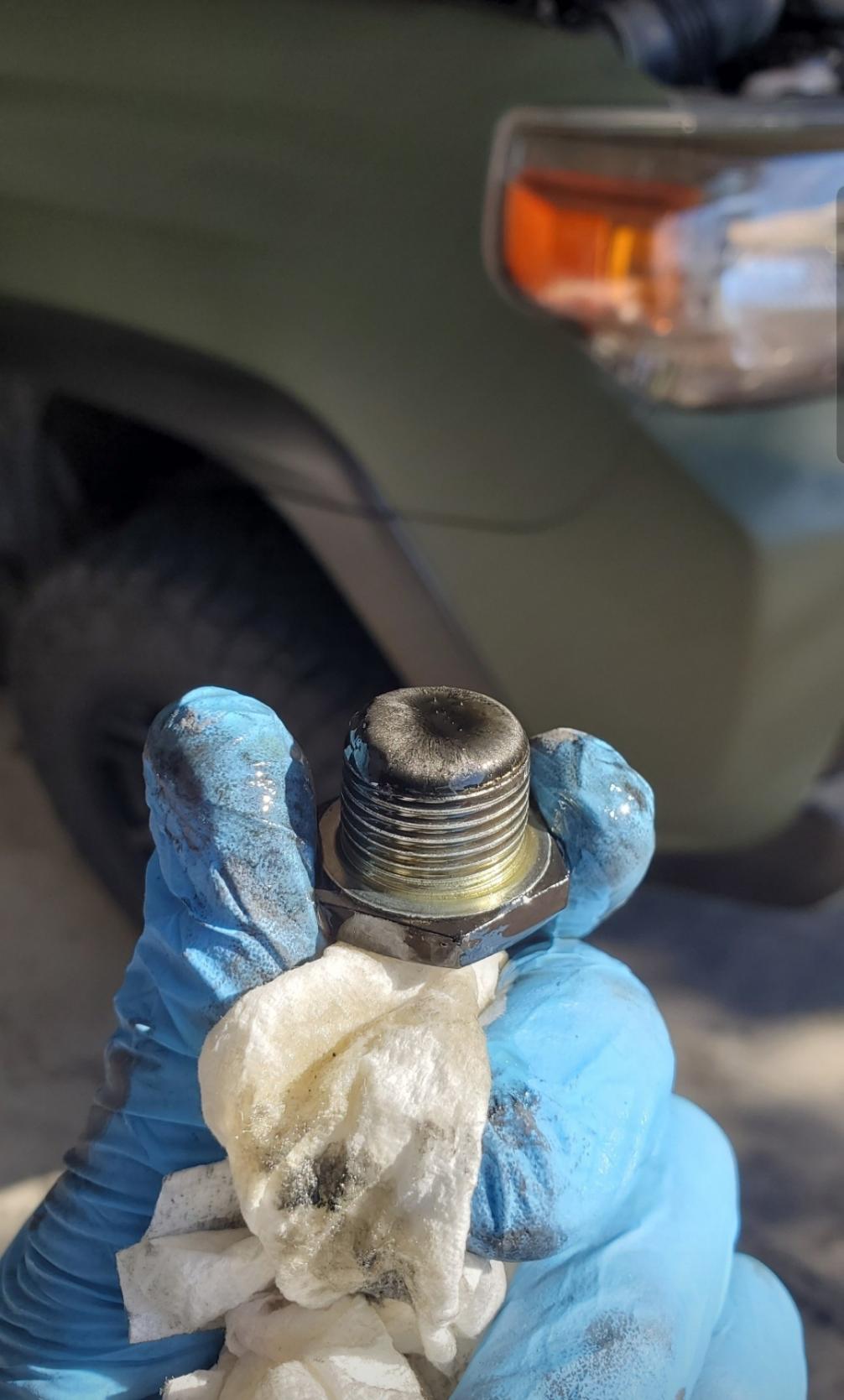

The throttle body was one of the worst I've seen and the sludge on the rear diff plug was significant. Have everything taken apart and ready to the spark plugs first thing in the morning when the block is nice and cool (I drove her around today).
What a day!
Side note: I rotated the tires and aired them up to 52 front and 55 rear. I prefer the stiff ride it gives, and shes mostly doing highway miles for now. We'll see if it starts wearing in the middle. The previous owner had them at 30 and the outsides were beginning to noticeably wear.

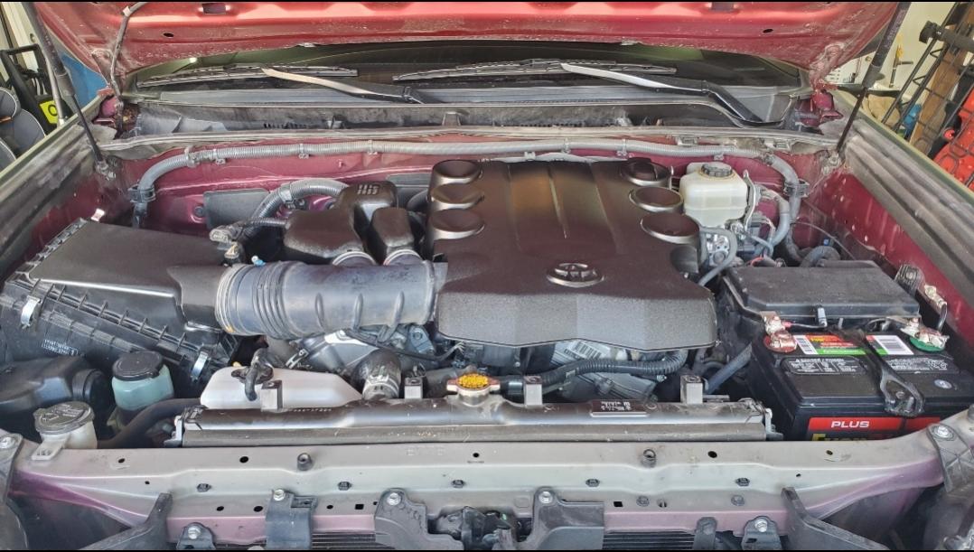

Finished off the tune up with the plugs this morning. Feels good to get all that done! She puuuuurrrrrs quite nice now.
Thinking about letting the dealership do the tranny fluid. Looks like a major PITA to get a 100% fluid swap in the garage.
