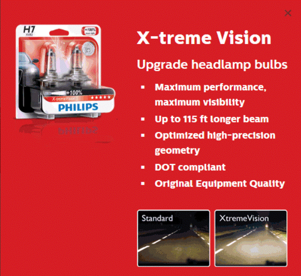

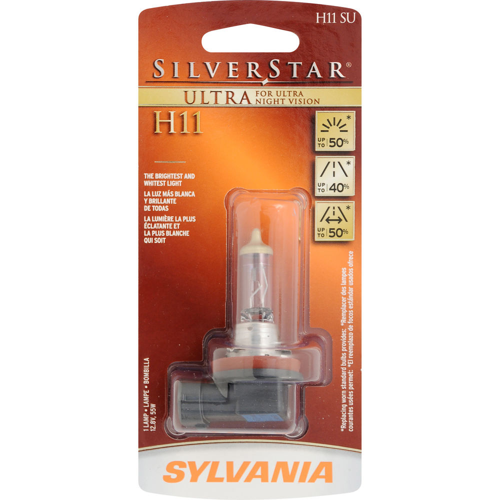

I've had both in different vehicles, remember higher output means shorter life....
Recommend either one of these..... but I switched to HID's anyway.

Agree with Saker. Had these in another vehicle, but went with HID's and haven't looked back.
