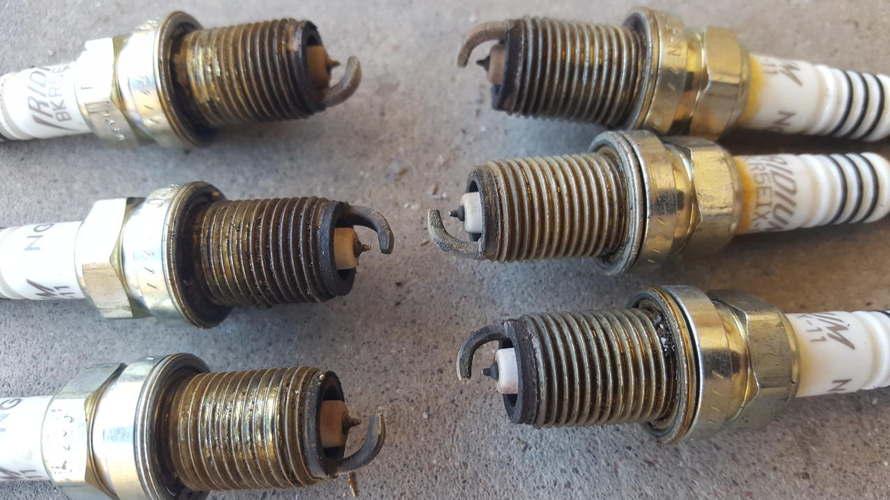

Regular spark plug change on a 02 3rd gen 4wd. How do they look?
salgood
Photo is in order from the front of the vehicle. Is there any concern? Any issues with the corrosion? These plugs have been in for two years give or take a few months.

I forgot to add she has just over 202k miles. Anything that I should look for with the use of this used plugs? Thanks!

They look worn the eff out. Which is normal since (as others have mentioned) those are the wrong plugs. The 3.4L engines have an ignition system that fires twice as much and so it requires a spark plug with twice the doohickies — this way they will not wear out prematurely.

You know, I told them that and they (dudes at AutoZone) said they are thr same, blah blah blah and I installed the same ones. I told them but no, they are the parts people and I am just some schlub, what do I know??. F*** me. That's why my mpg went down last time changed them. Hell, even a 20 year tech that did a 100 pt inspection last year while I had my timimg belt changed did not mention I put the wrong ones in. Dammit!
Thank you and to everyone else that replied.
Eff me! I knew this both times I changed them. I feel like and ass after all the cues that led me to believe my lower mpgs were some else.
I checked wth AutoZome and other... I told them dual but they confirmed I was wrong. Thank you. I Will be fixing this on Saturday.

Since nobody addressed your actual question, the plugs look fine (maybe a tad bit rich), but that is probably because you have the wrong plugs. Do a search online for "Spark plug chart" and see for yourself.

I "think" the only real meaningful difference will be spark plug life. So if that's the case, just replace them a little sooner than you otherwise would have. That way the gap doesn't grow too much since it's doing double duty.
Of course if it bugs you though — just change them. :D
Those iridium plugs should be good for 100K+ miles in a conventional (non-wasted spark) system. So longevity shouldn't be an issue.
